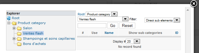

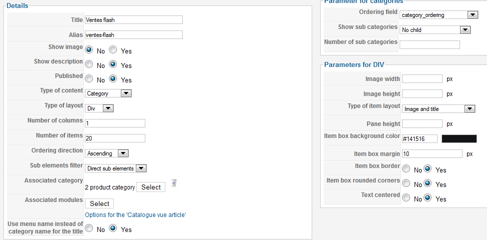

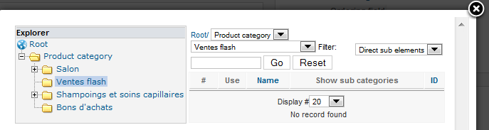

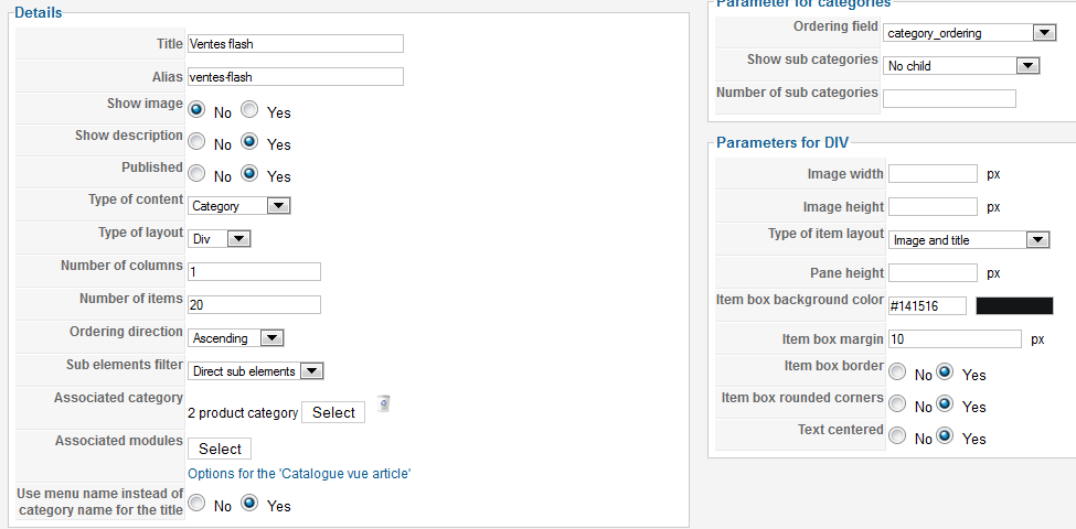

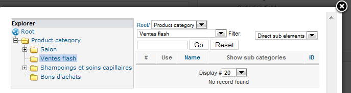

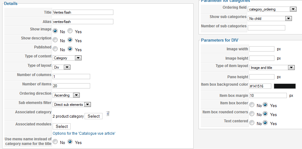

You can see the result on dev.patrickguedj-paris.com/ventes-flash (menu link Ventes flash)
Hikashop menu is set with :
Popup is set with :
but I don't see a save button in the popup and noticed the day after, that the Explorer was set on Root and not on the right category.
Of course I saved my content menu.
What could be wrong ?
Last edit: 14 years 7 months ago by codewarrior.
  • Posts: 86179
  • Thank you received: 14214
14 years 8 months ago #34177
You didn't set the "parent category" option to your category. That's why it's not working.
What you did in your popup is that you displayed the sub categories of your category, and since you don't have any sub category in that category, you don't see anything. In the selection popup, you should click on the root category, select your category and click on the use icon.
