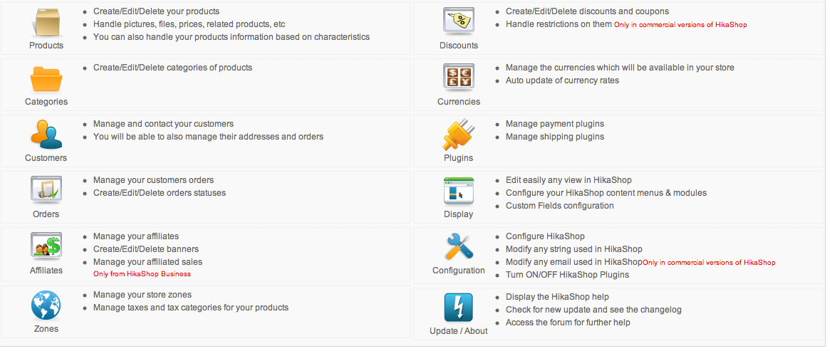

  • Posts: 131
  • Thank you received: 7
15 years 5 months ago #12741
No, I don't see that menu.
Screenshots linked.
  • Posts: 86181
15 years 5 months ago #12743
In the configuration, under the tab display, please change the option "Menu position" to "above the main area". That will display the menu which is not displayed because the title of the pages are missing on your website for an unknown reason.
