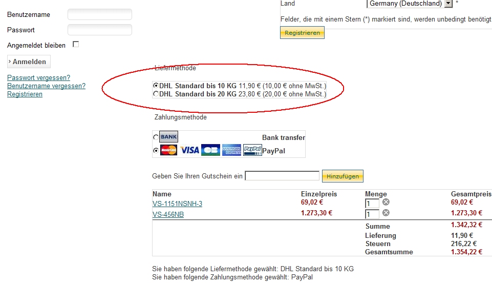

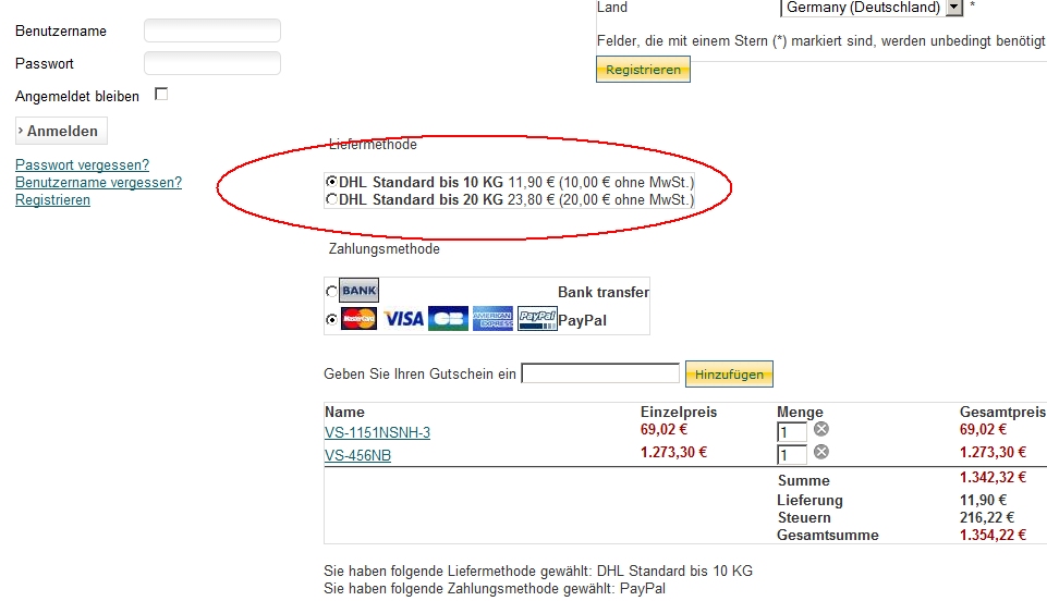

I've defined three different shipping methods. The only differences are the weight ranges and the price. 0,001 - 10,000 KG for 10 EUR, 10,001 - 20,000 for 20 EUR and 20,001 KG and above for 25 EUR.
Unfortunately I do have two options within the checkout for a weight that is approx 18 KG.
Please refer the attached screen shot.
I don't know what to do. I thought that only one shipping method and price will be displayed that match the weight.
Thanks for your support and best regards
Andreas

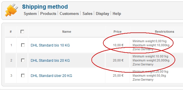

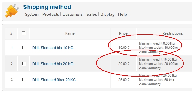

Could you do a screenshot of your listing of manual shipping methods so that we can see how you configured them ?
  • Posts: 26
15 years 5 months ago #12900
Hello Nicolas,
I'm impressed about your support. I've attached the second screen shot with the shipping method.
Andreas
  • Posts: 86181
15 years 5 months ago #12904
I see that you sometimes use a dot and sometimes a comma in your weight restrictions. Could you try to use either a comma for all of them or a dot for all of them ?

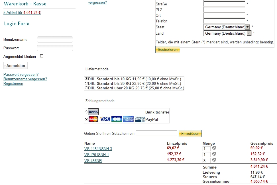

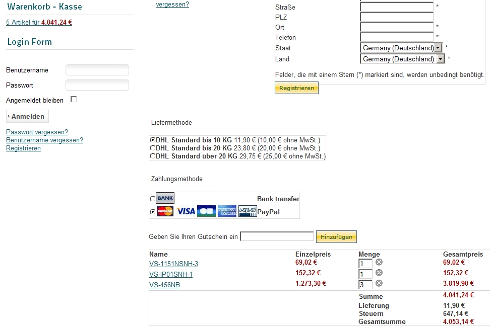

you're right. There was a dot instead a comma. I changed this, all now comma. But it didn't work. I put more products to the cart, so the weight was over 20 KG. Now the cart shows all three shipping options. 0 - 10 KG, 10 - 20 KG and above 20.
The HikaShop is the latest version available 1.4.8, Joomla 1.6.1
Andreas
