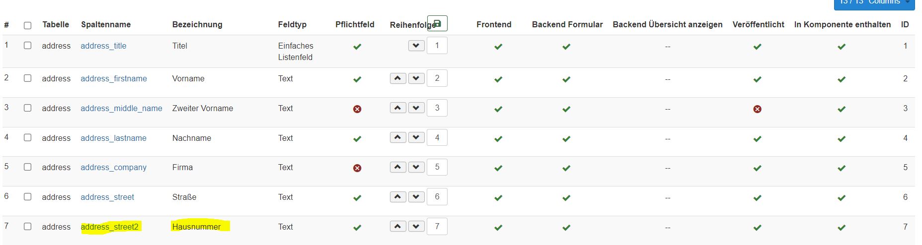

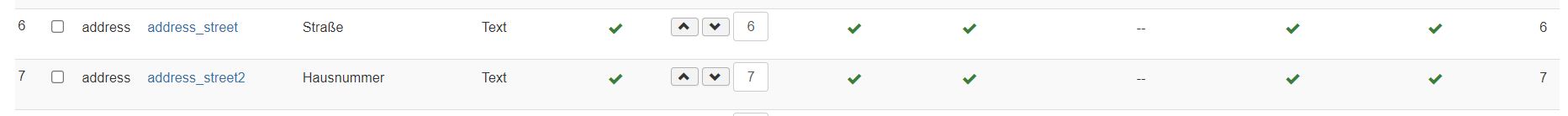

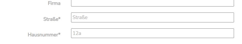

  • Posts: 40
  • Thank you received: 4

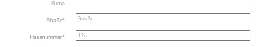

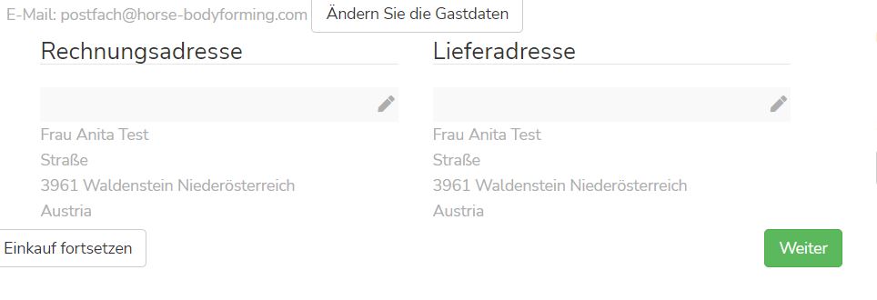

3 years 6 months ago #349510

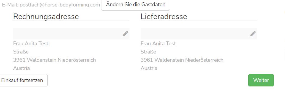

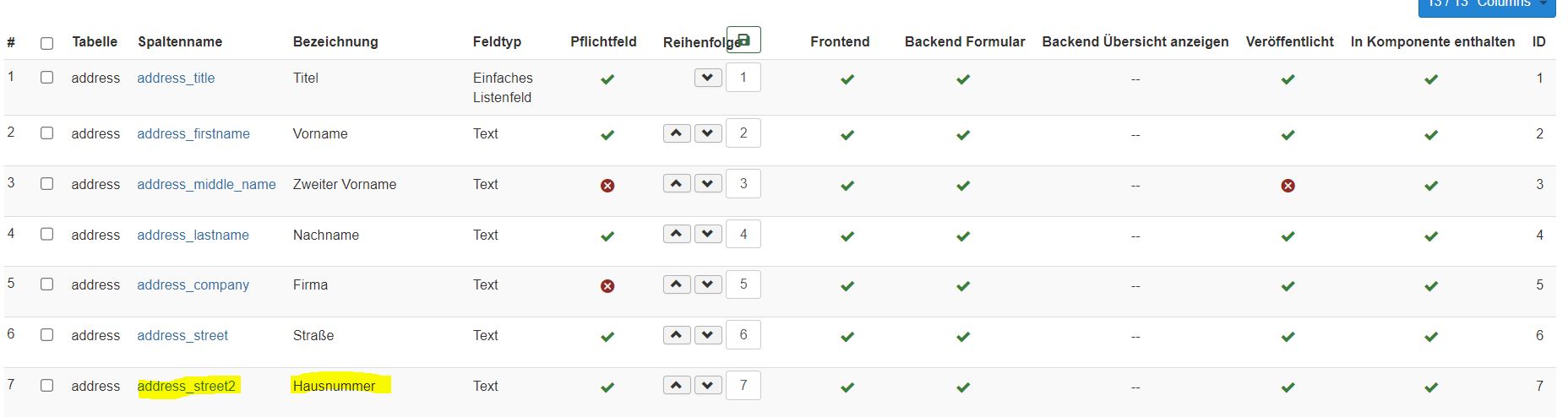

Dear all,
I would like to split address too and have one field adddress for the street and one field for the house number. I took address2 for this purpose. But unfortunately the house number field is not shown during the checkout process. please see images attached. What is missing? Anita
activating address2 field
everything is fine during checkout step 1 now the second field is missing

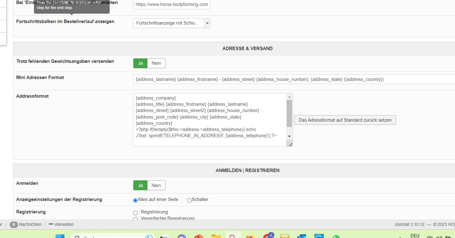

  • Posts: 86101
  • Thank you received: 14203
3 years 6 months ago #349513
You need to add the {address_street2} tag to the "address format" setting of the HikaShop configuration:
www.hikashop.com/support/documentation/5...ml#checkout_shipping
The following user(s) said Thank You: Agabl123

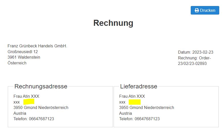

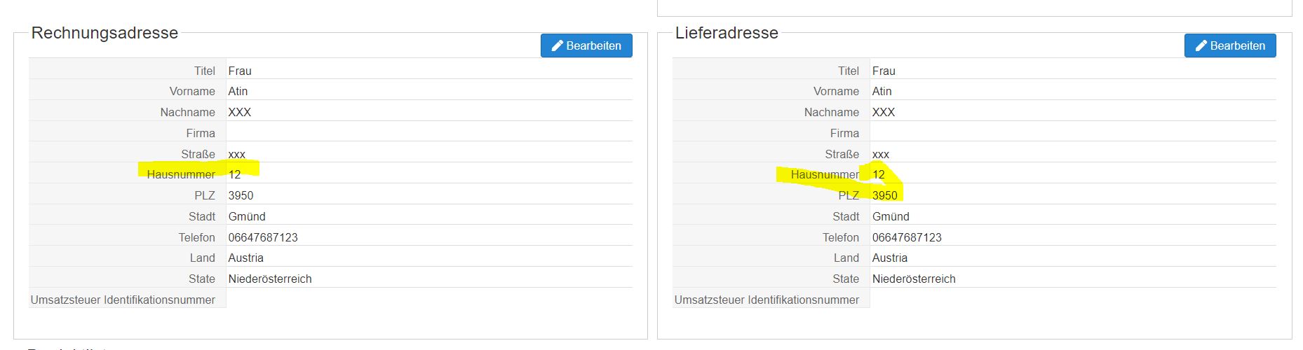

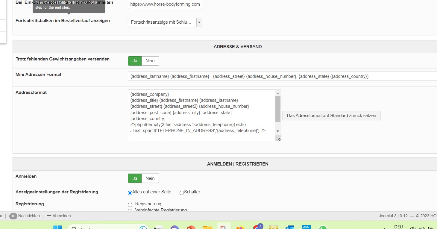

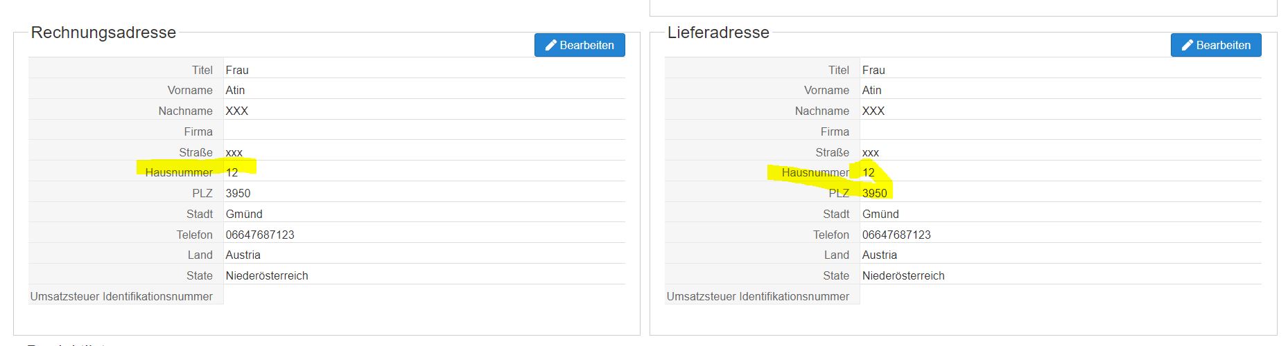

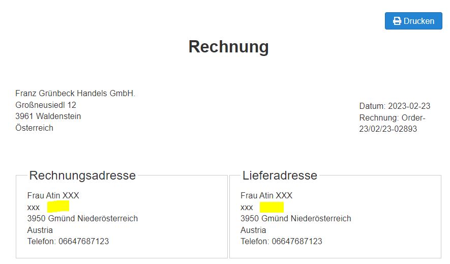

  • Posts: 40
3 years 6 months ago #349534
Thank you Nicolas, that works now. In the order address and house number are ok - see order in the back end
But when I look at the invoice the house number is missing. there must be another place where I have to put in house number. thanks a lot in advance Anita

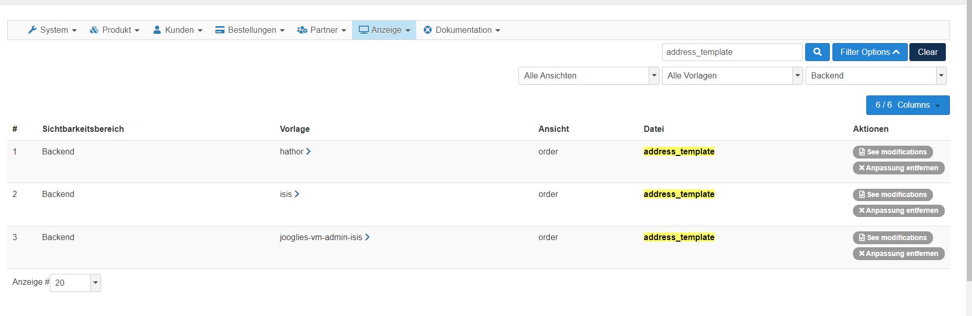

  • Posts: 86101
3 years 6 months ago #349537
The invoice also uses the "address format" setting.
So you should be fine.

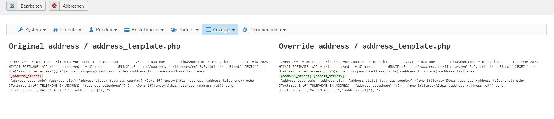

If that doesn't work only for the invoice, it means that the system wasn't able to add the view override for the address_template for your backend template.
So go in the menu Display>Views of HikaShop and search for address_template for your backend template. Then, edit the view and make sure you have the tag in it and save.

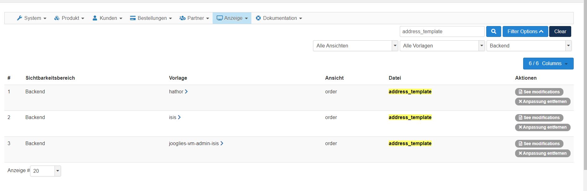

  • Posts: 40
3 years 6 months ago #349590
Hi Nicolas, now I changed in all backend views the address - but it still doesn't work :( Anita

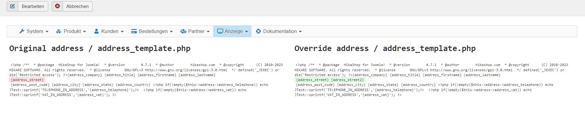

  • Posts: 86101
3 years 6 months ago #349591
Can you provide a screenshot of the view override ?
  • Posts: 40
3 years 6 months ago #349593
here the screenshot
  • Posts: 86101
3 years 6 months ago #349595
You've written adress with one d instead of address with 2 d.
  • Posts: 40
3 years 6 months ago #349603
oh my goodness ... you are totally right.....

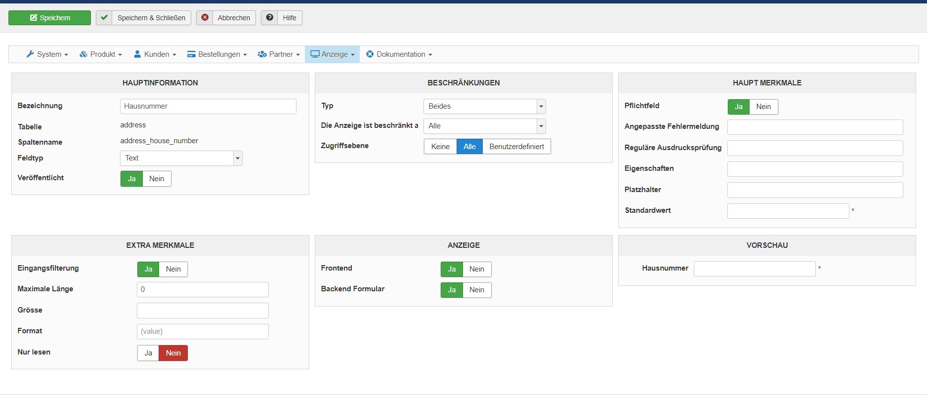

  • Posts: 40

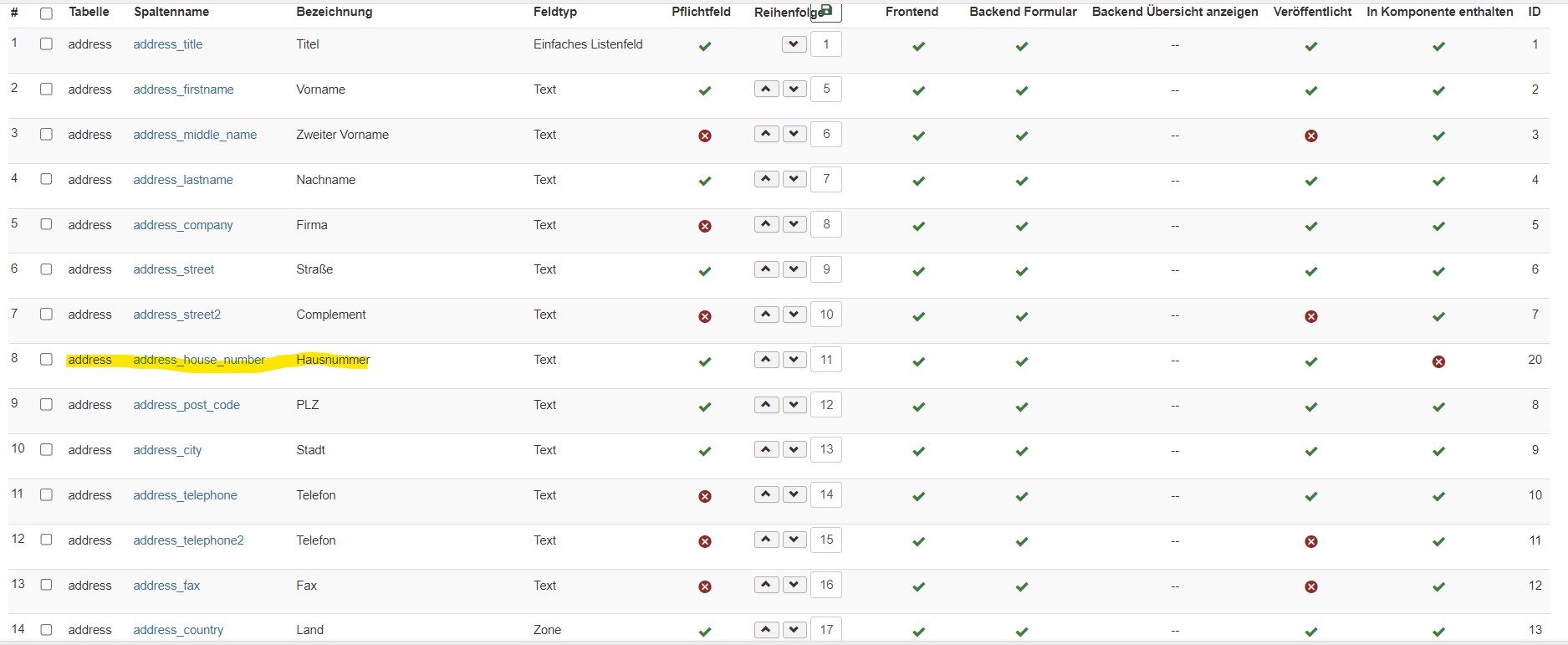

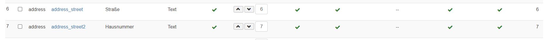

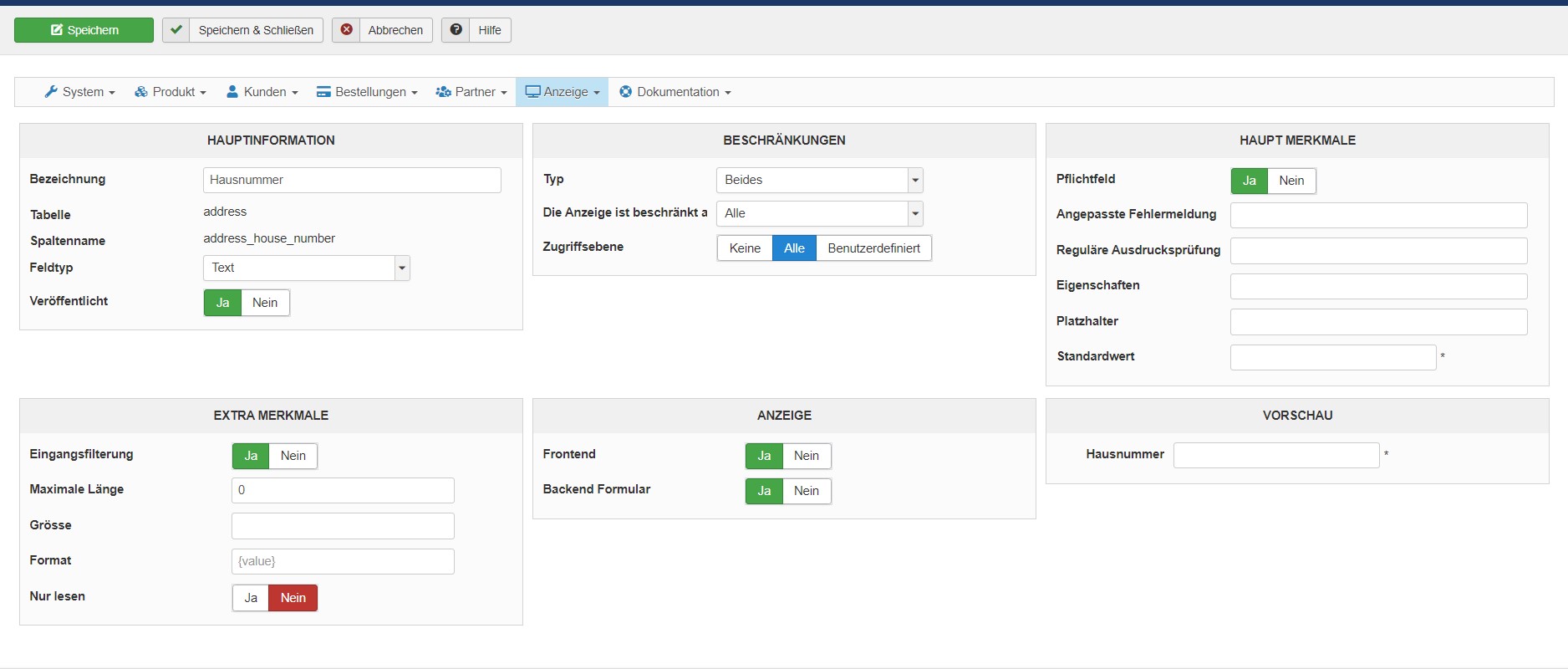

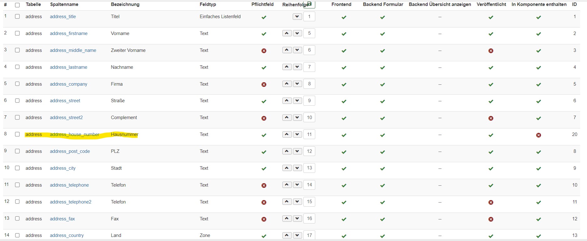

3 years 1 month ago #353917
What must be done so that my new field address_house_number ist within the report "order to ship"
Unfortunately it is missing there
3 years 1 month ago #353924
Can you provide your (or yours) relative custom field settings screenshot (Display dropdown => Custom fields).
AND your Address & Shipping part (from your HikaShop Configuration => Checkout tab)
Awaiting your elements
Last edit: 3 years 1 month ago by Philip.
  • Posts: 40
3 years 1 month ago #353938
Thank you - attached please find the screenshots
  • Posts: 86101
3 years 1 month ago #353958
The custom field should appear automatically in the exported CSV. I do get it automatically on my end when I use the export button of the ready to ship report after having placed orders with that address field filled.
Can you double check ?

  • Posts: 86101
3 years 1 month ago #354068
I think that's because you have many orders without the custom field filled in. I've changed your report to only show the orders redy to ship from the past month. They all have the house number field filled in and the export does have the column for it.
So edit the ready to ship orders with the house number field empty and fill it properly and then try again and it should work.
