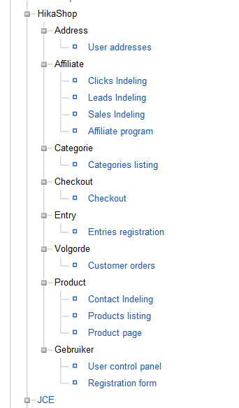

Could you do a screenshot of all the types of menus you have for HikaShop ?
  • Posts: 13
15 years 5 months ago #12915
Screenshot of available hikashop menus
  • Posts: 86181
15 years 5 months ago #12916
Use the "volgorde customer orders" type.
