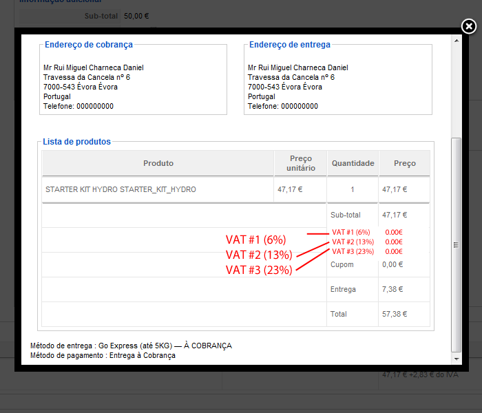

Look, I'm kinda lost to try put this working as well...
I understood the idea, but I don't know exactly which file should I change... On the Display > Views I saw already 2 files for ORDER, but I don't know how to do it...
So, what I want, if you could do it for me, just to tell me exactly where I have to replace your code.
Take a look on the picture:
I just need this for the Order on back-end (for some legal reasons we have to divide the VAT taxes)
Thank You :)

  • Posts: 86180
15 years 1 month ago #23171
I explained which file to change in my message:
You will have to edit the file invoice of the view order via the menu Display->Views
You should have more than two files for the view "order", but you should have only one "invoice" file for your back end template.
We can do the modification for you for a small fee. If you're interested, you can use our contact form to request a quote.
