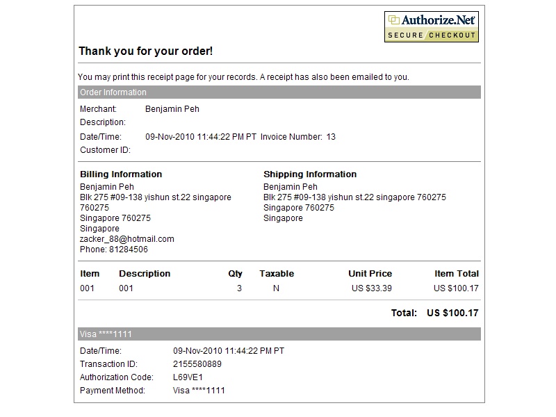

Hi, at the end of payment i was stuck at the thank you page from authorize.net page.
How do i return to my webpage?

Hey thank, i found the option to allow notification from authorize.net.
But now i got this page
An error occurred while trying to report this transaction to the merchant. An e-mail has been sent to the merchant informing them of the error. The following is the result of the attempt to charge your credit card.
This transaction has been approved.
It is advisable for you to contact the merchant to verify that you will receive the product or service.
Is is because i am trying that in a localhost? will the problem solve once i host it on a domain?
