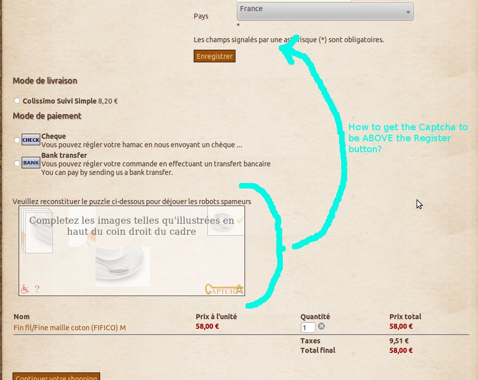

I've got problems getting keyCaptcha working with Hikashop. This is the message sent as a ticket to the keyCaptcha team.
Hello and many thanks for this BEAUTIFUL little tool!
Background :
J1.6.1, Hikashop 1.4.8, Template : Braincode-Grunge,...
Keycaptcha works well for normal Joomla registration as well with yvComments but is problematic (for me) with Hikashop.
Login and Registration work well within Hikashop WITHOUT keyCaptcha
Two things :
1. If the plugin is enabled, keyCaptcha appears at the bottom of the registration/checkout page BELOW shipping and payment -- thus well below the login and/or register buttons. It does work as long as nothing is entered in the shipping and payment zones in-between before clicking on the login or register buttons ABOVE. This is not really user-friendly. I know this has to do with page layout (and thus not a direct keyCaptcha issue) but for the sake of me, I don't know which files to modify to move the keyCaptcha ABOVE the register and login buttons.
[I'd like to understand how keyCaptcha is called in view of modifying page layouts elsewhere]
2. When logout button is pressed during the checkout procedure it gives a "This page is not redirecting properly" in FF and a 404 "Category not found" in Chrome. [which does not occur without keyCaptcha]
I've got the same issues on my local site AND my remote test site .
I noticed the various options available in the plugin but none for Hikashop.
Any guidance appreciated.
If any help can come from this side...
Stephan

Concerning the position of the keycaptcha plugin on the checkout page, it is something handled by keycaptcha so they should be able to help you. One workaround might be to change your checkout workflow option in the config of hikashop so that you get the registration view on its own step, without shipping/payment selection.
For your second problem, You should put a URL in the option "URL where to redirect when the cart is empty" of the tab checkout of the config.
