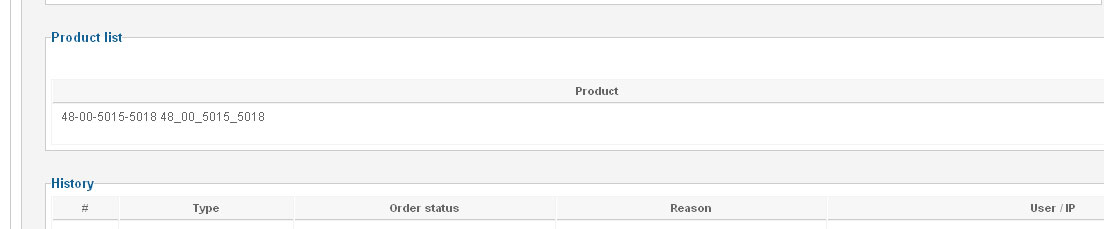

  • Posts: 202
15 years 5 months ago #14260
I made the change to Views->Back End->Order->Forms as indicated. However, there is no hyperlink. See image.
  • Posts: 86181
15 years 5 months ago #14261
Could you check that you made your change for the good template ?
  • Posts: 202
15 years 5 months ago #14262
Ahh, that was it. I changed the correct file, but did it under my front end template instead of the admin template. Thanks!!
