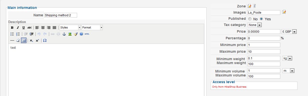

I have no idea what I am doing wrong so really need some help! PLEASE PLEASE help I have no idea what to do!
I have set-up a shop with over 400 products and have just realised there was never an option in the checkout menu for shipping. I have enabled the manual shipping plug-in with the settings shown in the attached picture.
When I go through and try to purchase something, it lets me select an alternate shipping address but then the next page, which Is supposed to allow me to select a shipping method shows this note, "The total of your order is too low for all the possible shipping methods". I have checked that my product has a specified weight of 0.2kg and as you can see the shipping method should allow that, so why do I get this message!??
Please help
Thank you so much
Nicky
  • Posts: 86181
15 years 5 months ago #14099
That shipping method will only be displayed if the total amount of the order is between £1 and £10. I suppose that the price of your product is bigger than that...
  • Posts: 3
15 years 5 months ago #14100
Ok, so i changed that to £1000 which is well above the product cost (£37) and now i get "The cart items combined volume is too big for all the possible shipping methods"
  • Posts: 3
15 years 5 months ago #14101
HAZZAH found the problem, sorry for being so noobish, many thnks!
