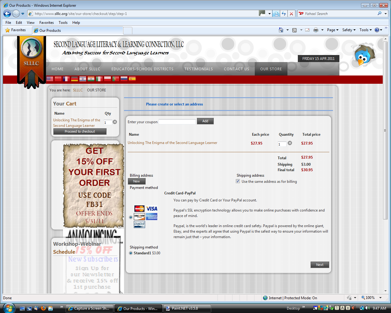

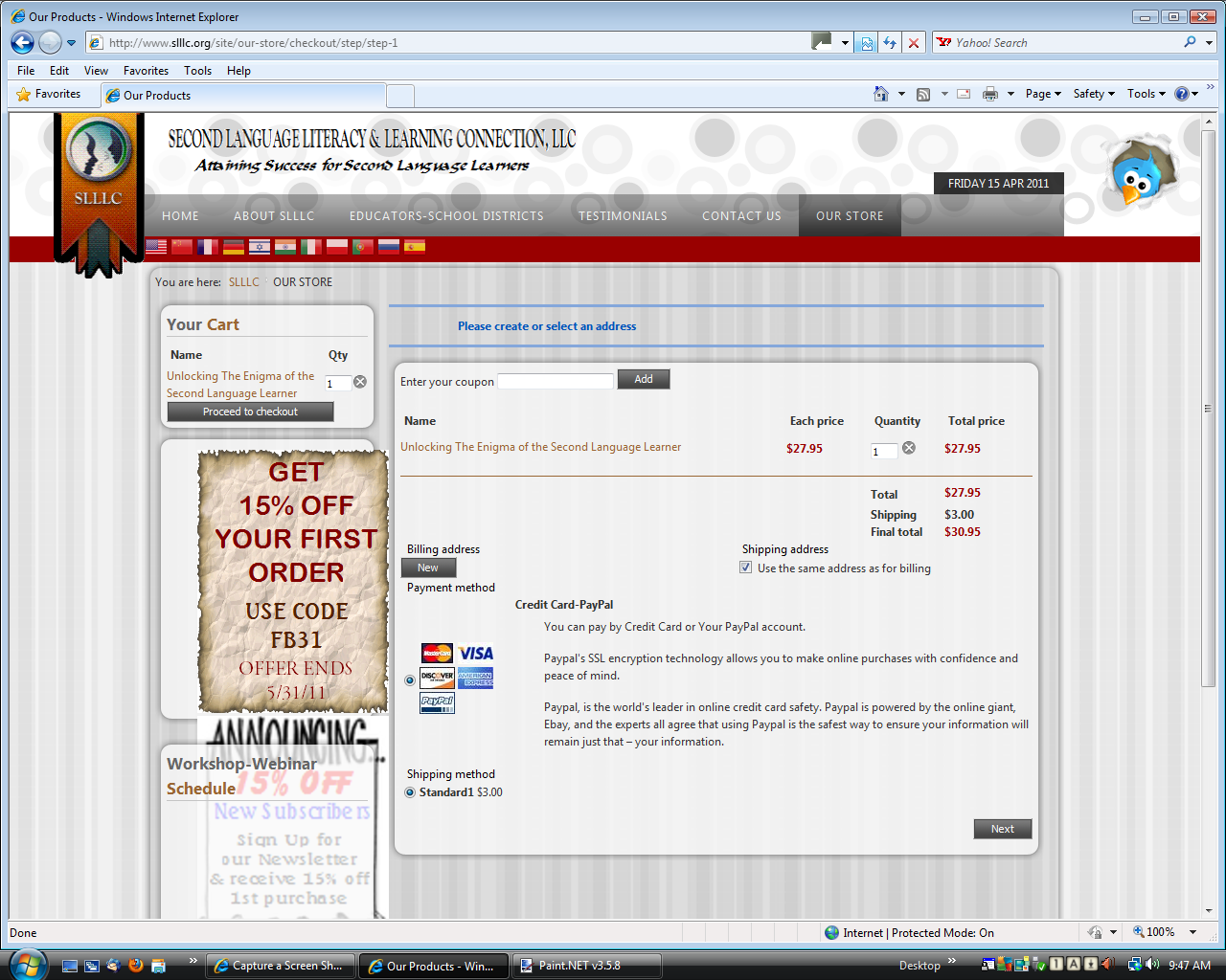

15 years 5 months ago #14333
I still am unable to get past the last step to get redirected to paypal (front end)
see attached screen shot. using IE8

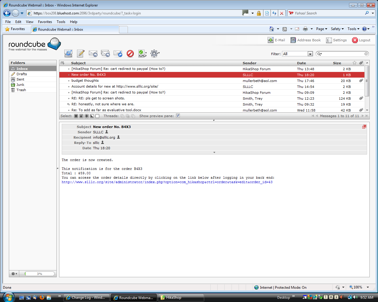

Also, on the order notification email it does not contain the full order summary, as indicated is a new feature in release 1.4.9 maybe it is related.
see attachment, of the order you placed
  • Posts: 86181
15 years 5 months ago #14337
Well, the error message tells you to create or select an address. And I can see that you don't have any address on your screenshot. You need to click on the new button to create an address and it will let you finish the order.

p.s. in this release 1.4.9 it is stated that the order admin notification email and the order status update email now contain the full order summary.
attached is the order notification email received after I made changes and I do not see the full order summary.
  • Posts: 86181
15 years 5 months ago #14411

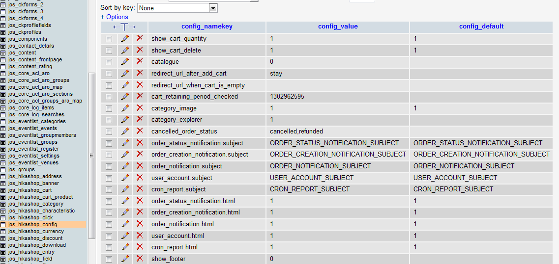

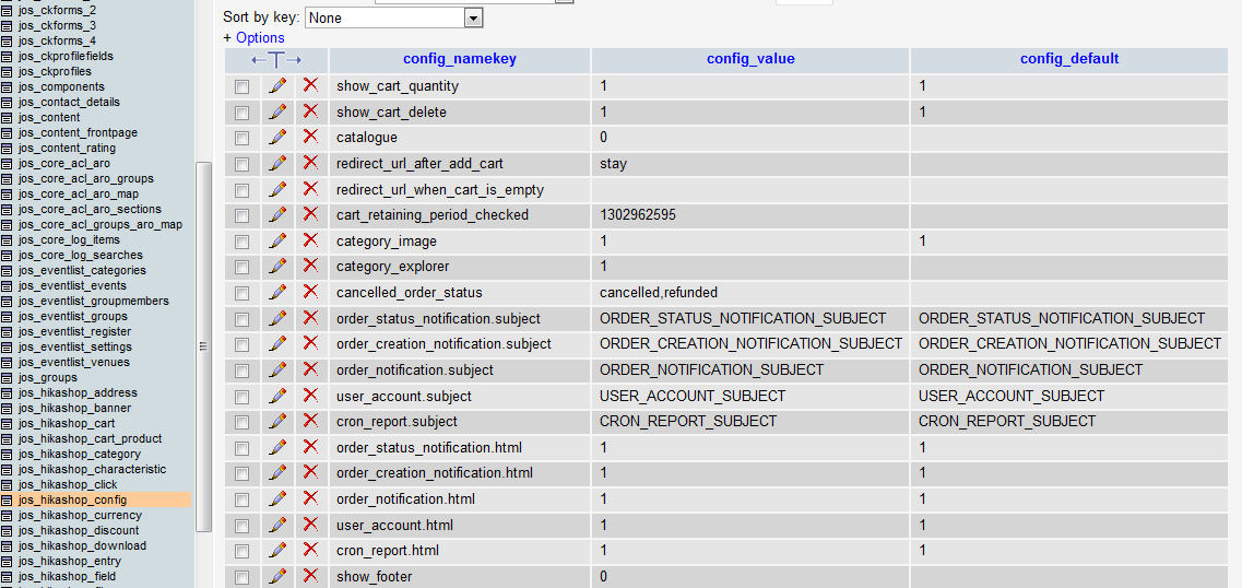

If you updated from a previous version, the email HTML option is set to "no" in the database so even after the update, it keeps sending the text version. You will have to go in the database in the table hikashop_config and change the value of the entry "order_status_notification.html" to 1 instead of 0 so that the HTML version is used over the text version.

I went into my database and the value is set to 1
  • Posts: 86181
15 years 5 months ago #14425
After a closer look, I see that you're talking about the administrator notification email and not the order status modification notification. For that email you should check the entry called "order_admin_notification.html" and set it to 1.
  • Posts: 48
15 years 5 months ago #14426
ok, that is now working
