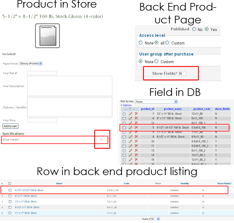

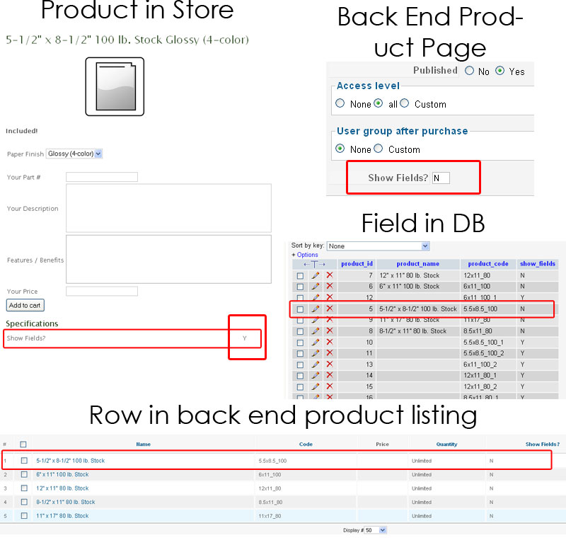

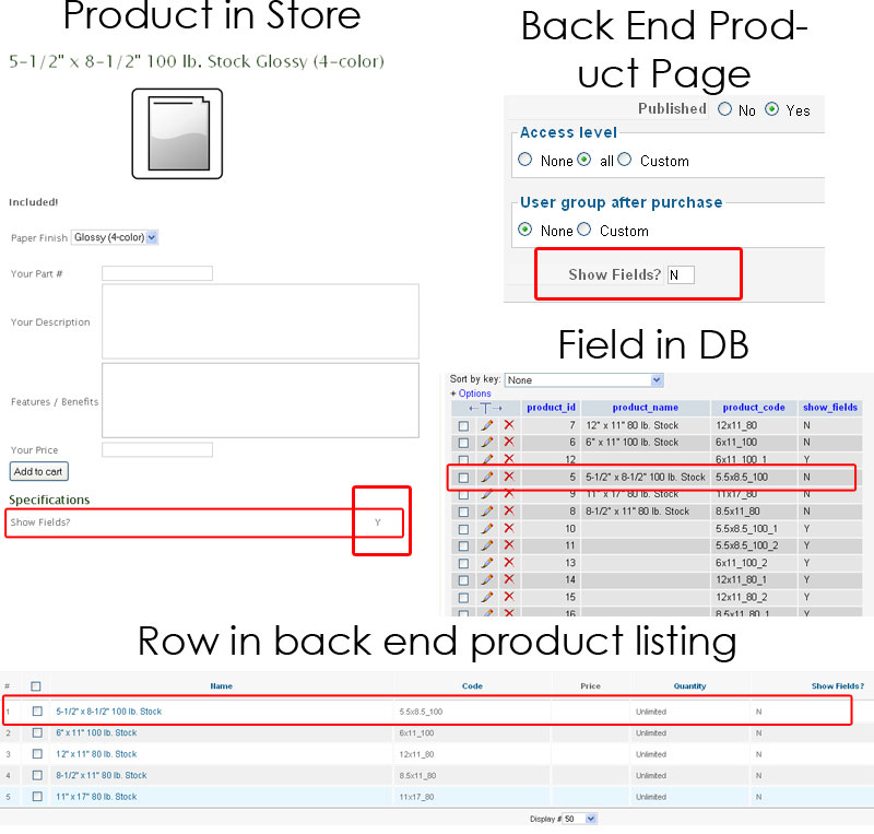

The fields are showing on every product on the front end, regardless of the setting in the "show_fields" column. The weird thing is that, on the front end product page, the value of the field "show_fields" on EVERY product is displaying as a "Y". I know this should crazy, but I am attaching an image to show what I am seeing. I am confused!!
  • Posts: 86100
  • Thank you received: 14202
15 years 4 months ago #14524
I've just done the same on our demo website and it works properly: www.demo.hikashop.com/index.php?option=c...ry_pathway=0&lang=en
It must be something else. What is the configuration of your custom field ? Could you do a full screenshot of your product edition page ?

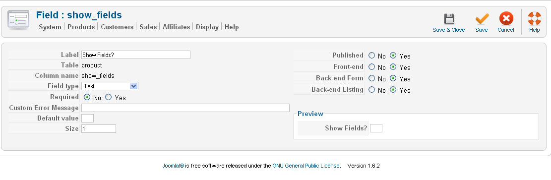

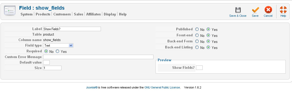

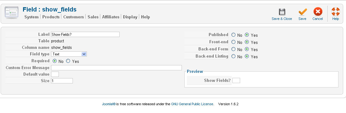

Here is a shot of the custom field config...
