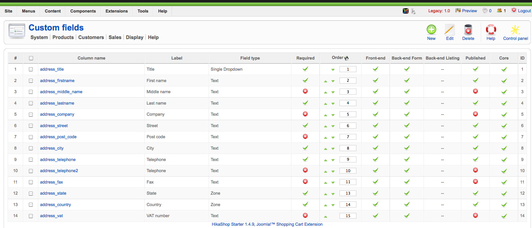

It means that you unpbulish all the address custom fields via the menu Display->Custom fields. Is that the case ?
If you unpublish all the custom fields of the address, then, hikashop will do what you told him to do and not display anything in that popup.

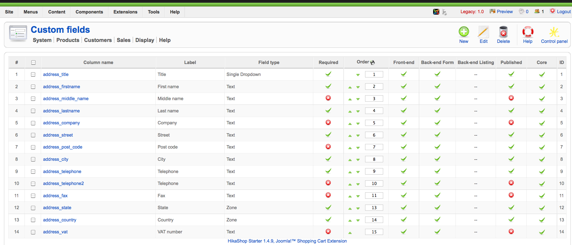

Thank you for the quick response. All of the great reviews that I have read of your support seem true -- it is a big reason why I gave this product a chance and why I will upgrade if I see that it is a fit for me.
However, I have not changed the default settings of the custom fields. I have attached a png of the back end.
Please advise.

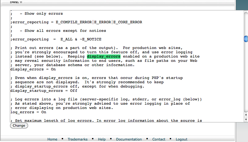

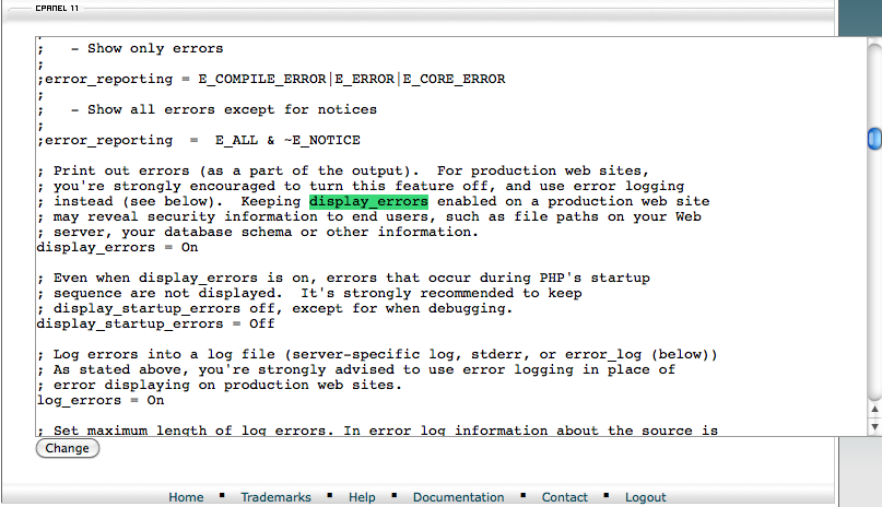

Then, if you're getting a blank page, it's probably because of a fatal error. Could you please make sure that your PHP configuration enables you to see errors and if not, edit your php.ini file and search for the string parameter display_errors.
This parameter should be turned On : display_errors = On.
If it's not the case, please edit your php.ini file, modify this line, save your file and try again.
You should now see the error message instead of a completely blank popup.
If you don't know how to modify your php.ini you should ask your hosting company as the method varies from one to another.
  • Posts: 35
15 years 4 months ago #14631
I have checked the php.ini and the display_errors is 'on'

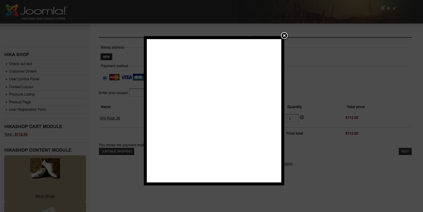

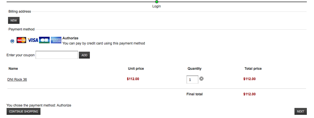

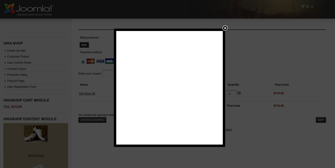

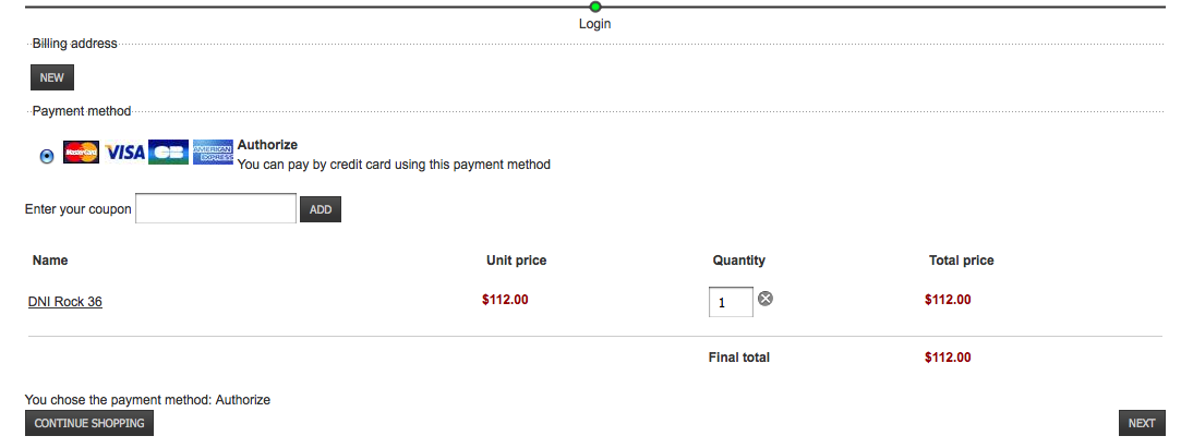

Ok. Could you do a screenshot of the page when you have the popup open ?
  • Posts: 35
15 years 4 months ago #14651
Here are two screenshots.
1) The 'new' button to create a billing address
2) The blank pop up that appears when I click the button.

  • Posts: 86099
  • Thank you received: 14200
15 years 4 months ago #14661
Would it be possible to get a backend access to your website so that we can check out the problem ?

15 years 4 months ago #14698
It seems to be the plugin system module anywhere which crash the popup.
If you unpublish that plugin, the popup displays fine.
