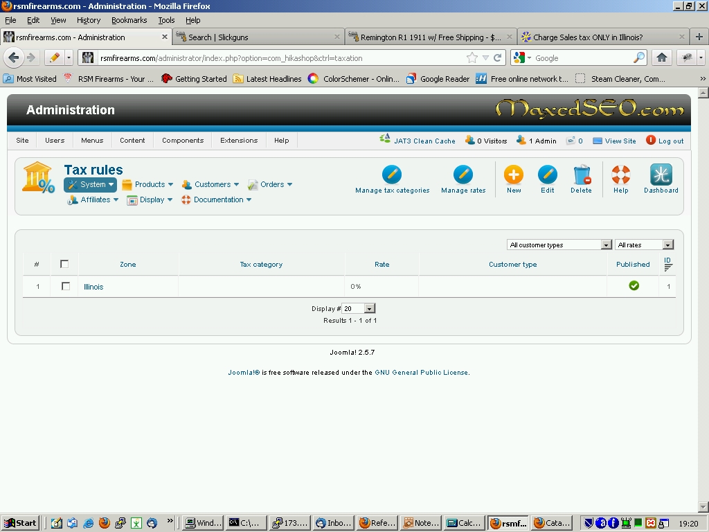

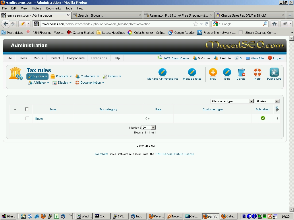

Thank you and just getting back to this now...as Taxes is not working during a checkout and I am in Illinois
1) I have System > Taxes > [Tax Rules]
index.php?option=com_hikashop&ctrl=taxation
Zone = Illinois
Does not Show Tax Category ??
Does not show Rate?

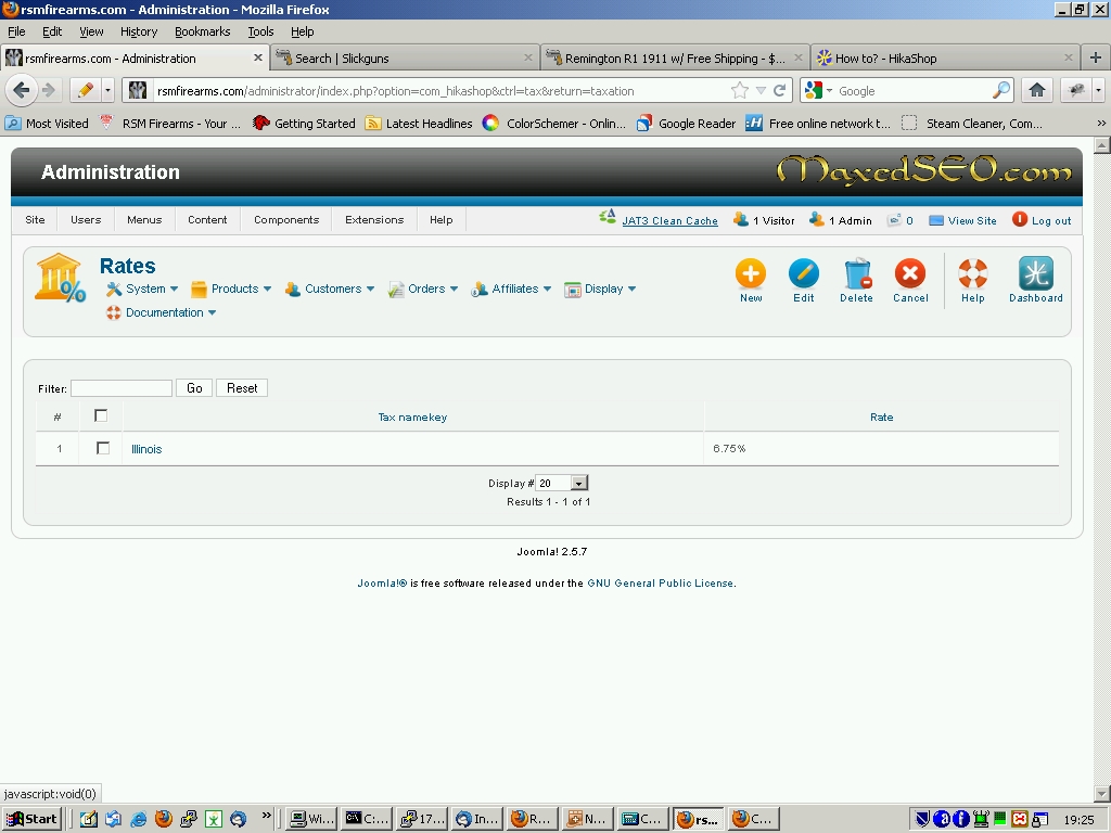

2) Manage Rates = Illinois & shows 6.75 as I need
index.php?option=com_hikashop&ctrl=tax&return=taxation

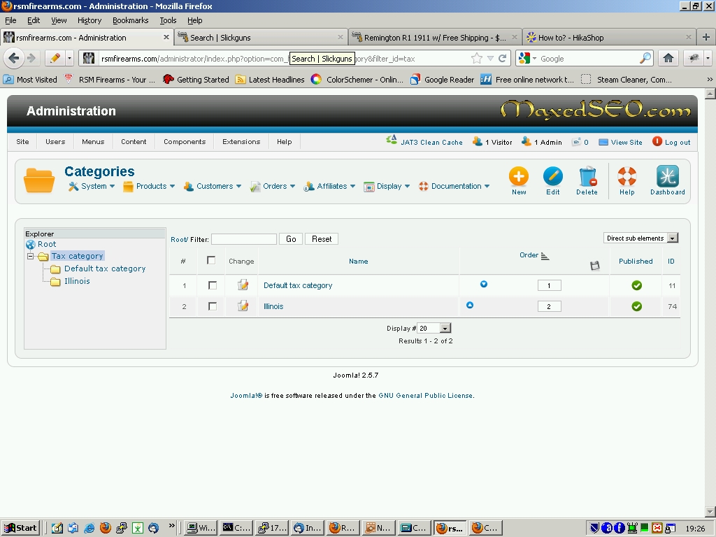

3) Tax category I have Default Tax Category & Illinois
index.php?option=com_hikashop&ctrl=category&filter_id=tax
In Product I have Illinois for Tax etc.. But when I check out? Before Credit Card it does not show price with tax.

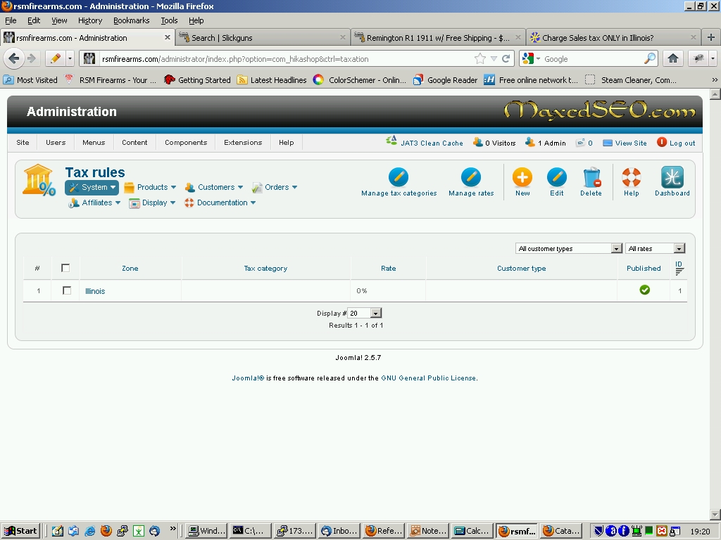

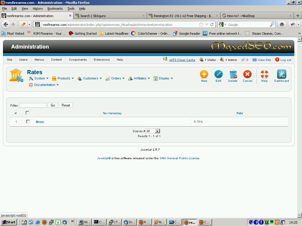

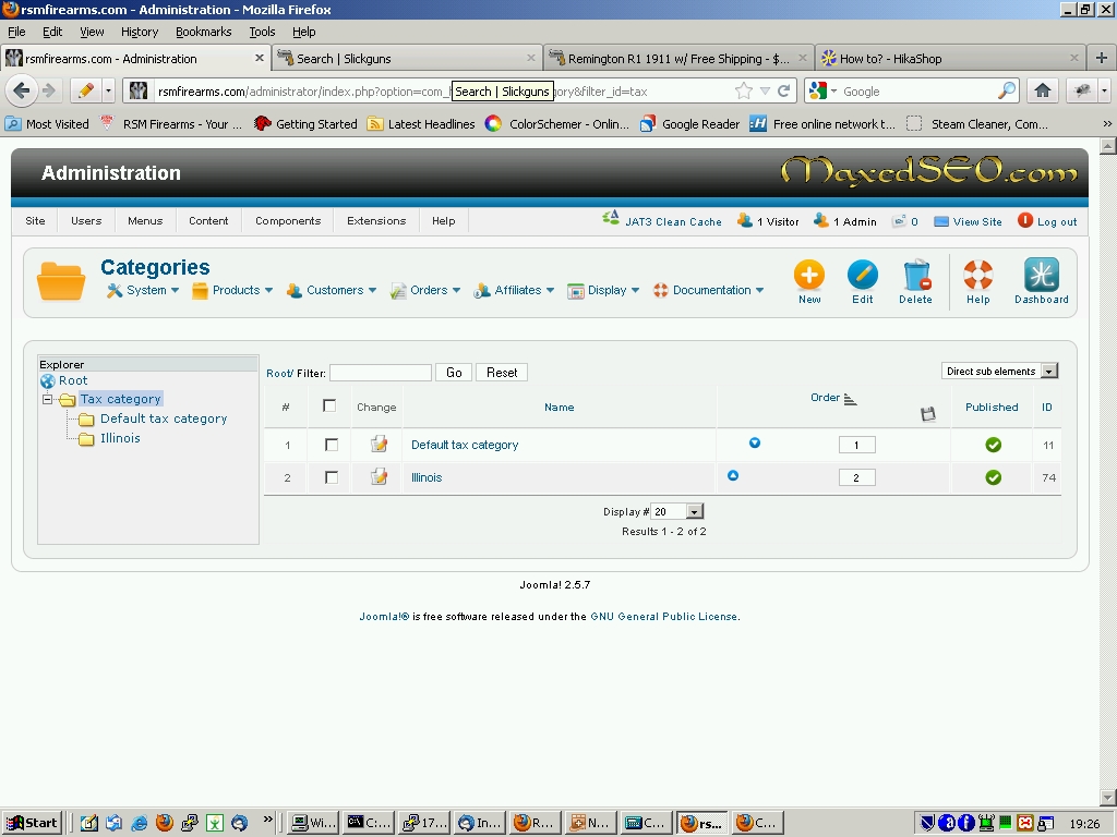

  • Posts: 135
  • Thank you received: 5
13 years 10 months ago #73222
Here are the rules, rates and Categories screenshots.. Please help

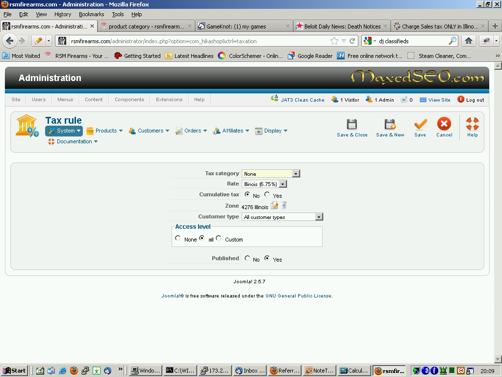

  • Posts: 86114
  • Thank you received: 14210
13 years 10 months ago #73223
Edit your tax rule and select the Ilinois tax category and the Ilinois tax rate and save and that should make it work.

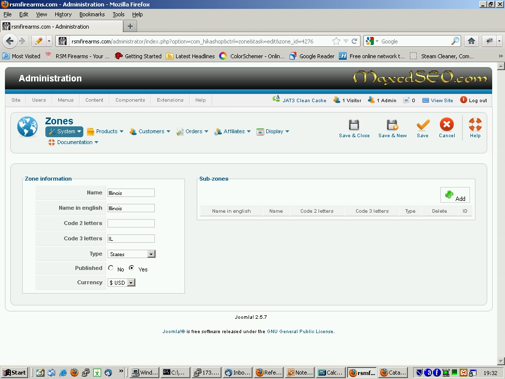

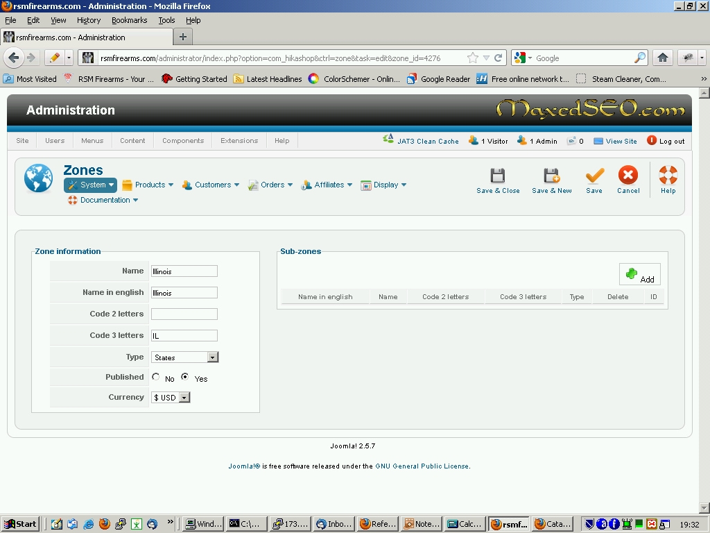

13 years 10 months ago #73225

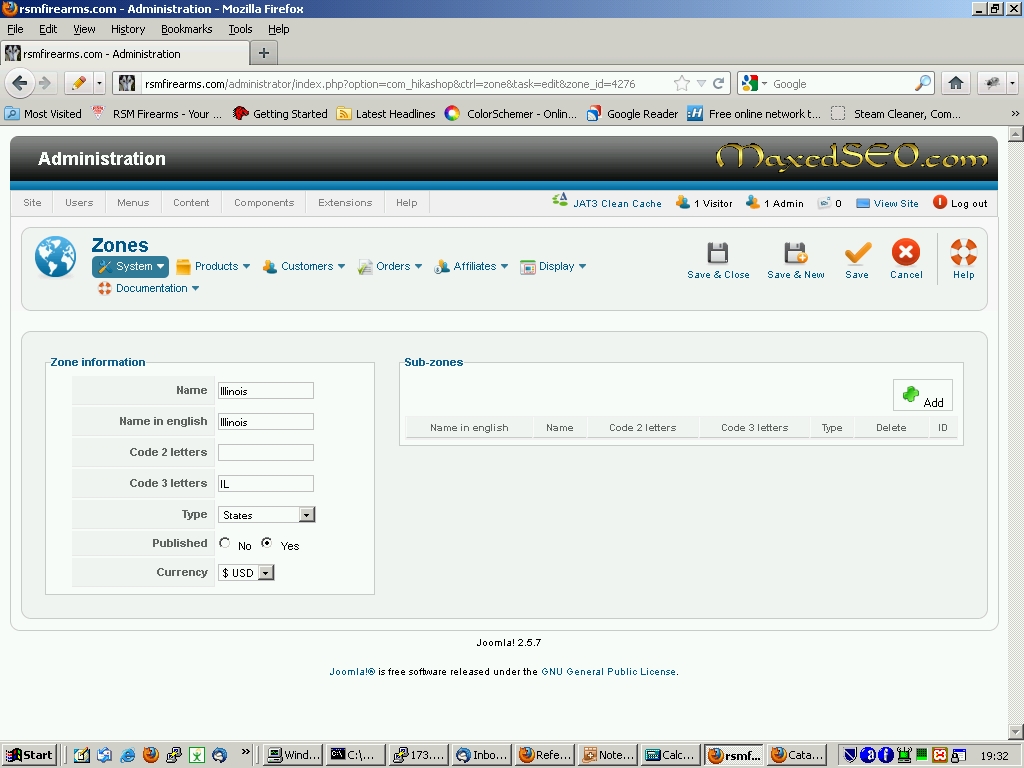

I went to Rules and Clicked on Illinois and here is the ZONES image.
What do you mean by "select it" please? I put a checkmark in it...laugh, but ??

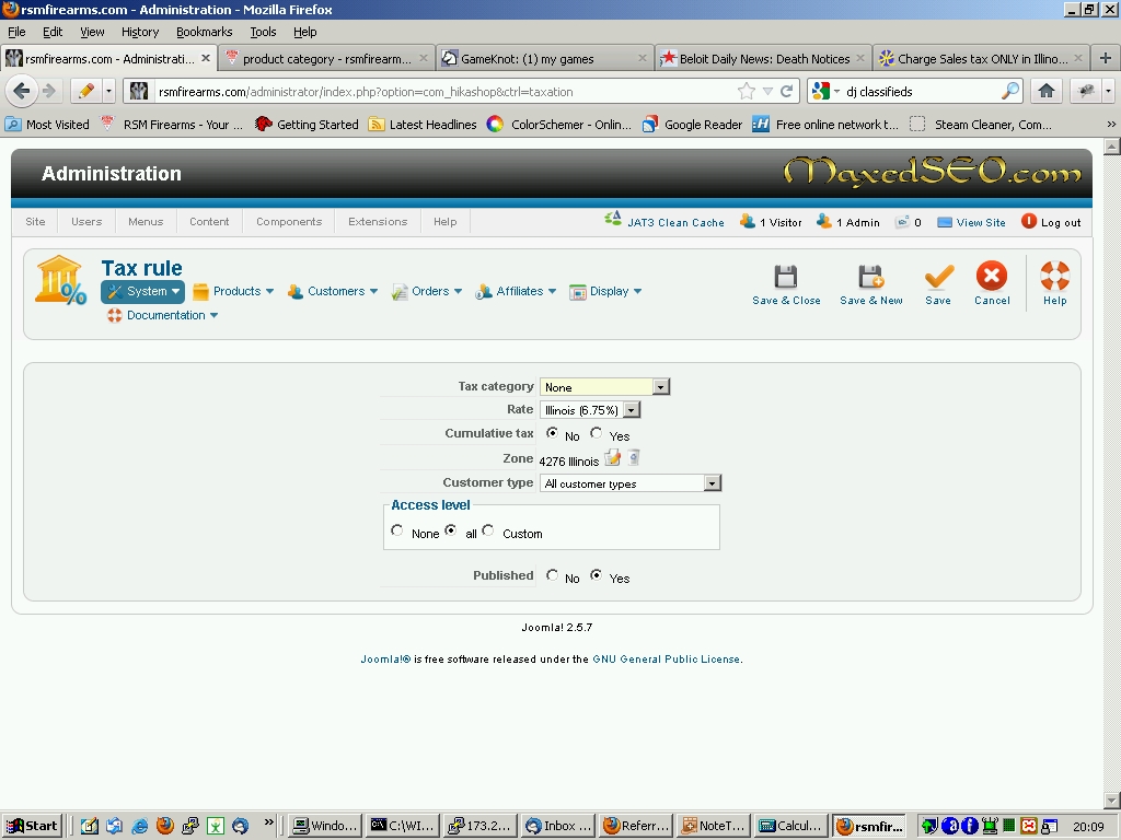

  • Posts: 86114
13 years 10 months ago #73230
That's is the Ilinois zone that you're editing. I'm talking about editing the tax rule from your first screenshot:
www.hikashop.com/media/kunena/attachments/5406/taxrules.jpg
You need to check the checkbox on the listing and then click on the edit button.

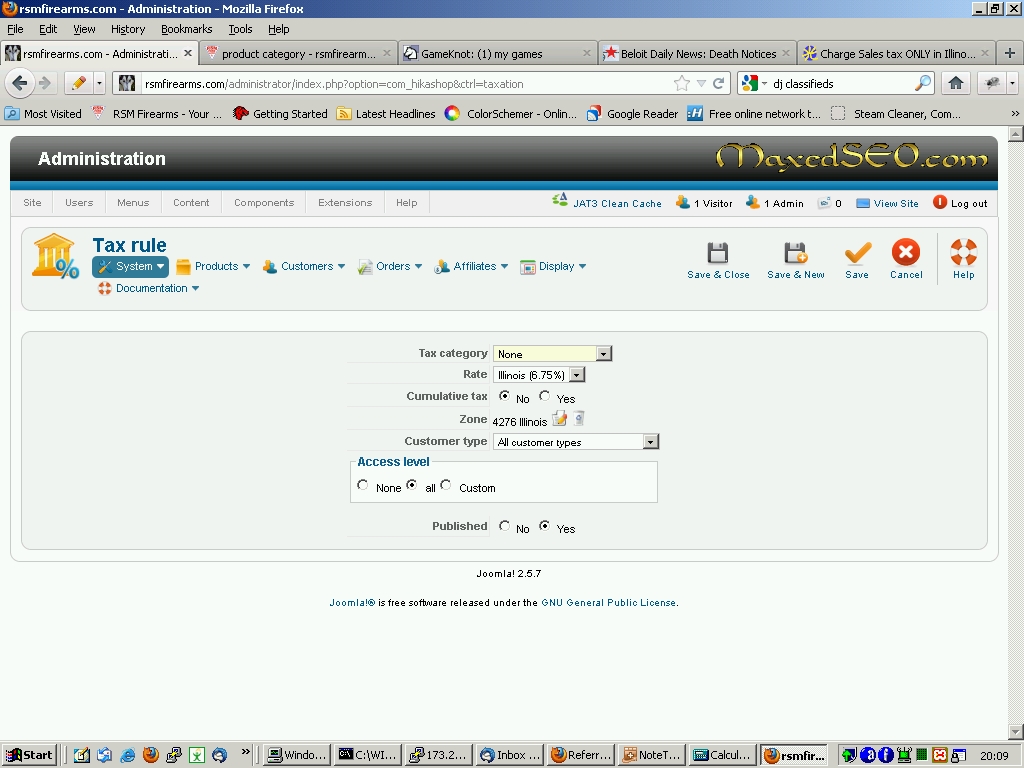

  • Posts: 135
13 years 10 months ago #73236
OK, attached now =
and wow.. That part is really not clear, to do that extra step I feel? But thank you..and I will try it now. I set it to Default? I hope that works... I did change (3) products..
Jim
  • Posts: 135
13 years 10 months ago #73245
Taxes, now showing and thank you.
