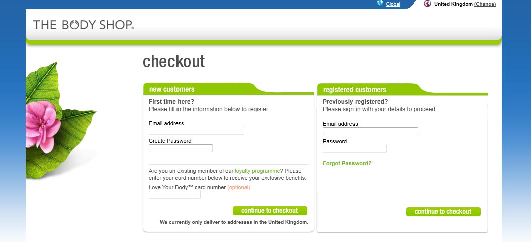

hi,
i want to change the checkout workflow.
first step i want to have the left login for register users with username and password.
and on the right for unregistered user the fields email and password and then the register button.
after clicking the register button i want the next page to have a table with delivery address and billing address.
is that possible? could you give me guide lines to do it?
thank you

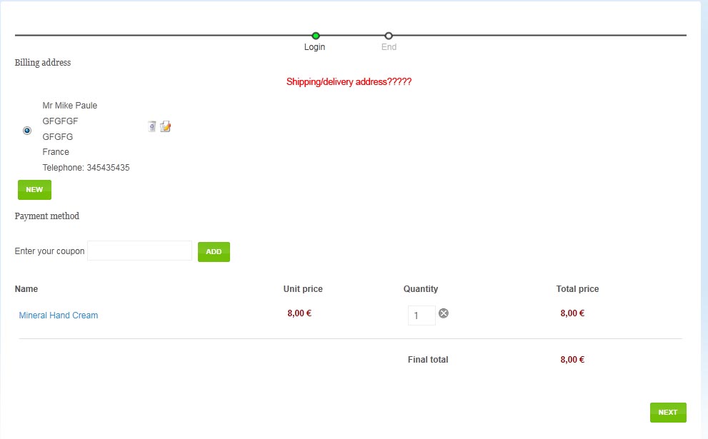

we want after confirmation the user to be able to add the delivery address and the billing address.
we are not able to have delivery address, i enable the Force shipping regardless of weight and the user is able only to put multi billing address.

If you don't see the shipping address selection it's because the option " Force shipping regardless of weight " is turned off (if you edited the views of the checkout from an old version of HikaShop and then updated, it's possible that the view doesn't include the modifications in order to display the interface when that option is turned on) and that you didn't set any weight in your products.
An easy solution is to set a weight on your products...

Is a fresh install
the Force shipping regardless of weight is on (Yes option)
we have weight in our products
i can see only billing address.

Also at the registration part we want to avoid the Address Information at the first step and the user to be able to insert the address details at the next step. How we can do this?
for example the "first step" is something like the screenshot below
