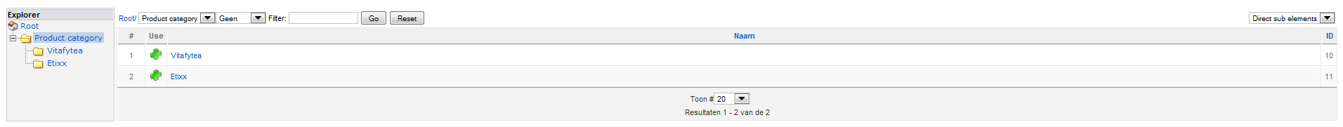

15 years 9 months ago #1724
i want to select the category by clicking on the green icon in column 'use'. but nothing happens. the url is www.mijnapotheekonline.be/shop/administr...mponent&filter_id=2#
  • Posts: 86101
  • Thank you received: 14203
15 years 9 months ago #1726
If you try on our demo website do you have the same problem ?
If so, which browser are you using ? If you use another browser, does it work ?
Otherwise, Could you try to look at the error console of your browser to see if you have any error ?
How to display the error console: stackoverflow.com/posts/1648614/revisions
  • Posts: 9
15 years 9 months ago #1729
on demo website everything goes correct. the difference is that clicking on category icon (after 'category not found') the link is opened in the same window not in a popup.
  • Posts: 86101
15 years 9 months ago #1732
Do you have the latest version of HikaShop?
Could you try to look at the error console ?
Which browser are you using ?
  • Posts: 86101
15 years 9 months ago #1733
Also, do you use a special template on your back end ? If so, if you try with the default template, does it work ?
  • Posts: 9
15 years 9 months ago #1741
nicolas wrote:
Do you have the latest version of HikaShop? 1.3.6
Could you try to look at the error console ? how to do this?
firefox 3.6.12
  • Posts: 9
15 years 9 months ago #1742
i use the standard khepri
  • Posts: 86101
15 years 9 months ago #1744
In the file administrator/components/com_hikashop/views/discount/view.html.php near the end of the file, could you replace the code
$this->assignRef('currency',$currencyType);
by the code
		JHTML::_('behavior.modal');
and try again ? Does it work now ?
