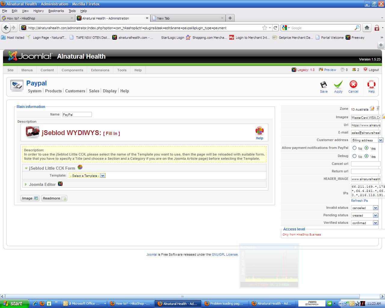

15 years 2 months ago #17289
I put the url in the url spot as shown in this screenshoot.
Thank you for your help.
  • Posts: 63
15 years 2 months ago #17291
I found the url www.paypal.com/cgi-bin/webscr > from the Paypal website and put it in the url spot and it is taking me to paypal. This seems to be the orginal url that is in there by default. I had worked when I orginally set it up and then I had a customer that who said it didn't take them to paypal, just the thank you page, so I tried it again and when I got the same results. It is like the url got messed up some how. Seems strange. Anyway it is working now.
