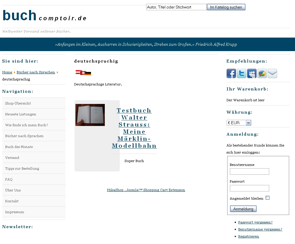

I have a display problem which only occurs in a certain module and all its subcategories:
http://shop.buch-comptoir.de/index.php/buecher-nach-sprachen/category/listing/cid-14/name-englisch--english.html
Here e.g. everything works fine:
http://shop.buch-comptoir.de/index.php/shop-uebersicht/category/listing/cid-42/name-broschueren.html
Thx in advance for help, M. :dry:

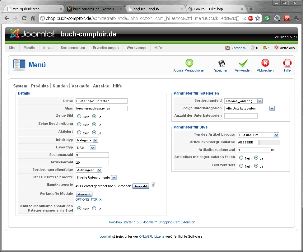

  • Posts: 31
15 years 3 months ago #17082
Nope, this time it didn't work out.
I checked ALL my modules and menus (associated ones, too), all are set to "DIV". Control panel for menu "Bücher nach Sprachen" looks like this:
Hm, pls let me know if and which additional information you need.
Thx in advance, M. :S
www.buch-comptoir.de
[Weltweiter Versand seltener Bücher]
  • Posts: 86181
15 years 3 months ago #17085
You need to click on OPTIONS_FOR_X. There, change the number of columns to 1 and that should be better.
