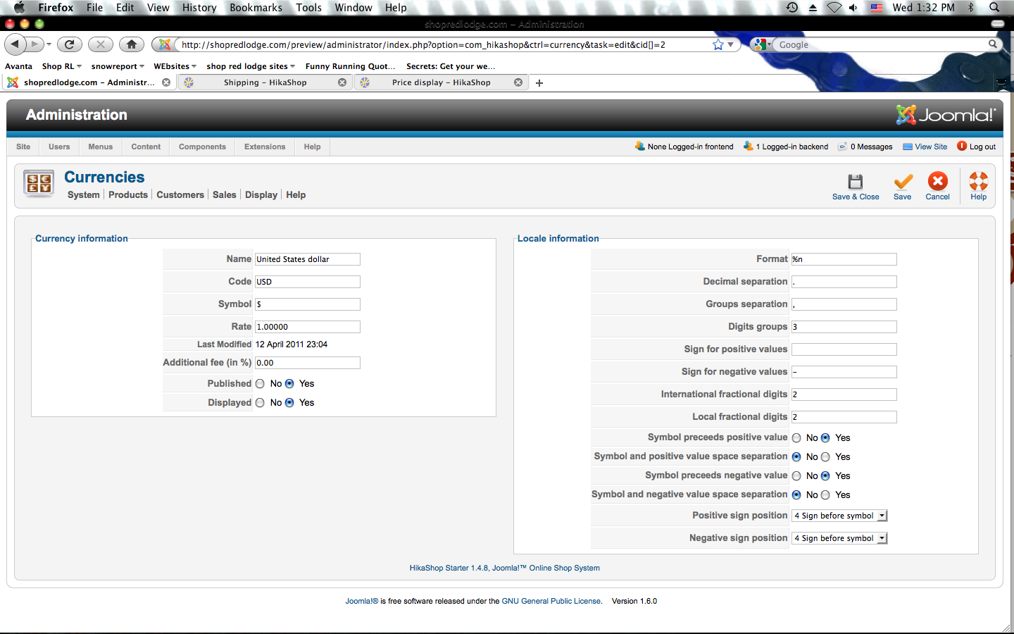

It must be because of the way you setup your currency in the currencies setup screen.
Could you do a screenshot of the options of your currency (menu System->Currencies) ?

15 years 3 months ago #17163
Here you are. Thanks for your help

15 years 3 months ago #17165
That seems all fine.

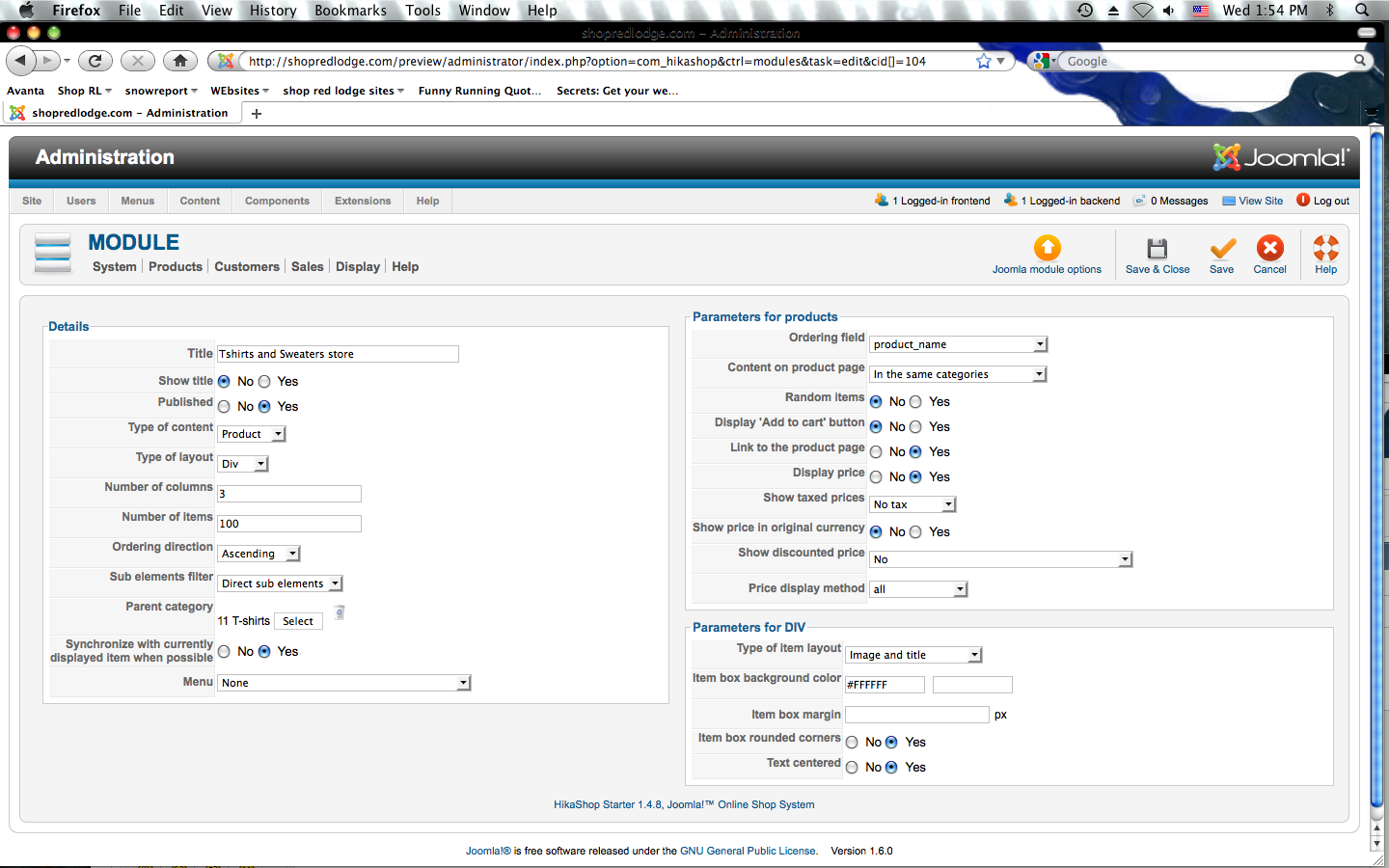

I also see that when you open a product page, the price is fine.
Could you do a screenshot for the hikashop options of your module ?

15 years 3 months ago #17167
Yep, thanks again for your help. I set these modules up in a {loadposition } so that they would show in the article.

15 years 3 months ago #17169
And thats it.... if you put the module in an actual module position then the prices show fine. But if its in a {loadposition} format something gets lost.
