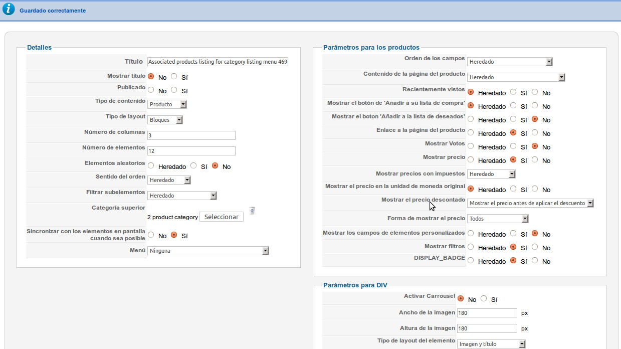

1.Discounts can be handled via the menu System->Discounts. If you want to restrict discounts to a product or a category of products only, that is only possible in the commercial editions of HikaShop. Once that is done, in each of your modules and menus hikashop options (you can access them via the menu Display->Content menus/modules), you have an option to select how you want the discount to be displayed (crossed price is a possibility). You also have that same option in the tab Display of the configuration for the product page.

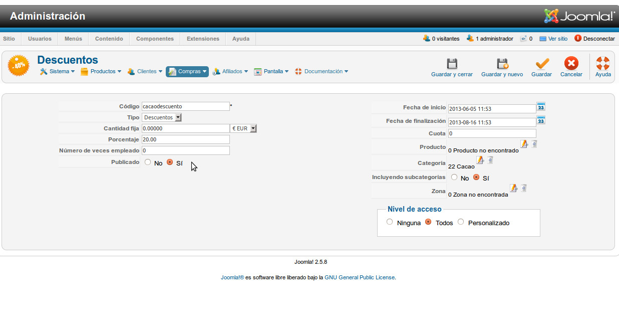

I am trying to show crossed price and discount price but I can't.
I have made a discount for a category (Alimentación->cacao 20%) but i can not see the discount and any crossed display.
We have hikashop business.
Also in system->configuration->products there is no option for discount in product show.
the url of the shop is www.tienda.tiendamundos.com/tiendamundos/es/
thanks

  • Posts: 86102
  • Thank you received: 14203
13 years 2 months ago #108570
The options you're editing seems to be the correct ones.
So it's like it's more a problem of the discount itself.
Can you try to remove the restrictions of the discounts to see if the prices/discounted prices display properly ?
  • Posts: 15
13 years 2 months ago #108604
Hi again
If I apply to a single product it works, but if apply to a category not works :(

8 years 9 months ago #282395
I see this was posted six years ago.. Is this functionality still there? I cannot find this in ver. 3.2.1.
  • Posts: 86102
8 years 9 months ago #282401
Yes it is. It's the setting "Discount" under the "products options" tab when you edit a products/categories listing menu in your menu manager:
monosnap.com/file/AMyPvhuud81HCcxE4IaW8Bk7xpiXCV
