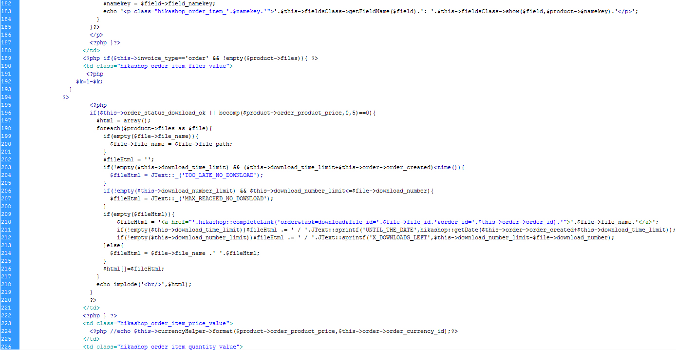

I don't know what went wrong here:
can somebody help me?
Last edit: 15 years 3 months ago by gerard_pp. Reason: image removed
  • Posts: 86181
15 years 3 months ago #18003
What code do you have on that line in that file ?

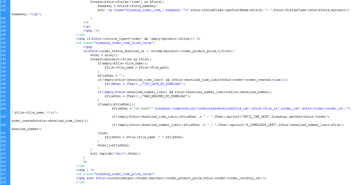

15 years 3 months ago #18005
  • Posts: 86181
15 years 3 months ago #18006
There is no foreach on that 198 line. Are you sure that you did the screenshot for the correct file ?
  • Posts: 44
15 years 3 months ago #18008
Sorry about that. This is the file:
  • Posts: 86181
15 years 3 months ago #18009
You don't have the code of the latest version so that's why you have that message.
The easiest will be to just change that line to:
foreach(@$product->files as $file){
