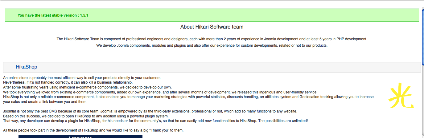

  • Posts: 35
15 years 3 months ago #18158
I have updated to the latest version. Still no luck.

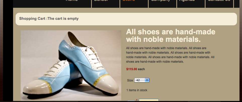

  • Posts: 35
15 years 3 months ago #18166
I did indeed change the product show view. But I only reordered the code -- as you helped me do yesterday in another thread.
I have attached a screen shot from how I currently see the page.
Would you like me to attach the product show view?
  • Posts: 86181
15 years 3 months ago #18167
Please remove temporarily your modifications and try again.
