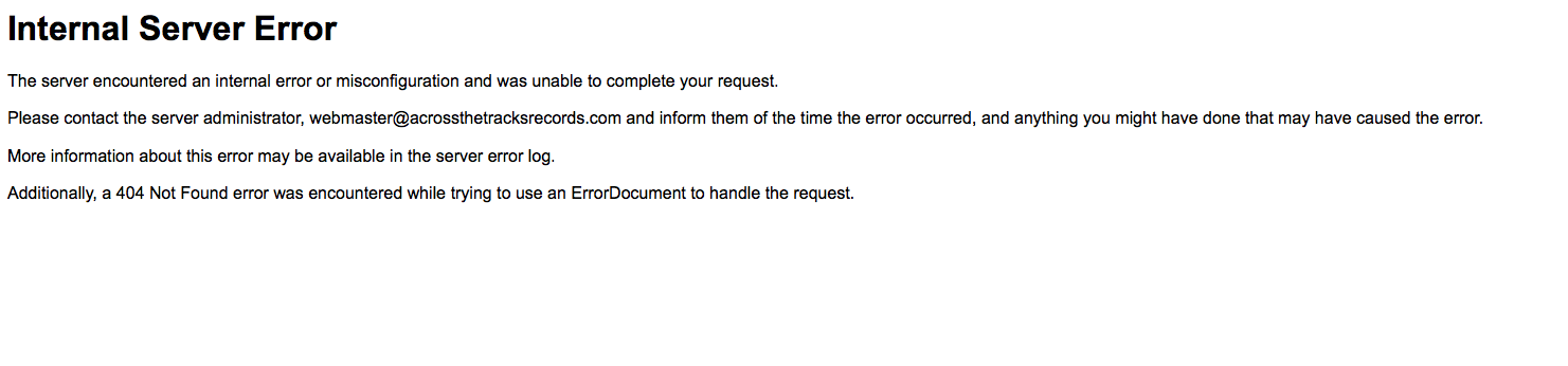

15 years 3 months ago #18564
Hi again
I have tried uploading the csv file, which I have made from a turbo lister file. I am unable to upload it, and get an error message. I am attaching both the csv file and a screen shot of the error message. Please could someone help me sort this out.
Thanks so much for your help and patience!
  • Posts: 86181
15 years 3 months ago #18567
That's not a CSV file. If you open a CSV with notepad, you should be able to read the data in it.
If you open your file with notepad, you can't read anything. So It's normal that you get an error.
Also, before importing a CSV made from another software, you need first to open it with excel or such software to change the name of the columns so that it uses hikashop's columns names.
