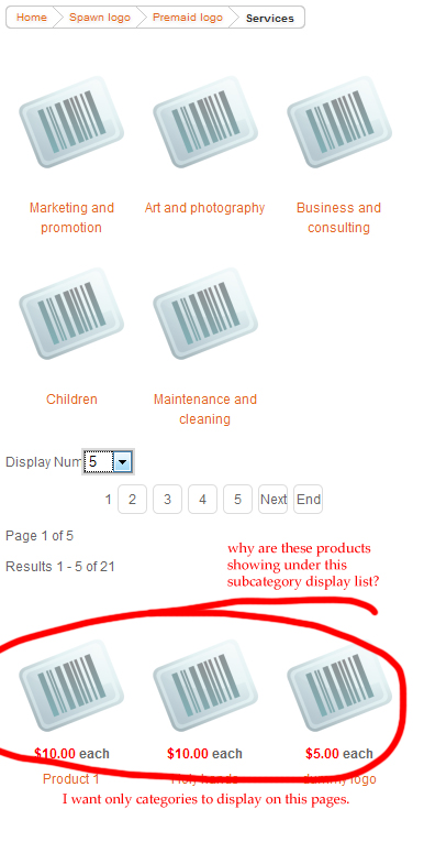

Some products are being displayed on my category listings. I don't want that to happen. I only need categories on category listings. How can i achieve that?

In the associated module of your menu, you need to change the "sub element filter" option to "direct sub elements" instead of "all sub elements"

Did that, but the products are still showing.

Either :
-You didn't change the option in the good place.

:blush: That was my bad. Just like you said, the products were on the service category.
