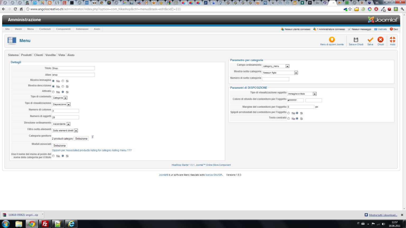

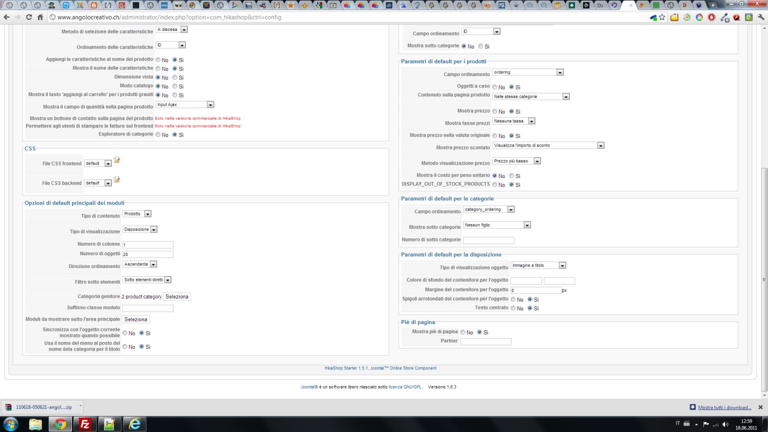

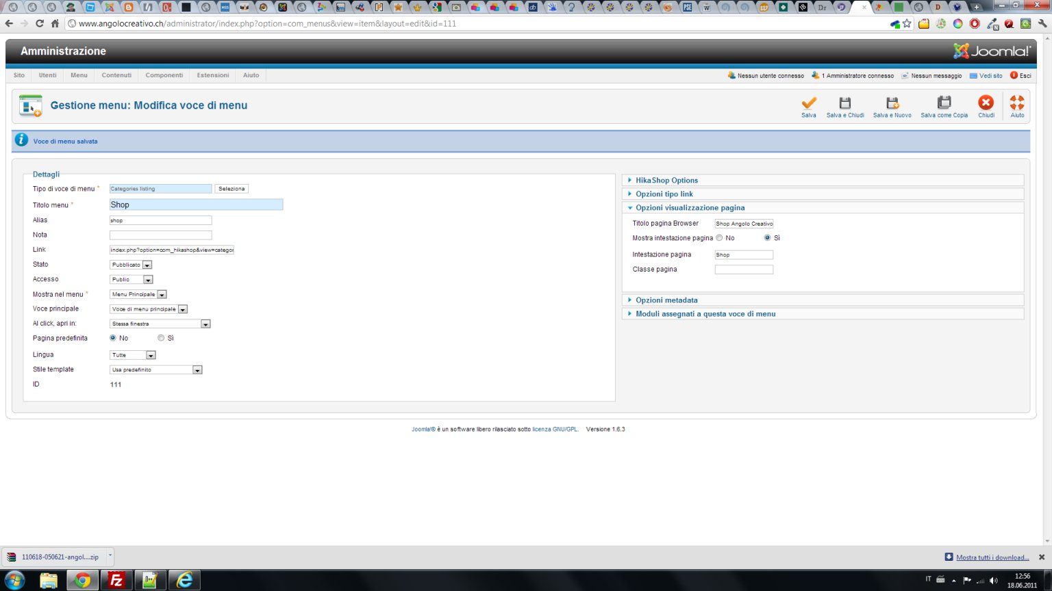

Could you do a screenshot of your shop menu options with the show title option activated ?
  • Posts: 55
15 years 3 months ago #19242
Here you have the screenshots
  • Posts: 55
15 years 3 months ago #19243
Last edit: 15 years 3 months ago by skatercorpse.
  • Posts: 55
15 years 3 months ago #19244

Could you try to redownload and reinstall hikashop on your website just in case...You options are fine and it works with the same settings on our end...
