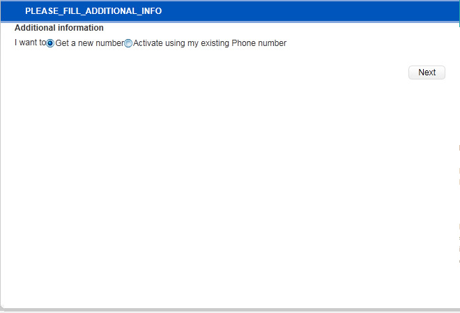

15 years 2 months ago #18793
i would like to add a link right after to the field of the order custom fields. check out the image.
the idea is to have a link that will be a lightbox window with more information about what we are asking for in the field.
should be a core feature :)
anyway for now i just need to make it happen though, any ideas of the easiest way to implement it?

on the same subject in the view fields of check out the main php code is this
<?php
if(!empty($this->extraFields)){
$this->setLayout('custom_fields');
$this->type = 'order';
echo $this->loadTemplate();
i would assume this is loading the fields of the table order. i want to control which field load and which don't in other words i want to know what is the code to echo each field separately. i need them in specific places on the page. and this throws it all in a table.
so
How do i echo 1 field of the table order?
What i want to end up having is a radio box list that when they select their option the correct fields are displayed, when filled and they are submitted normally.

hey, this code
echo $this->fieldsClass->display($this->extraFields,$this->order->column_name,'data[order][column_name]');
doesn't print out the label.
i am using span with strings for now.. let me know.. thanks.. also i am not eachoing any custom text fields and i am getting the some problem as i posted earlier.

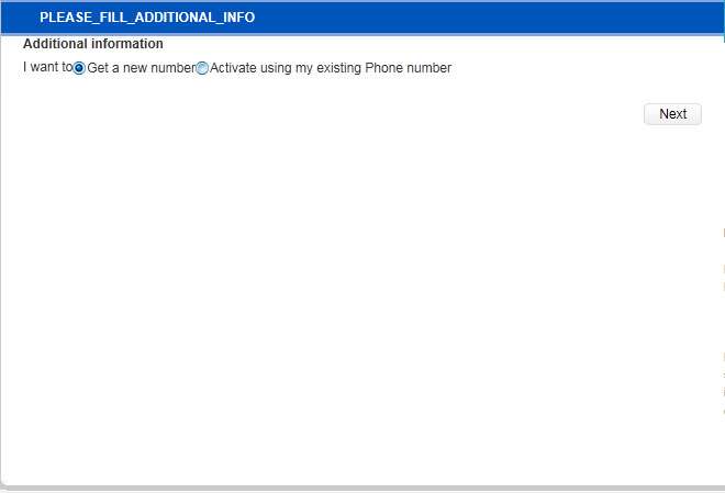

  • Posts: 156
15 years 2 months ago #19121
How about the please_fill_addiotional_information problem? Any reason why this keeps happing to me ;(?

  • Posts: 156
15 years 2 months ago #19124
The radio check custom field type?
Well like I said above I tested it with no fields being echoed and I was still having the issue. I. also tested it just with a text field and still the same issue. This form is really important in my case so I need to get it working nicolas, would you like back-end access to help move this along?

  • Posts: 86101
  • Thank you received: 14203
15 years 2 months ago #19189
We put some traces and found out that the data is good on HikaShop's end but that joomla does not stores the variables that HikaShop gives it in the session. Which results in HikaShop believing that the custom fields have not been filled.
That can happens sometimes on servers with a specific configuration and with the session handler being the database. Usually, changing the database handler to "none" in the joomla configuration solves the problem without any drawbacks.
We can't access the configuration of your website and can't modify the configuration.php file so we couldn't test that.
Please change it yourself and logout/login from the front end and try again.
