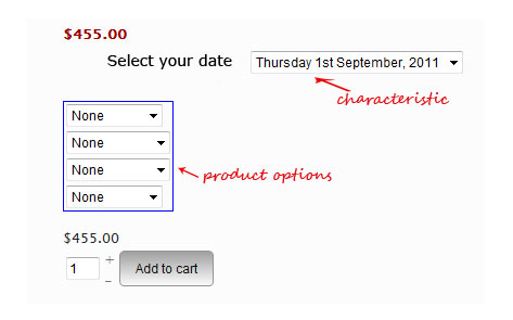

I have set up a product that has characteristics AND product options, but for some reason the labels on the product options are missing.
I may have removed these sometime earlier but can't figure out how to get them to show.

Here is my scenario...
I have a base product of tickets to an event and the buyer can choose to hire shoes if needed at an additional cost. I have set up two products as follows:
Base
Product: Buy a ticket (with price set as $200)
Characteristic: Select from list of available dates
Variants: August 15
September 15
Option
Product: Shoe hire required (with price set as $15)
Characteristic: Shoe hire
Variants: No +$0
Yes +$15
When I add the Option Product to the Base Product the label appears with a dropdown containing "No +$15" and "Yes +$15".
If I don't have any characteristics set on the Option Product, then the dropdown appears as "none" and "+$15" which is what I want but there's no label indicating that the dropdown is for shoe hire.
I'm not getting how this works or I'm missing the point completely. Can you steer me in the right direction?
Many thanks in advance.
