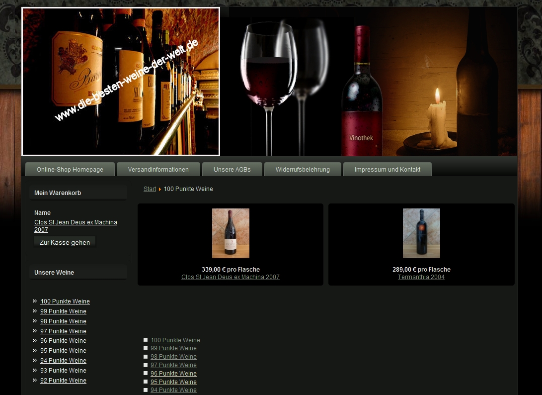

I just realized that I need the same information (price per Liter) on the panel where all products of a certain category show up (I chose they show up with their respective prices). Can you please tell me which view that would be? I searched for an hour but did not find.
Thank you very much in advance!

hmmm... this one did not work. Still showing only the product price but not also the per Liter price on the product listing page. This is the page I need it to be displayed as well: www.die-besten-weine-der-welt.de/compone...00-punkte-weine.html

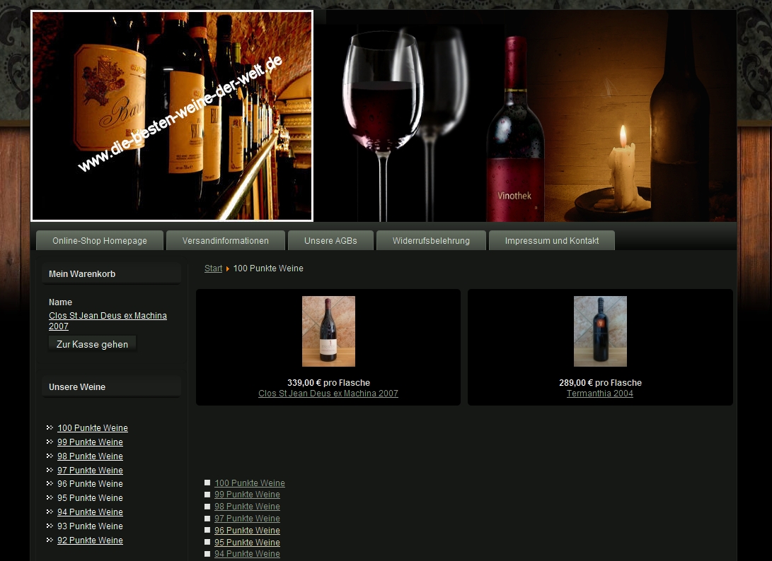

Maybe we are discussing about different panels. Again implemented what you proposed but it does not yield the results on the following page:
The php-code on the respective display reads:
if(isset($this->row->product_weight) && bccomp($this->row->product_weight,0,3)){
$weight_price = $price->price_value_with_tax / $this->row->product_weight;
echo JText::_('PRICE_SEPARATOR').$this->currencyHelper->format($weight_price,$price->price_currency_id).' / '.JText::_($this->row->product_weight_unit);
echo JText::_('PRICE_END');
?></span>
I wonder what my error could be... Perhaps there is an additional switch in a module definition that needs to be turned on?

If you don't at least the verison 1.3.7, it's probably a problem with the modified view not being loaded, please look at this post and apply the modification proposed : www.hikashop.com/en/support/forum/4-how-...n-checkout.html#1852
  • Posts: 137
15 years 8 months ago #2582
I just migrated to version 1.3.8 and everything works fine. Thank you!
