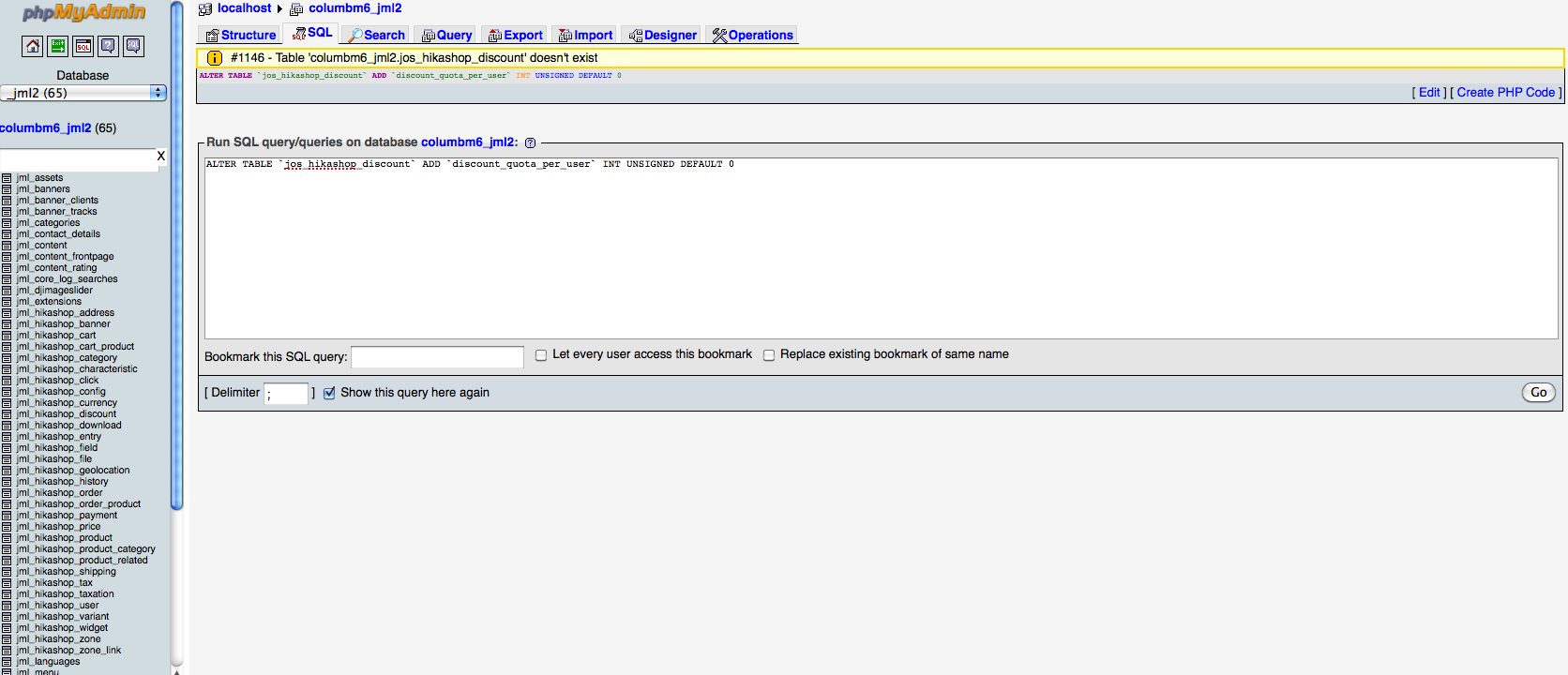

15 years 2 months ago #19644
I get this error message. Should I change jos to jml? I wouldn't ask questions if I wasn't afraid of messing this up.. haha
thanks in advance.
  • Posts: 86180
15 years 2 months ago #19647
Indeed, you need to use jml instead of jos.
