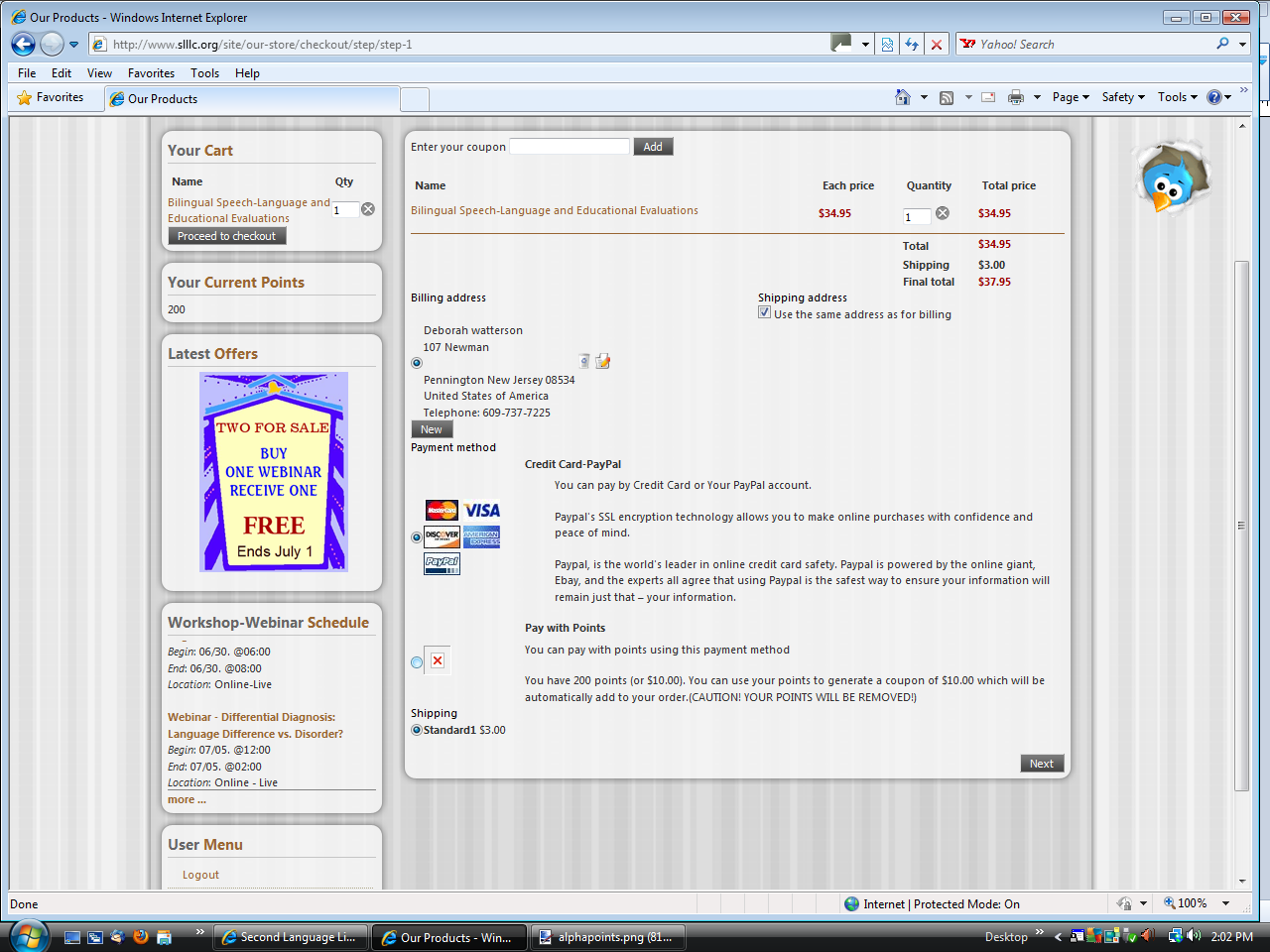

15 years 2 months ago #19706
the image I am asking about is the x next to "pay with points"

For the image, you need to select an image in the "images" option of your AUP payment plugin. If you want to use an image which is not in the list, you need to upload it in the folder media/com_hikashop/images/payment via FTP. Then, you will be able to select it in that images option.

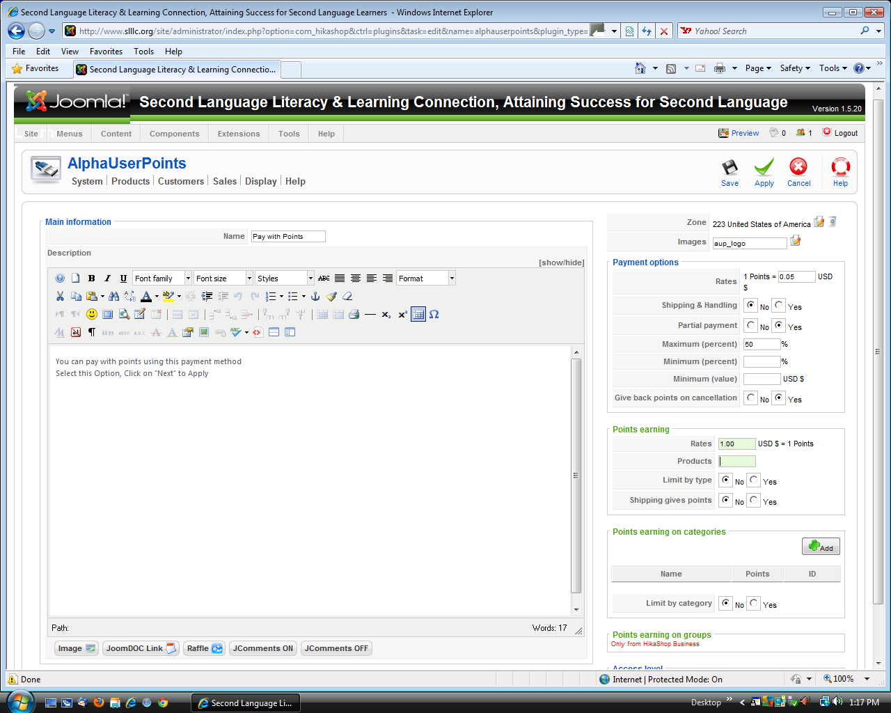

  • Posts: 48
15 years 2 months ago #21347
In your prior post you stated that points are only given for an order once the order is confirmed
I appear to be having a prob with this happening, as after a customer has completed their purchase using paypal and the order is confirmed the points are not showing next to the customer's name in AlphaUserPoints User listing.

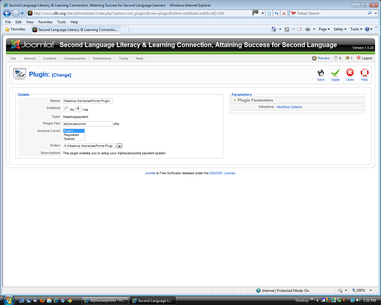

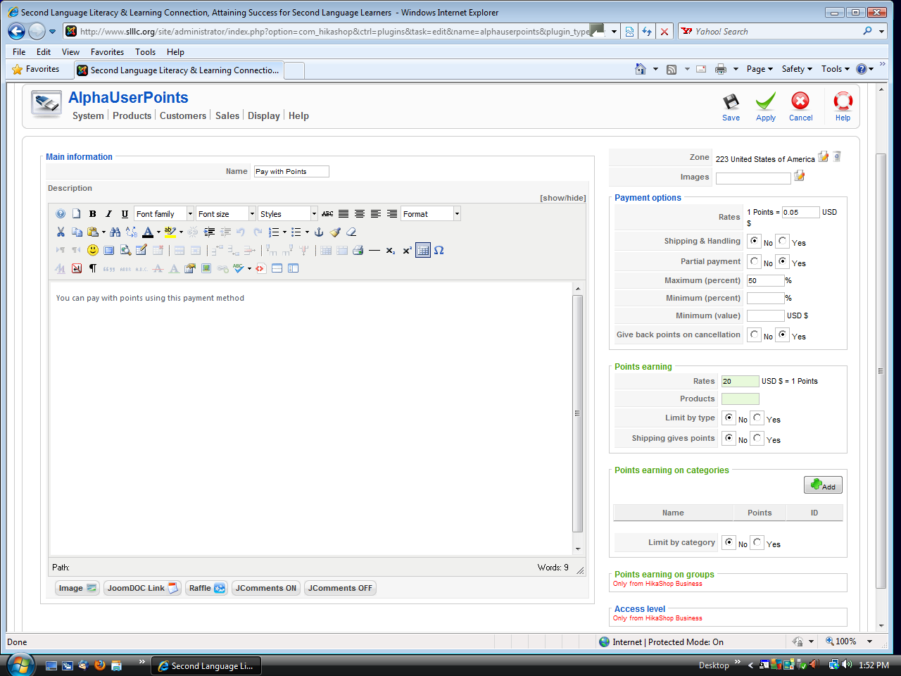

I am providing a screen shot of my setting for the Hikashop AlphaUserPoints plugin, perhaps I setup something incorrect.
  • Posts: 86179
  • Thank you received: 14214
15 years 2 months ago #21350
Do you have the rule called "Order_validation" on your alphaUserPoints plugin ? If not, it's likely that you don't have the latest version. If so, please update and make sure that the configuration of the plugin is still ok. Then, go in your AUP rules listing and that rule should be displayed. Then, try again an order.
  • Posts: 48
15 years 2 months ago #21352
see screenshot of my alphaUserPoints plugin

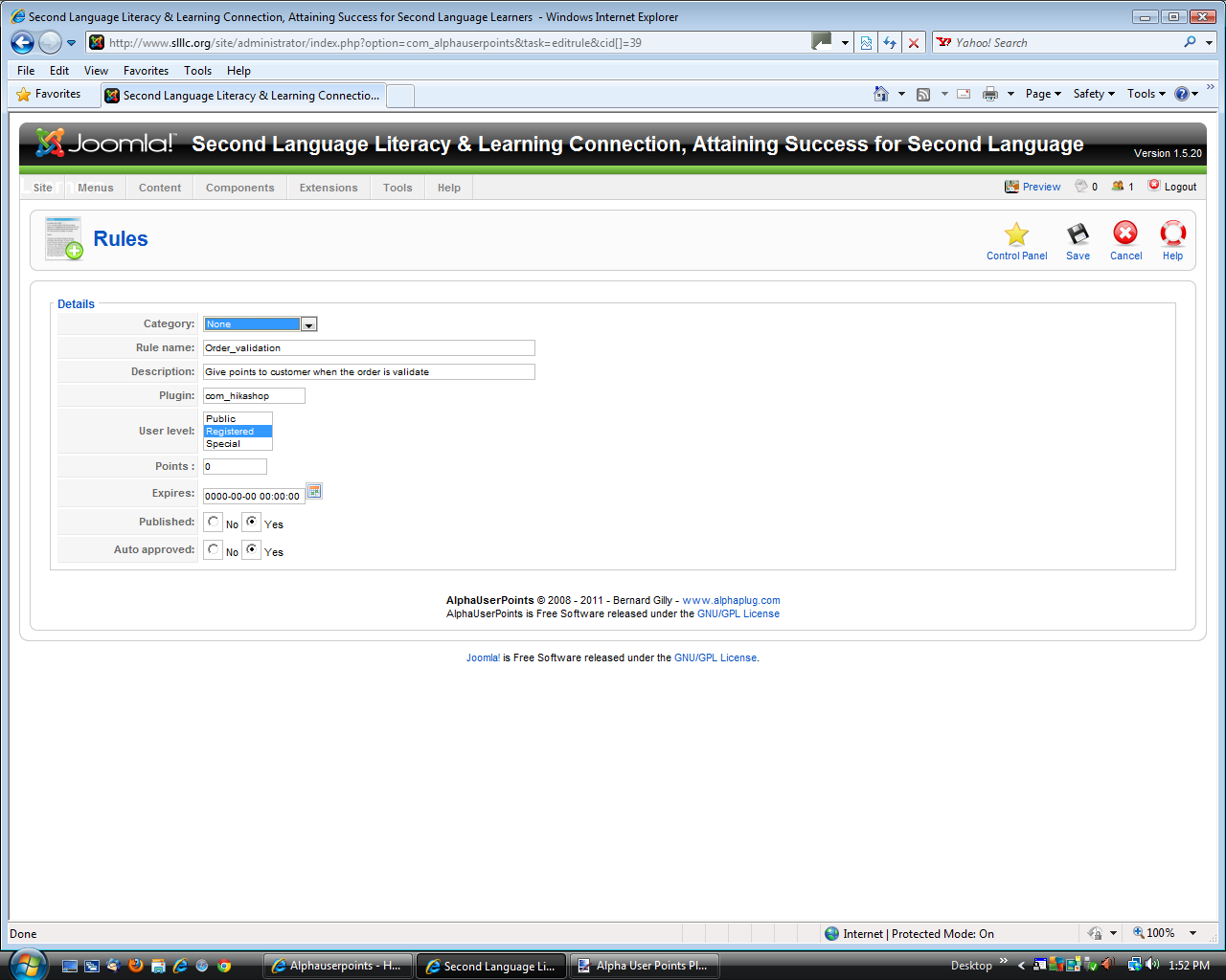

Also, see the AUP Rule screenshot - is the category not set correct?
  • Posts: 48
15 years 2 months ago #21353
AUP Rule screenshot
  • Posts: 86179
15 years 2 months ago #21365
So it seems that everything is correct. It might be a bug. Could you provide a back end AND FTP access to your website so that we can check on the problem ? (you can use our contact form in order to send the information). If so, the developer who worked on that plugin will look at the problem on monday and fix the situation or the bug if he finds it.

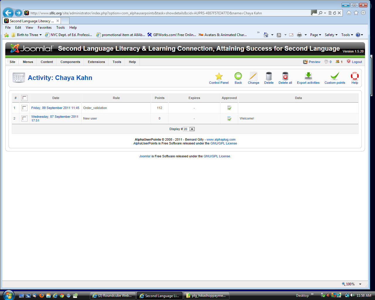

As far as the second prob, see the attached image.
Within the Hikashop ordering the total for the order was $112, no shipping charges, with a discount of $10 which made the total order $102 which AUP should have recorded as 102 points but recorded 112 points. Maybe the above install prob is related.

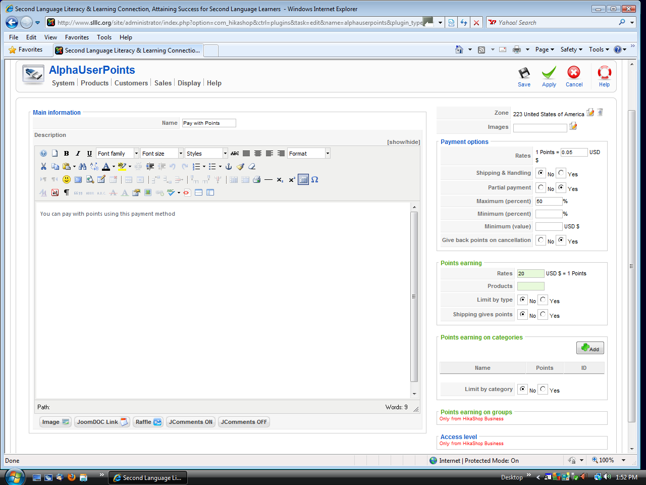

  • Posts: 48
15 years 6 days ago #25254
opps, wrong image
