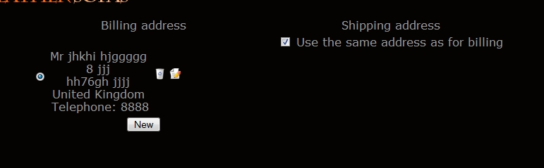

Hi gang,
I'd like to completely remove the pictured step from the checkout workflow.
I have the workflow set to:
cart,login_address,payment_confirm_cart_status_fields,end
but none of these seem to help.
Thanks.

You need to remove _address of your checkout workflow

Doing that does remove the step, but it also removes the actual shipping (delivery) function. It appears without that step no actual shipping address is being picked up, is there a way around this?

I must say I a bit lost here. There is no shipping view in your checkout workflow, so it's normal that you don't see it.
Could you do a screenshot of the whole checkout tab configuration so that we can see how you configured your checkout ?

Sorry my bad, not sure when I deleted shipping (accidentally) now have:
cart,login,shipping_payment_confirm_cart_status_fields,end
which works exactly as I want it, thanks!

Unlike mrdexter I would only like to remove the Shipping address and leave Billing address. Is that possible?

If you don't want the shipping address, you can just not set a weight on your products and not turn on the option "Force shipping regardless of weight" of the configuration. The shipping address interface won't be displayed.
If however you want a shipping methods selection interface you should do the opposite and hide the shipping address div with CSS:
.hikashop_checkout_address_right_part{ display:none;}
