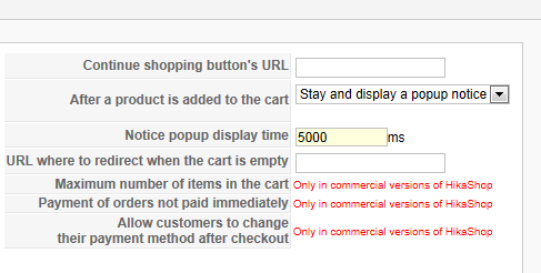

You can access the shop here:
www.intothewebportugal.com/index.php/sho...ing/cid-29/name-acer
The settins at this moment are equal to the image attached.
