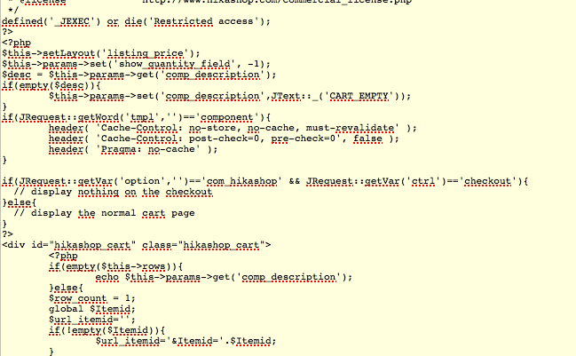

  • Posts: 50
15 years 9 months ago #2788
But none of them seams to work for me. Is there an other way? I have moved the shoping cart to the bottom. But it is still confusing on the check-out-page to have two shoping carts...
Last edit: 15 years 9 months ago by weting.
  • Posts: 86096
  • Thank you received: 14200
15 years 9 months ago #2789
The second version will definitely work. Could you post your modifications to the cart file so that we can look at how you did it ?
  • Posts: 50
15 years 9 months ago #2790
Tried to but it in the beginning and in the end of the file. No difference. Where should it go?
Now I see. I was in the wrong file first time. I will try again.
  • Posts: 86096
15 years 9 months ago #2792
You can just put that code in there "as is". You need to put the content of the file in the "else" statement of the code I posted above. Otherwise, it doesn't do nothing.
  • Posts: 50
15 years 9 months ago #2793
I guess this is too much programming for me.
I need a more exact instruction to make it work. Otherwhise I am just guessing...
  • Posts: 86096
15 years 9 months ago #2795
Please download the file enclosed, copy its content and paste it in the cart file instead of the whole code and that will do it.
  • Posts: 50
15 years 9 months ago #2796
Great :)
