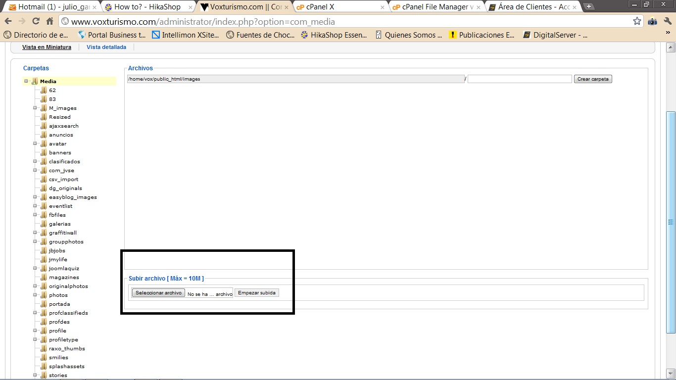

I made any test and change the limit and I can see the joomla media center, the change is correct, I did change to 6, 8, 10MB and is correct but in HikaShop not change
I check in the php.ini and the php cpnfiguration into my root account and i have 10M but hikashop no change

14 years 11 months ago #27259 by nicolas
Most of the other components just check for upload_max_filesize and not for post_max_size.
That's probably why.
Again, please check the value of post_max_size in your php.ini

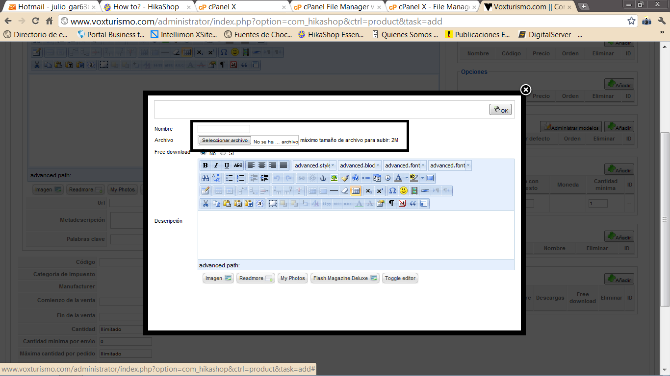

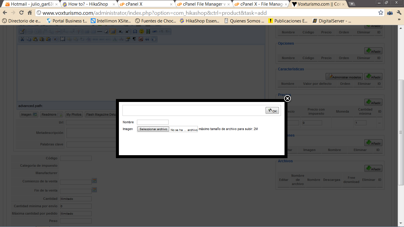

I send 2 screen in hikashop with 2M

14 years 11 months ago #27300 by nicolas
That message is displayed by the code:
<?php echo JText::sprintf('MAX_UPLOAD',(hikashop_bytes(ini_get('upload_max_filesize')) > hikashop_bytes(ini_get('post_max_size'))) ? ini_get('post_max_size') : ini_get('upload_max_filesize')); ?>
in the file "selectimage" of the view "product" that you can edit via the menu Display->Views in HikaShop.
As you can set, HikaShop just displays the biggest value between post_max_size and upload_max_filesize which are returned by PHP.
If you want, you can remove that line and not have that message, you can put another message also. But that won't change the upload limit of your server.
Again, this is just something displayed by HikaShop so that you know the upload limit of your server. Whether you display that message or not, the limit is the same, for any component.
