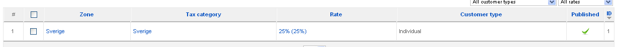

I have set up a tax category, added a tax rate and created a tax rule.
When I create or edit a product I select this tax category. When I enter a price the price in the fields for without/with tax are always the same.
I have tried to change a lot of settings but can't get it to work. Help please!
Regards Nils

I see that you limited the tax to individuals and to the zone sverige. On the main tab of the configuration, do you have the "Default address type" option set to individual ? Do you have the option "Main tax zone" set to sverige ?
  • Posts: 23
15 years 9 months ago #2097
I had missed the main tax zone option. Now it's working. Thanks!
