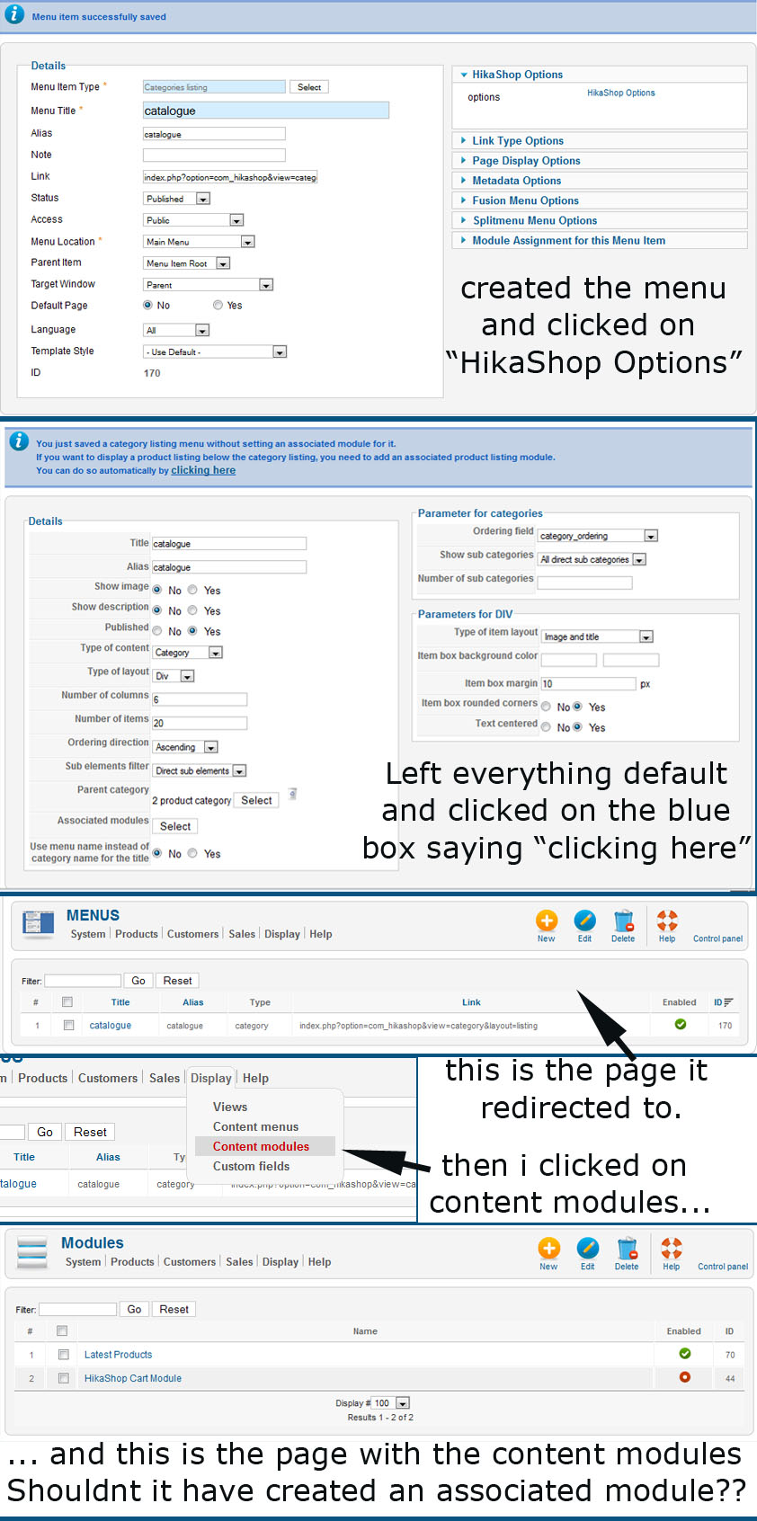

I have attached all screenshots in one image.

One thing i noticed is that you say that when i create the menu and then click the hikashop options to create the hikashop menu module it should then create the associated module automatically.
That doesn't happen for me. When i click "hikashop options" to create the hikashop menu module it shows me a blue box stating that i have not created the associated module yet and should click here to do it automaically. When i click on it though, it just takes me to the "content modules" page and doesn't create any module.
I have now deleted all menu items, associated modules and menu module and joomla modules associated with that and will start from scratch again. I will post all the images as i do it in a new post.

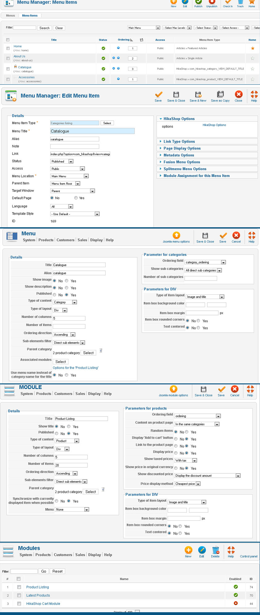

Ok, i have tried to recreate it and have made snapshots as i went along. I have annotated them. It seems it is not creating the module automatically and if i create it manually it doesnt work.

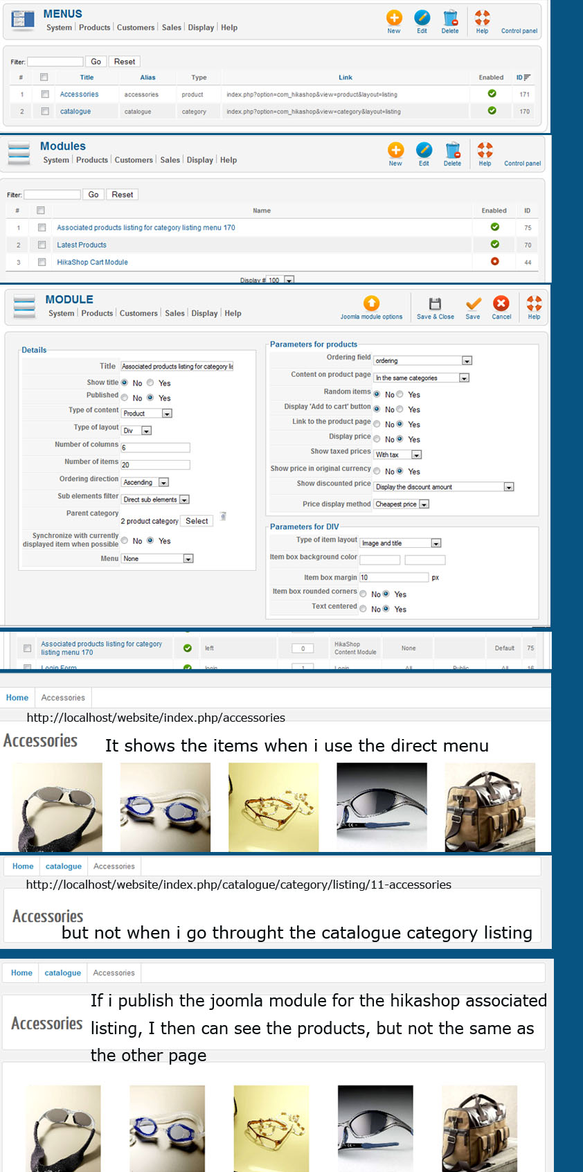

very odd thing. After I had created the hikashop menu for the catalogue, i decided to create a menu for the accessories to show you that it did have items in it and when i checked back in the hikashop modules there was now a module saying "Associated products listing for category listing menu 170 " :woohoo: . I see that the ID for the catalogue menu i created earlier is 170, so i presume this is for that. Odd that it all of a sudden appeared.
It still didnt display though so i checked the joomla modules and found that it had created the joomla module for it as well, as it should be, but it is set to not show on any pages and in the wrong position. If I change the position and set it to display on my product pages, then it works and displays the products, but not in the same way as the direct menu does becasue i have to set it to a module position and that module position cannot be the main article position whereas the direct menu link display all the products automatically in the main article position automatically.
Still something not right in other words, or I am doing something wrong.
Besides, your help says...
Also, since this module will be displayed by HikaShop you might want to unpublish it to avoid having it displayed by Joomla somewhere else on your template.
http://www.hikashop.com/support/documentation/67-hikashop-content-display-front-end.html#categories_
I have attached another image to show you everything.
I can manage like this for now, but it is a pain as i have to manually set the module to show on only my product pages and it shows in the wrong place (not the main article position) and therefore doesn't look the same as the direct menu link and also has a different http link which is not good.

Yes, you should not publish the module in joomla. Instead, you should have the module published in the "associated modules" option of your menu. That's what the documentation says and that's how it should be done in order to work properly end have the pagination.
Note that for the pagination to be displayed, the random option of the module needs to be turned off.

As in the attached image, i have not set the module to random yet it still doesn't give me the pagination.
