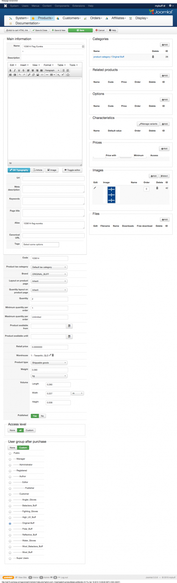

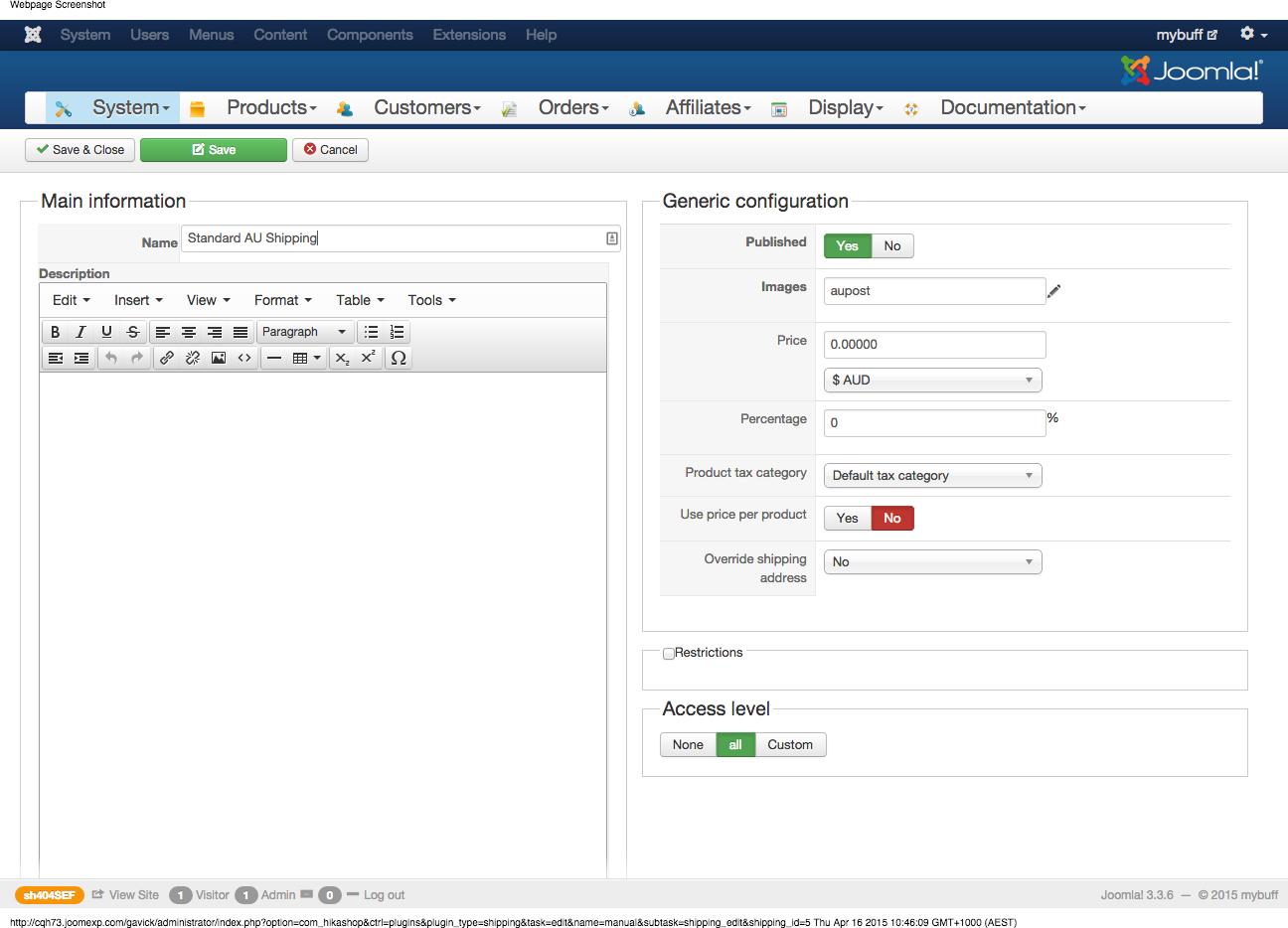

Hello Mohammed,
Here are two screenshots. One is the manual shipping method. It has no price ($0.0) because it is free shipping as standard for any product. I removed the restriction Zone: Australia for testing purposes.
The other one is a screenshot of a product that I use for testing.
Edward
11 years 4 months ago #198819
Your issue is probably coming from the fact that you have a warehouse on your product configuration page, the solution will be to :
- set the same warehouse on your shipping methods
OR
- remove that warehouse from your product configuration page.
  • Posts: 35
11 years 4 months ago #198928
Dear Mohammed,
your hunch was right. It was the warehouse in the product configuration page.
What I don't understand now is what the field is for? I want to set up warehouse locations in preparation for Hikamarket and Multivendor.
Edward
Edward
