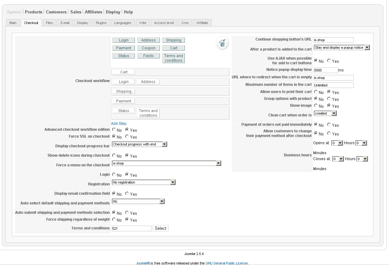

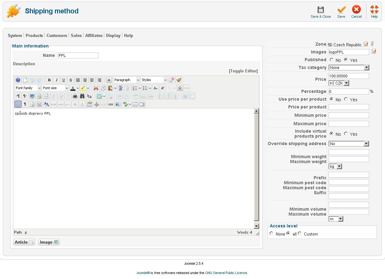

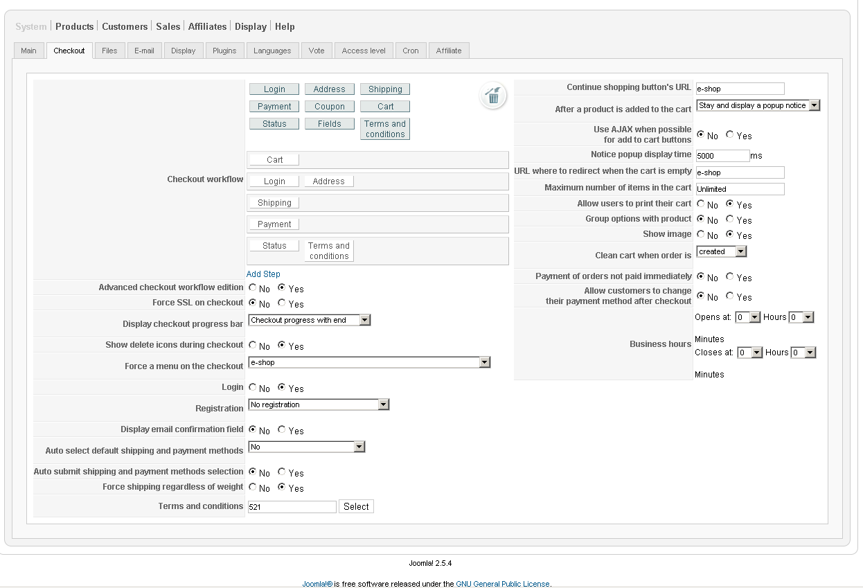

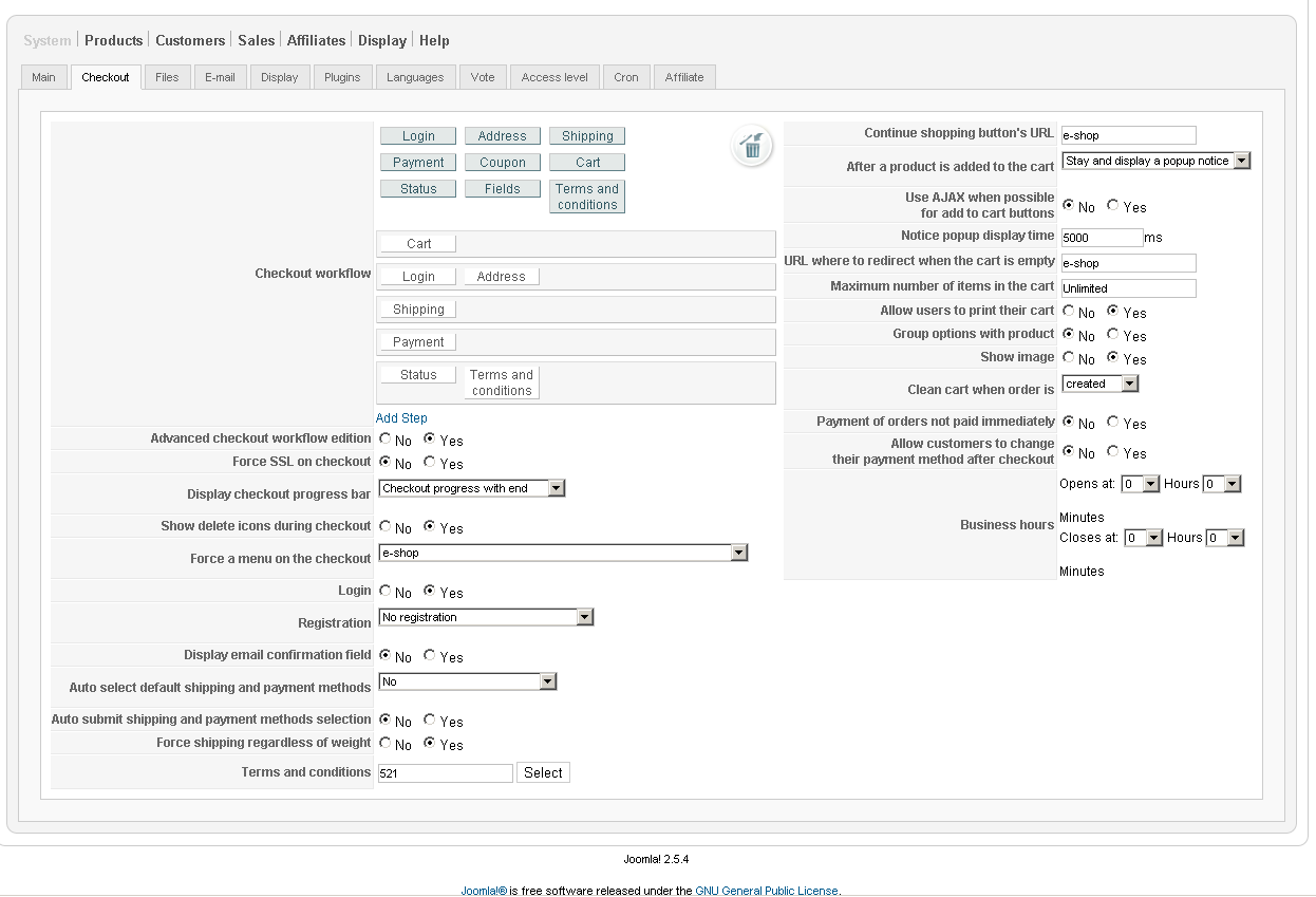

I also have a problem with shipping methods not showing. It is strange, because they show up when I am logged in, but when I use the no registration checkout method my shipping methods are empty. I am using only one zone which is the one that I use for my no registration form, not using weights for products at all and have the option force shipping regardless of weight set to "yes". What could be the problem?
Thank you

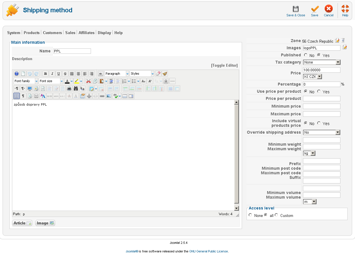

  • Posts: 86104
  • Thank you received: 14203
14 years 3 months ago #50999
Your shipping methods must not be configured properly.
Please check all the points in the FAQ:
www.hikashop.com/support/documentation/i...ual-listing.html#faq
It must be one of them.

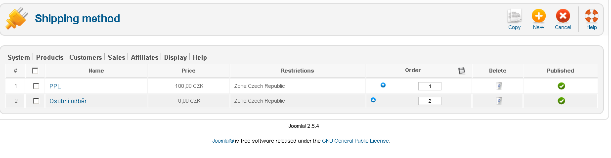

If you don't find it, please do screenshots of your shipping methods options.

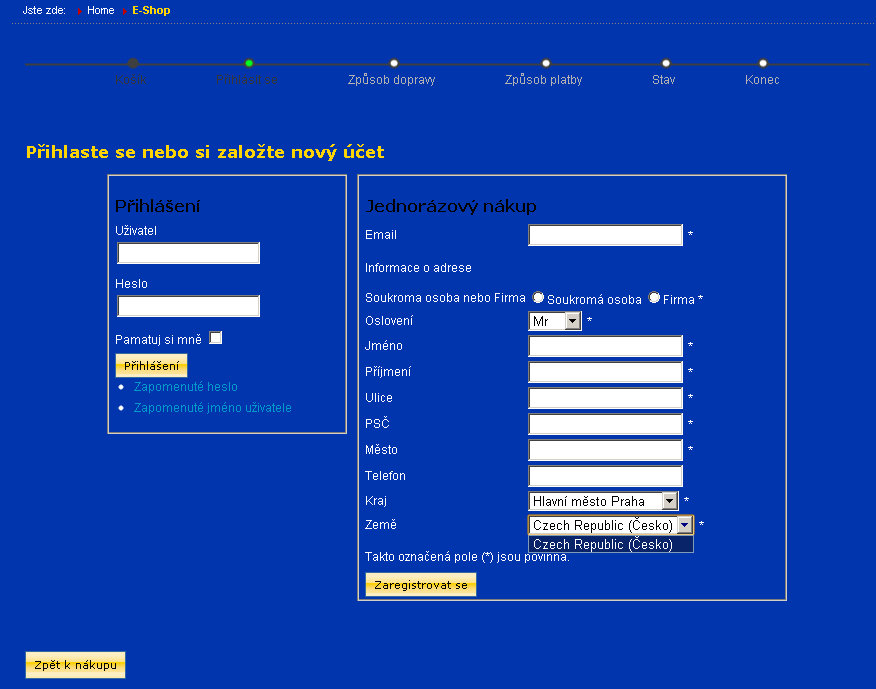

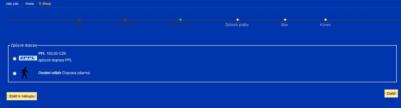

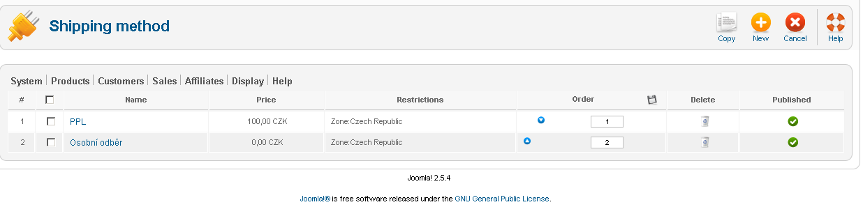

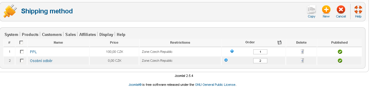

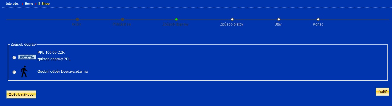

  • Posts: 25
14 years 3 months ago #51022
Still did not find my misconfiguration. When I login it shows without any problems, but when I use the no registration form it is than empty.

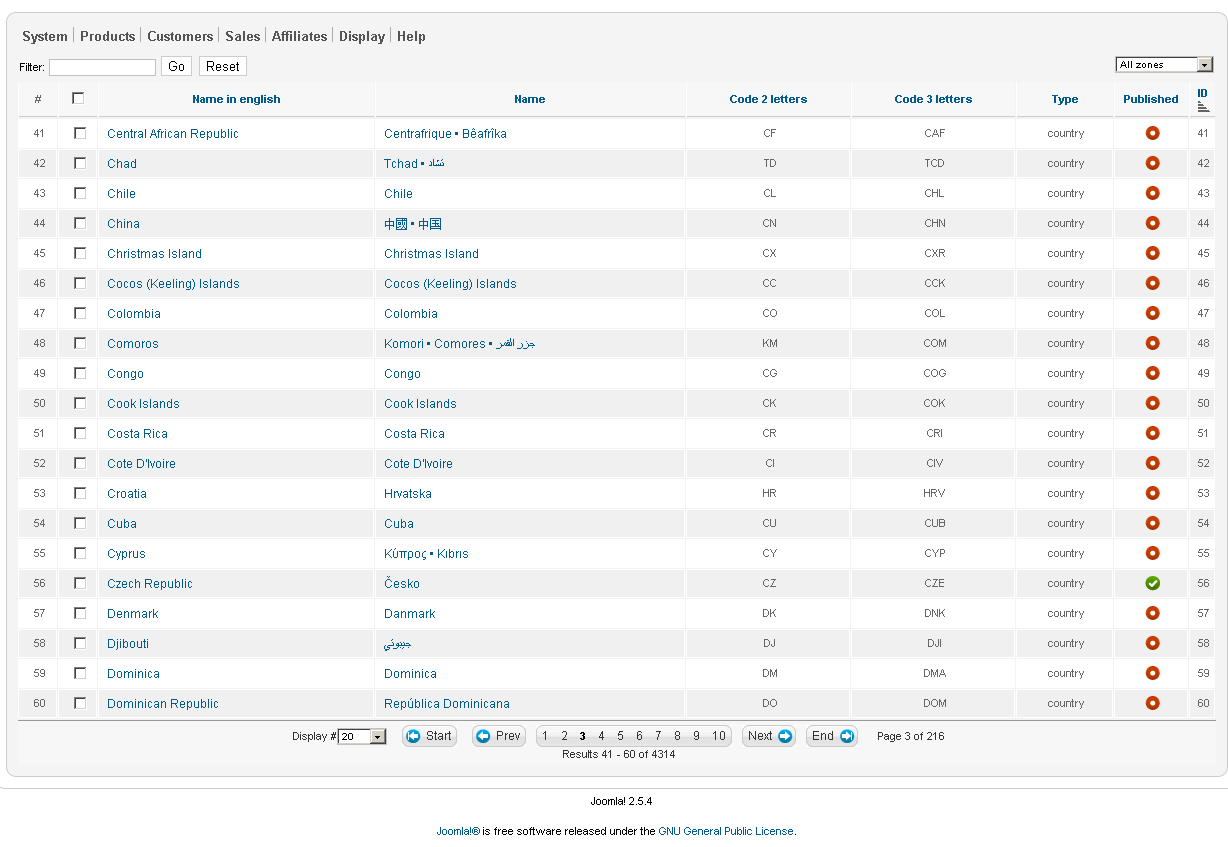

  • Posts: 86104
14 years 3 months ago #51111

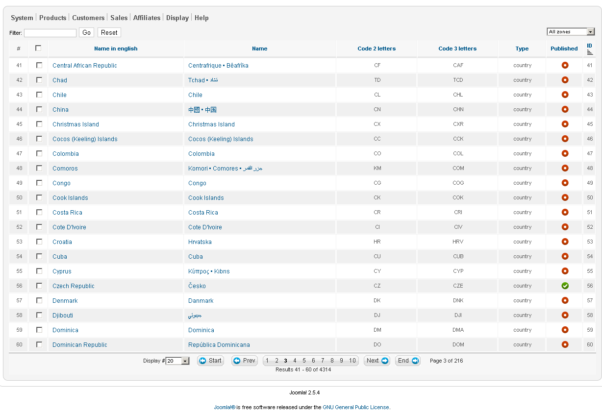

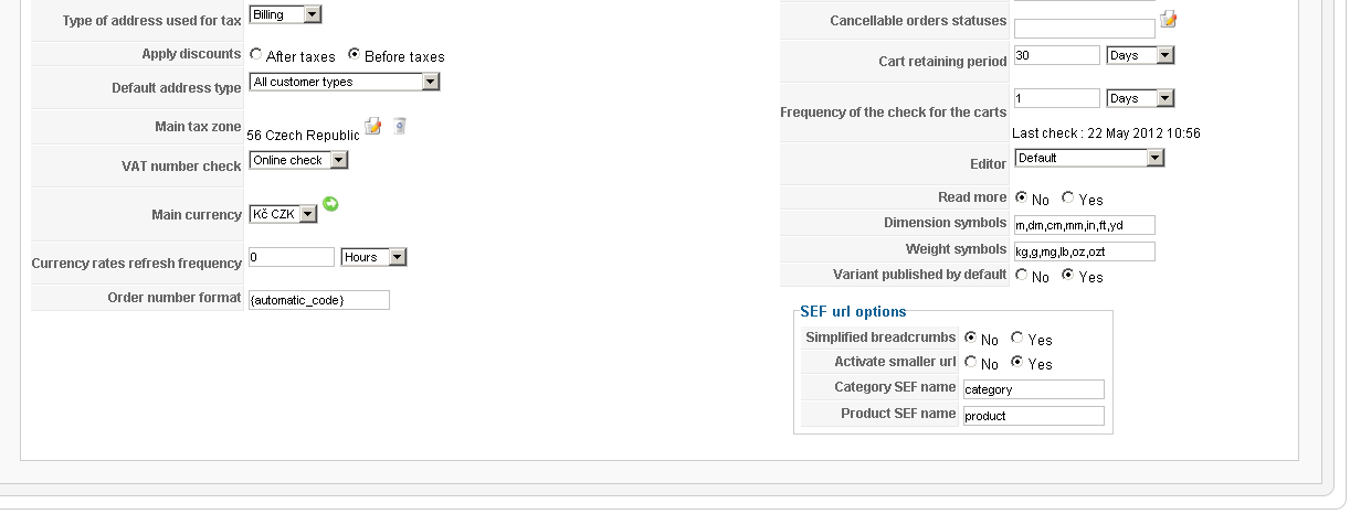

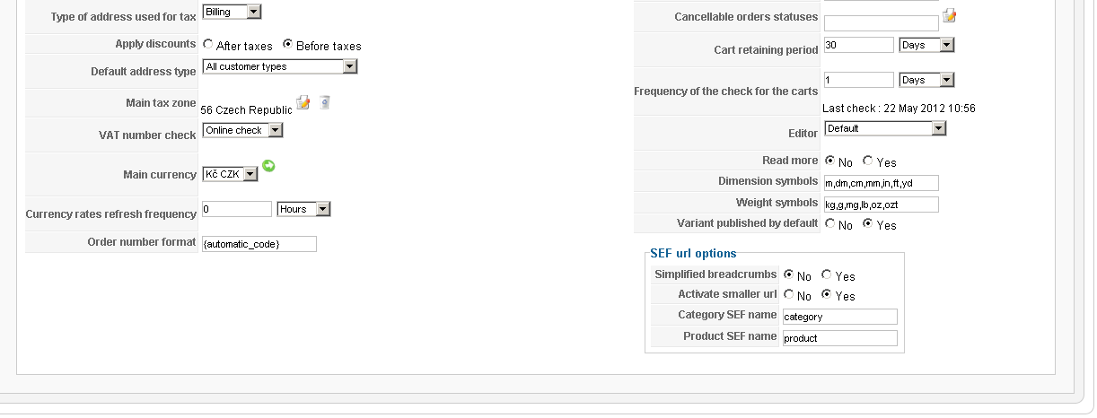

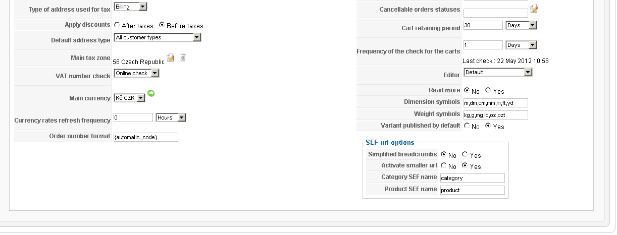

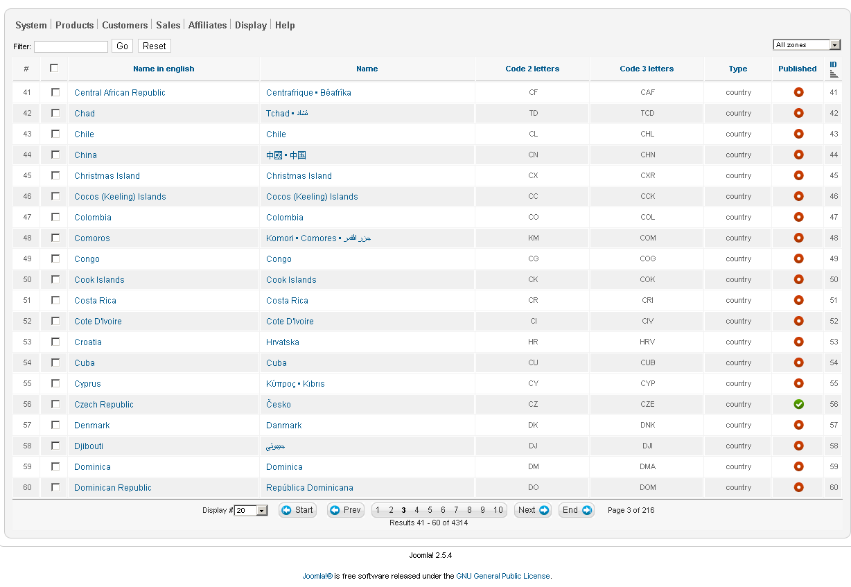

I see that you restricted your shipping methods to the czech republic. Please make sure that:
1. Your user address is in czech
2. That the "main tax zone" option of the configuration is also czech
After correcting that, logout/login and try again.

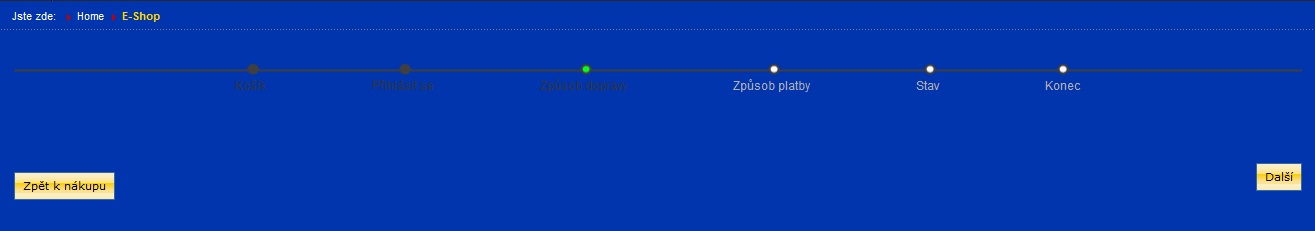

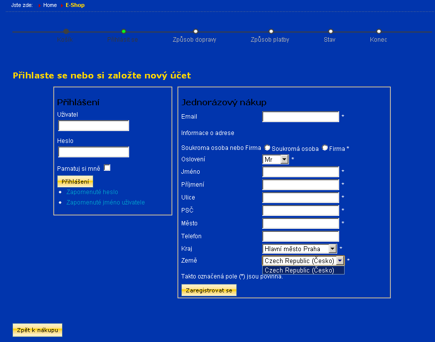

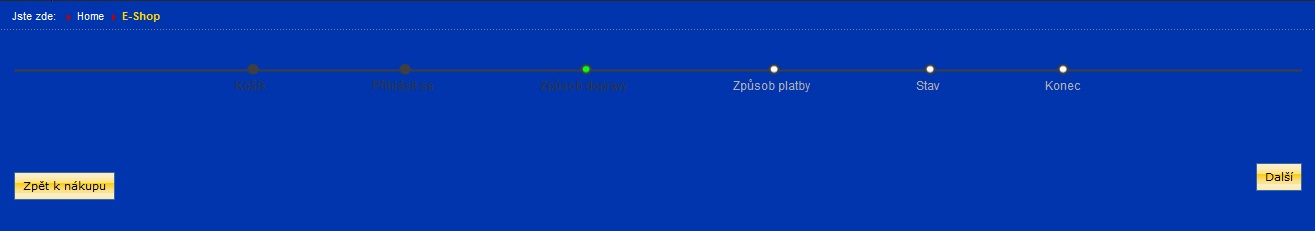

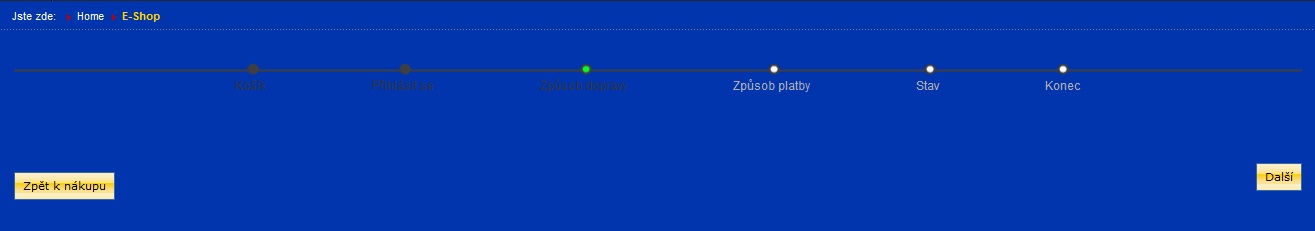

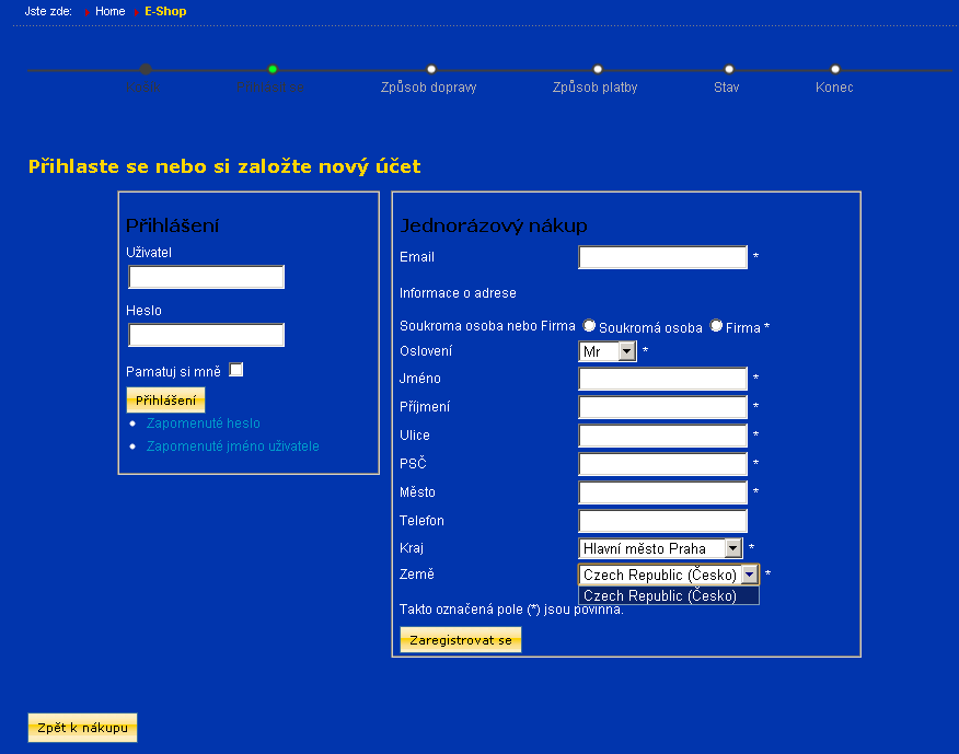

  • Posts: 25
14 years 3 months ago #51133
Again, I am using the no registration checkout method. Login/logout does not apply. See screenshot
  • Posts: 86104
14 years 3 months ago #51214
Then there must be something else.
It it's only for the "no registration" mode, maybe it's because you have some caching activated on your website ? Try to:

  • Posts: 86104

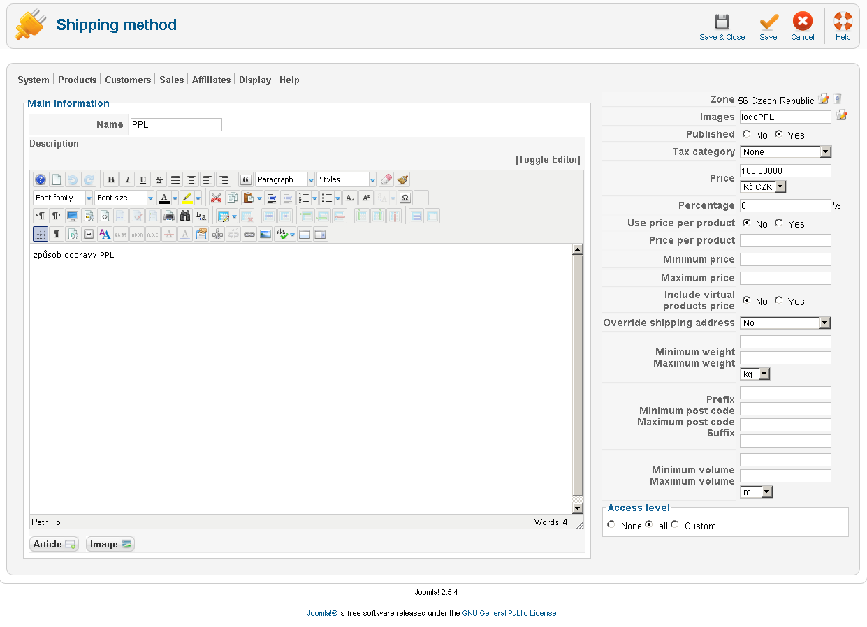

14 years 3 months ago #51733
We found the problem. You had set the access of the manual plugin to "special" instead of "public" in the joomla plugins manager...
I'll add that to the list of things which have to be checked in the FAQ ;)
