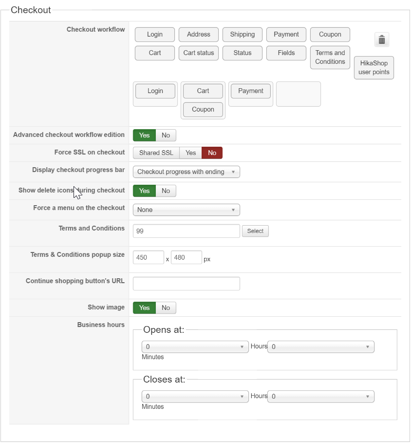

Please can you provide your Backend Checkout Configuration ?
Awaiting news from you.
  • Posts: 105
10 years 3 months ago #242472
Here it is :

Mmm, I'm thinking we were talking about different things.
It now seems that your talking about seeing the payment view twice on the checkout, and not that you see the PayPal payment method twice in the payment view (which is what we thought you were talking about).
The fact that you would have that is because you must have turned off either the "auto select payment and shipping methods" and/or the "auto submit payment and shipping methods selection" settings of the HikaShop configuration. Activate them and you won't have that.
