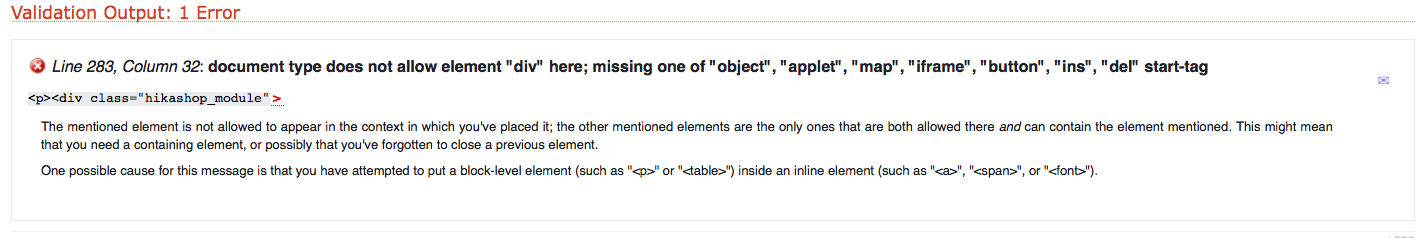

I was just checking the html validator and it found an error. I do not know where to find this to fix it?
Many thanks
Sarah
  • Posts: 85883
  • Thank you received: 14124
14 years 11 months ago #21750
That sounds like the problem comes from the place where the module is used (your template ?, a joomla article ?) which has a <p></p> tag around the modules loading tag which is not possible. The problem is not in HikaShop.
