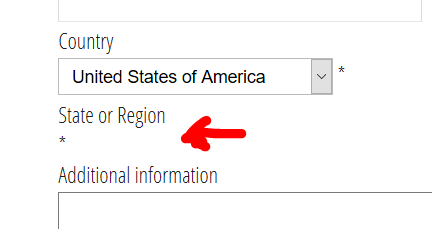

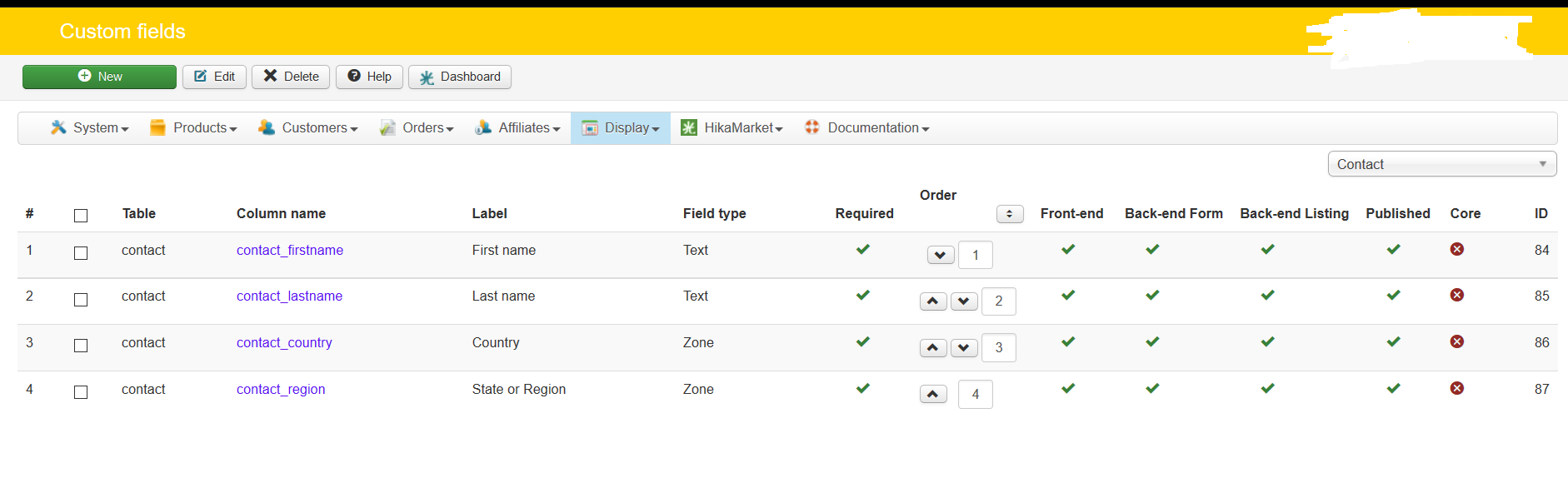

A client wants to use the "Contact us about this product" form so we can hook it into Salesforce as we have done for checkout. We've added a few custom contact fields. However, the normal interdependent behavior of the Country zone and State zones isn't working in the Contact us page.
Just like in the checkout when you choose your Country zone from the dropdown, and the State zones dynamically update to the ones valid for that Country, we want the same thing to happen in the Contact Us form page. But we've added both of those custom fields and while the country displays, the Javascript to trigger the State isn't working.

9 years 7 months ago #257367
Thanks for the quick reply. Pretty sure I'd done it that way, but with your suggestion went through and saved again cleanly in the correct order to be absolutely sure. Re-saved the Country default first (USA) and then the State with a default of Alabama.
But alas, no love in the zone. Still looks the same way - no actual dropdown shows up, just the label.
Interestingly if I turn on the option to add a "Please Select" choice to State, the field disappears entirely from the page.
To rule out a template conflict I temporarily switched over to one of the Joomla standard templates, but same result. Country shows, state doesn't.
