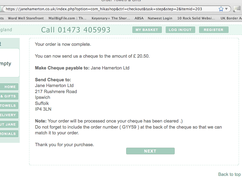

I've started a new thread, because this is a separate issue.
When I choose 'check' as a payment method, it takes me to the 'end' view, which is fine.
There is also a 'next' button, but when I click it, I get a '404 Page not found' error.
Where can I change the URL of the button to the home page, for example?

There should not be a next button on the last page of the checkout. Could you do a screenshot of that page with the URL ?

Here's the screenshot:

Strange that you have that next button. Anyway. The fix is easy. Go in the menu Display->Views and edit the file "end" of the view "checkout". There, add the line below at the end:
$this->nextButton = false;
  • Posts: 79
14 years 11 months ago #22165
All good!
