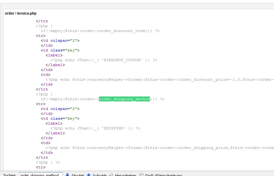

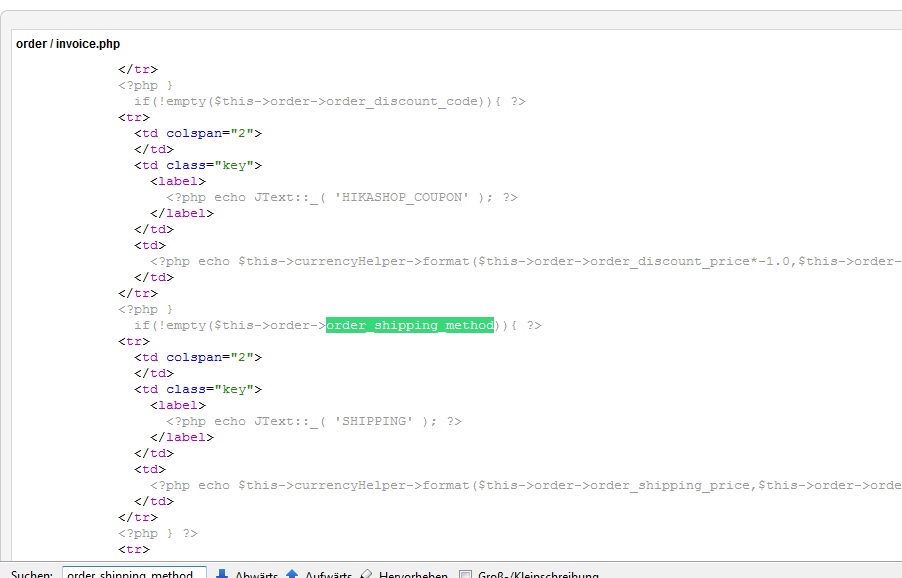

  • Posts: 18
14 years 11 months ago #22254
Thanks for your quick response.
Unfortunatly it did not solve the issue. I use the latest HikaShop but it was indeed set as you said.
I changed it as you can see in the attached image but it still did not do the trick.
Is there anything else I can try?
Best regards,
Stephan

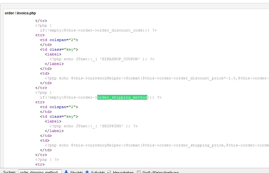

  • Posts: 18
14 years 11 months ago #22271
Yes, I am sure. It's also written on the top left corner of the image I uploaded.
Best regards,
Stephan
  • Posts: 85949
  • Thank you received: 14139
14 years 11 months ago #22272
order/invoice is written in the screenshot, yes, but not the name of the template for which you're editing it.
If you're editing it for the template "atomic" but that you're using the template "bluestork" on your back end, that won't change nothing.

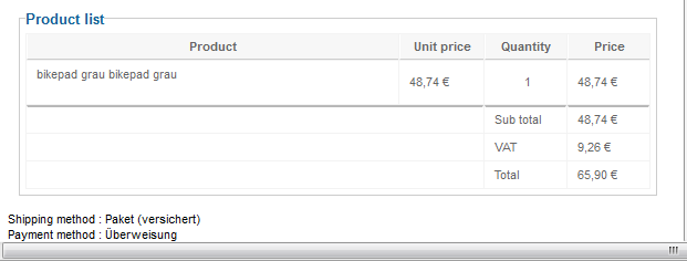

  • Posts: 18
14 years 11 months ago #22276
it's still not working. As you can see from the attached file it still does not show "shipping" in the invoice, but it does count it in the total sum.
wired.
Best regards,
Stephan
