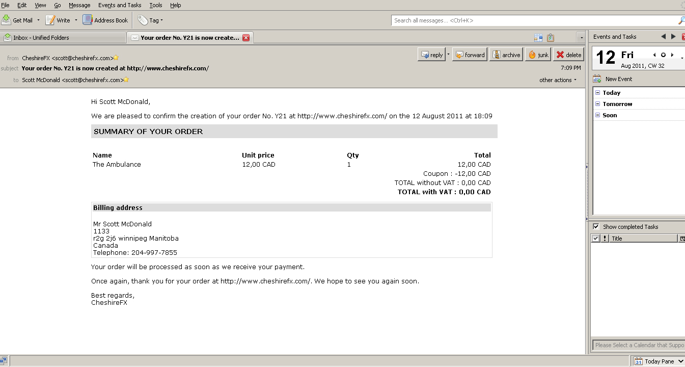

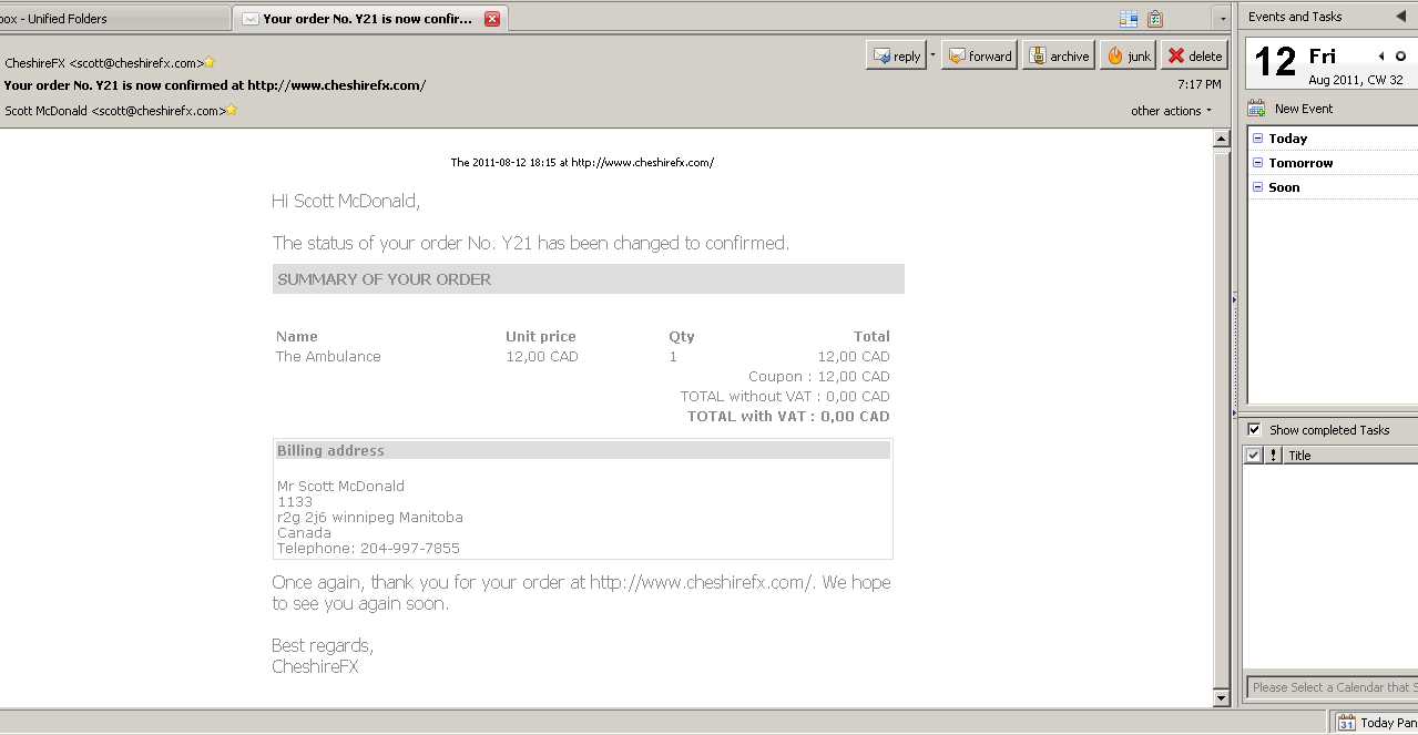

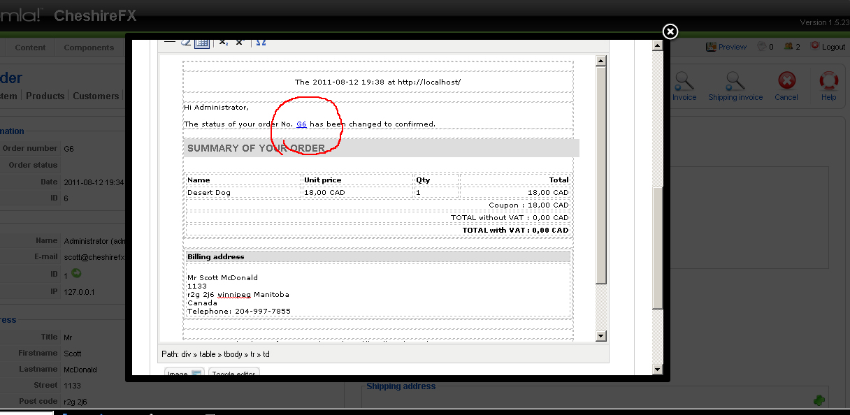

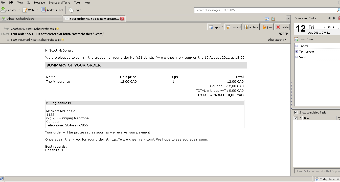

  • Posts: 11
14 years 11 months ago #23548

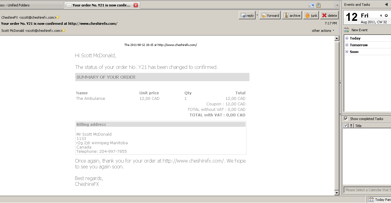

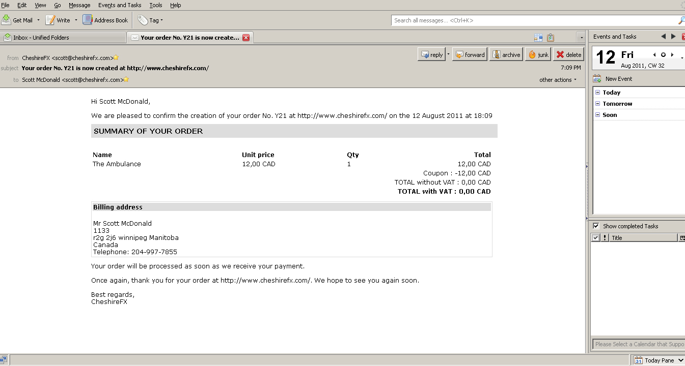

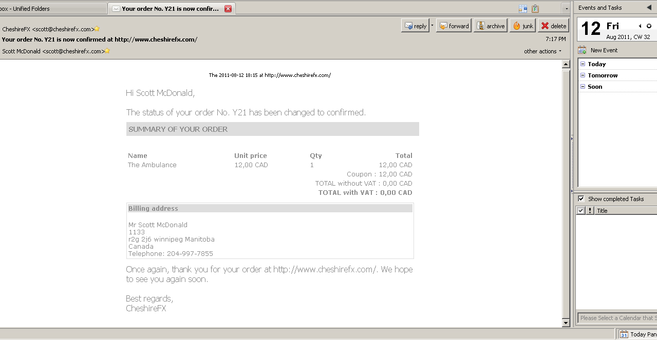

That's part of the problem, the email doesn't contain a link to the order.
I attached the first and last customer emails for you to see.
Maybe I'm missing a switch somewhere in the config

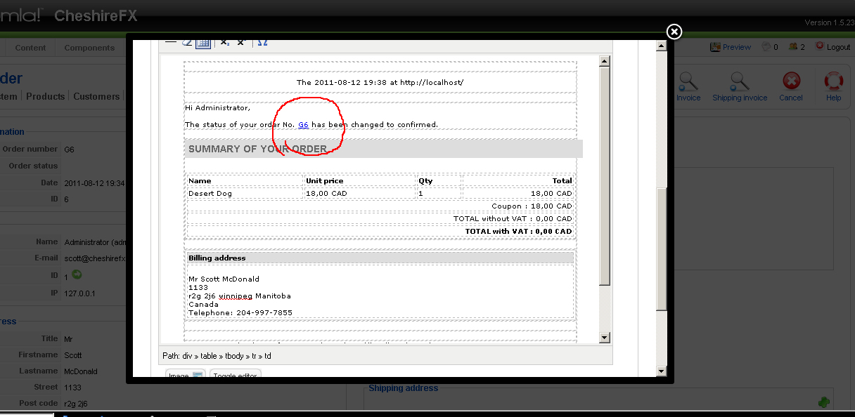

  • Posts: 11
14 years 11 months ago #23549
I have an older version of hikashop on my local server that actually works.
What could be wrong?
They are both version 1.5.3, but this local one is the Starter version...

  • Posts: 85949
  • Thank you received: 14139
14 years 11 months ago #23554
It's probably because you set the registration option of the configuration to "no registration". However, for security reasons, only logged in users can access their orders and theirs downloads. But since your users don't register, they can't login, so there is no link given to them in the email and they can't see their order on your website.
You would have to change the registration option to "simplified registration" for example in order to get the link.

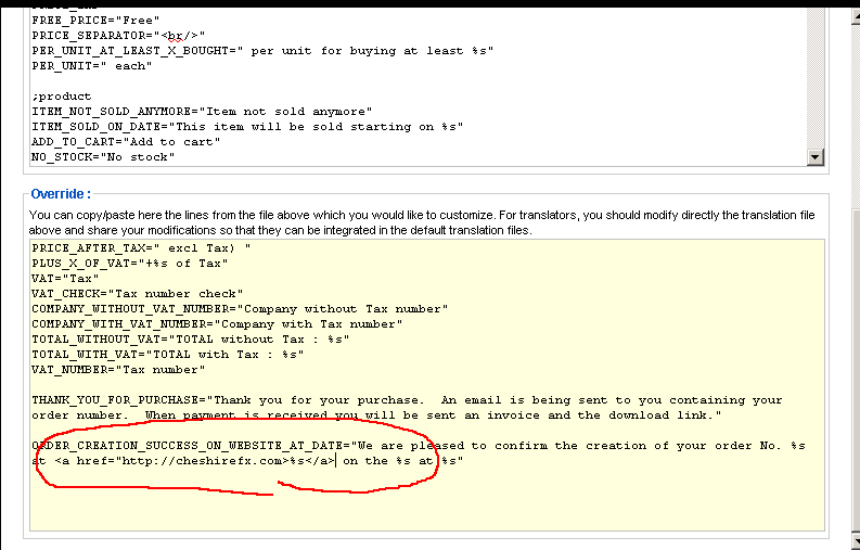

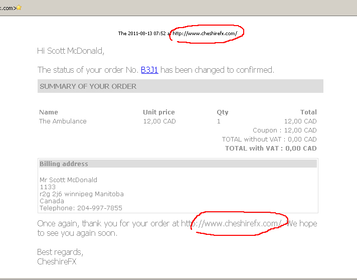

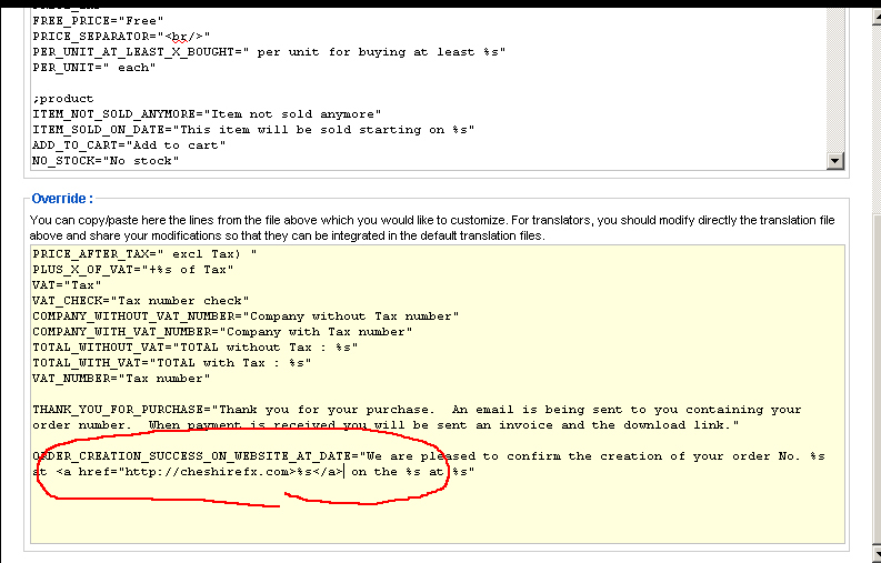

  • Posts: 11

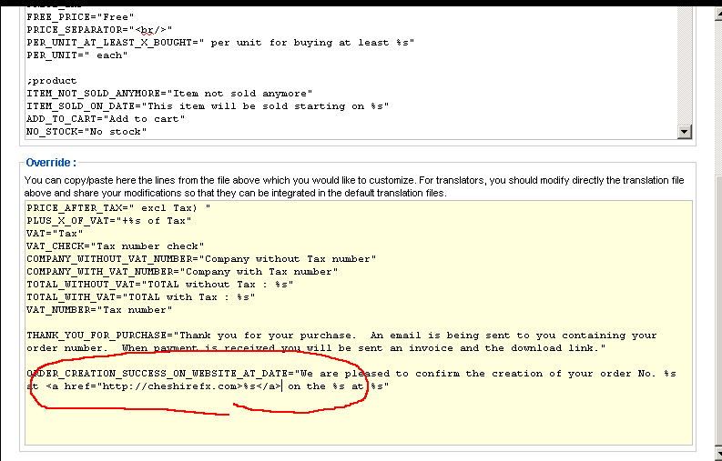

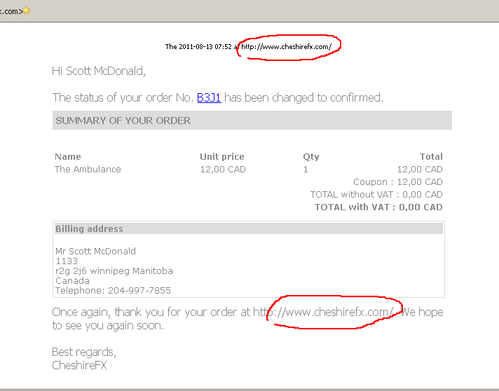

14 years 11 months ago #23582
It's not working, but am I close?
Can the variable %s be put in a link tag?
Last edit: 14 years 11 months ago by Naythan.
  • Posts: 85949
14 years 11 months ago #23587
You can put it in a link, yes.
You're close indeed.
One of the problems is that you forgot the double quote at the end of the URL in the href attribute of the translation.
The second problem is that you can't use double quotes inside translations. You need to use simple quotes instead. So instead of:
KEY="<a href="My link">My text</a>"
You should have:
KEY="<a href='My link'>My text</a>"
