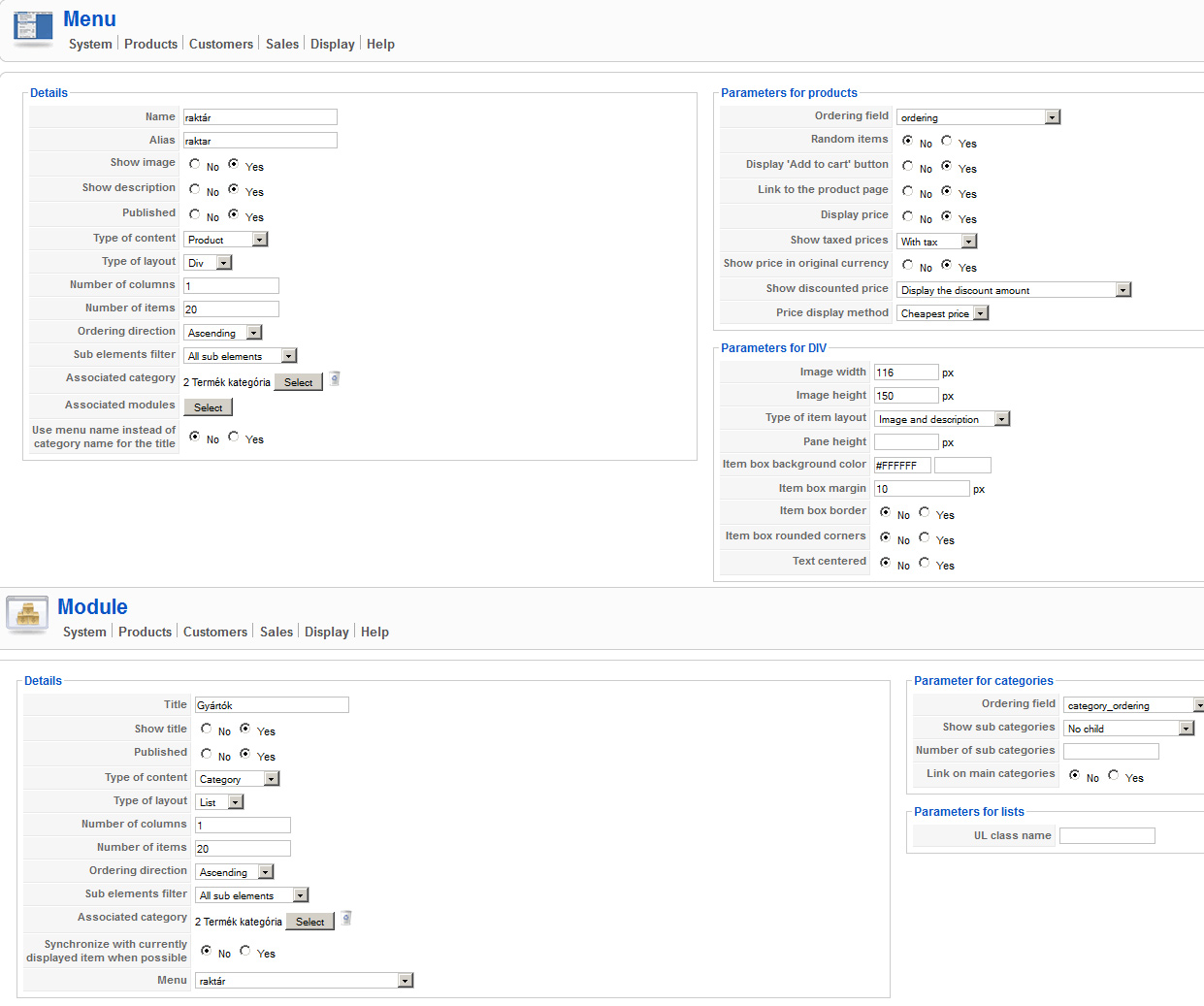

I created a menu which shows all products in a proper display. It works great.
Then I created a module which shows all the categories I have, and assigned the menu mentioned above to that module. Now if I click one of the modules element (category), the products are not listed. (Only the title appears)
How can I fix this?
Thank you.
  • Posts: 85952
  • Thank you received: 14141
14 years 11 months ago #23699
You need to set a category listing menu in the menu option of your module and not a products listing menu.
