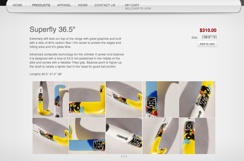

for anyone out there that is trying to do something similar, here is the final code:
How to add simple image gallery to the hikashop product page:
Code:
<div id="sigpro_hikashop_div">
<?php
$gallery = "{gallery}";
$endgallery = "{/gallery}";
if(!empty($this->element->main->product_name)){
$name = $this->element->main->product_name;
}else{
$name = $this->element->product_name;
$imgfolder = str_replace(" ","_",$name);
<?php echo JHTML::_('content.prepare', $gallery.$imgfolder.$endgallery);?>
</div>
to implement:
1. install simple image gallery pro from the JED and set the image folder to something like: images/stories/products
2. place the above code whereever you would like on your product view page (com_hikashop/views/product/tmpl/show.php)
3. within images/stories/products (or whereever your image path is set) create a folder for each product with the name of the product (replacing any spaces in the product name with underscores)
4. the images will be displayed by sigpro right within the hikashop product page
this gives you much more flexibility with how the images are displayed by using the options in the sigpro plugin parameters, and your lightbox popup will have a nice slideshow.
ive attached a pic of my final product page for example.
enjoy!
