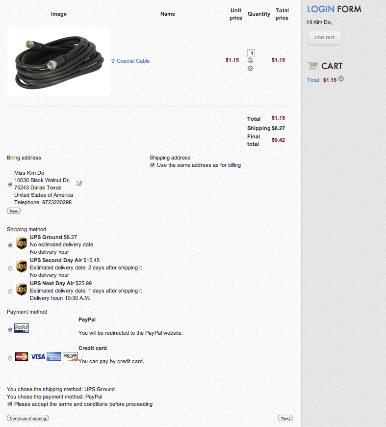

After exhausting the forum, I still can't figure out why I am not being redirected to PayPal in my checkout process.
I have my UPS shipping method set up, PayPal payment plugin set up. They both appear just fine, but every time I choose those options and click "Next," I'm taken right back to the same page.
This also happens if I choose to pay with Credit Card. I'm taken back to the same page.
There are no error messages. Attached is an image of the check out page I'm stuck on.
Any help would be appreciated. Thank you!
Last edit: 14 years 7 months ago by tsmith.
  • Posts: 85883
  • Thank you received: 14124
14 years 7 months ago #30729
First, you should look at your template to make sure that it handles joomla messages:
www.hikashop.com/en/support/documentatio...tibility-issues.html
Then, you might have an error message explaining the problem.
Otherwise, you can activate the debug mode of the joomla configuration and try again. That might also help in displaying an error message of the problem.
  • Posts: 13
14 years 7 months ago #30735
I turned on the debug and now when I go to the checkout page, I get this message:
Fatal error: Allowed memory size of 16777216 bytes exhausted (tried to allocate 311296 bytes) in /data/www/celabs/components/com_hikashop/views/product/view.html.php on line 365
  • Posts: 85883
14 years 7 months ago #30751
You should increase your PHP memory_limit setting from 16M to 32M and that should solve the problem.
If you don't know how to do that, you should ask your hosting company support.

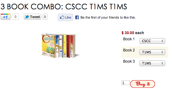

I have a similar problem with memory and I changed my memory in my ini file but it did not fix the problem. At first I got the fatal error similar to tsmith but now I have this error:
Maximum execution time of 30 seconds exceeded in .... components/com_hikashop/views/product/view.html.php on line 1025
This is the case, I have a 3 book combo deal and a five book combo deal. The 3 book combo page works just fine. There are 3 drop downs to select which books you want. When I try to add more than 3 drop down for the 5 book combo, I get the error basically because the page takes too long to load I am guessing. I don't see why 5 drop down menus would be so memory intensive. Her is the sample of the 3 book combo:
theuncommonlife.com/store/books-a-guides...t/15595-3-book-combo (the page loads kind of slow.
and here is the 5 book combo that will not load at all.
theuncommonlife.com/store/books-a-guides...t/15813-5-book-combo
I am hoping you have a suggestion as what to do or why it does this. Your help is much appreciated as always, you are great! I currently have memory_limit set to 128mb according to my joomla 1.7 system information which seems like over kill. Maybe there is a better way to create selections for the product that I do not know about or a way to make the page load faster. Thank you in advance.
Last edit: 14 years 4 months ago by jessicapschultz.
  • Posts: 85883
14 years 4 months ago #41732
That's because you're using characteristics where you should instead use custom item fields.
Characteristics will create one variant for each combination of values of the characteristics.
Suppose that you have 10 choices per characteristic. With 5 characteristics, you will get 100000 variants for just one product. That's WAY too much for any server.
Characteristics can be used when you need to handle prices or stock per variant of the product and thus you NEED variants of the product for that and usually you'll have less than 100 variants for a product.
Custom item fields can be configured via the menu Display->custom fields in the business edition:
www.hikashop.com/en/support/documentatio...p-field-listing.html
  • Posts: 29
14 years 4 months ago #41736
Ok, I am still new to hika, first time. Which table do I use to create these custom item fields, product, item? Multiple drop down or what? :blink:
t
  • Posts: 85883
14 years 4 months ago #41738
It's the table "item".
The type is whatever you want. If you want radio buttons you can use radio, if you want a dropdown, you can use single dropdown, etc.
  • Posts: 29
14 years 4 months ago #41742
OK and can I give you a scenario? I am trying to wrap my head around this, maybe you could give me a head start....
I have 6 books to choose from and the customer and pick any 5 they want even if they want 3 of the same book and 2 of another book. How would I set this up?
  • Posts: 85883
14 years 4 months ago #41883
I would create 5 custom fields of the table "item" and the type "single dropdown" with the 6 books as options of the dropdown.

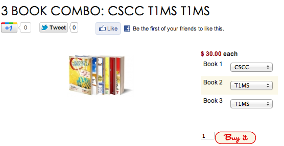

  • Posts: 29
14 years 4 months ago #43463
Couple if things.... first, thank you for always responding quickly, I really appreciate it and it makes me glad that I purchased your product knowing you are always willing to help.
second, I implemented the 5 custom fields just fine but now there is another issue. When you click the buy now button, and the popup comes up with the button to continue to cart, it takes you to the cart instead of making you go to the product page to make a selection of the 5 books. How can I change this so that the buy button takes you to the product page? Before when I tried to use variables, it did force the user to the product page to make a selection.
  • Posts: 85883
14 years 3 months ago #43658
If you're using custom fields, you will either need to display the custom fields directly on the listing of your products ( there is an option to activate that in your products listing menu/module's hikashop options), or deactivate the add to cart buttons on the listing so that they have to click on the product image/name to access the product (same screen a for the other option).
