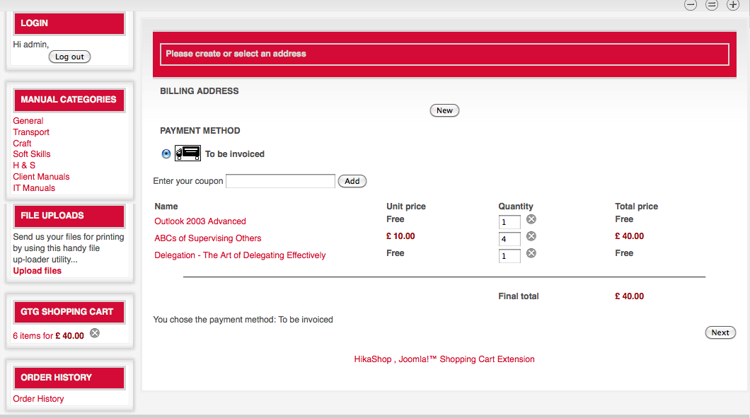

2) My other problem is that I'd like to have a VAT entry above the Final Total on the checkout page. I feel certain that it's on the Cart under display>views, but I don't know what code to enter.

2. It will display once the taxes will be applied to the prices of your products.

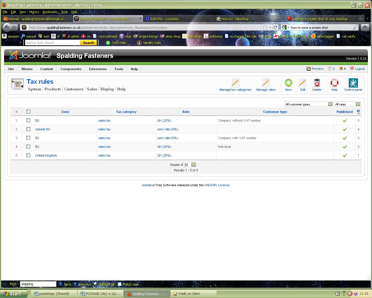

I'm in the UK, so I've attached a screenshot of what I've set up
now for some reason, when I try to do a practice order from an EU country from an individual or company without a vat number, the VAT always comes up as 0%, even though it should be 20% (only eu comps with vat number should get 0%). have i set something up wrong? I've looked at my zones and they seem fine.....

You don't need the zero rate rules. If not tax rule matches the situation, no tax will be applied.
Other than that your rules seems fine.
Why didn't you use the default Europe tax zone which already exists by default in HikaShop? I see that yours is called EU. Did you set all the european country zones as subzones of that zone ? That might explain the problem.

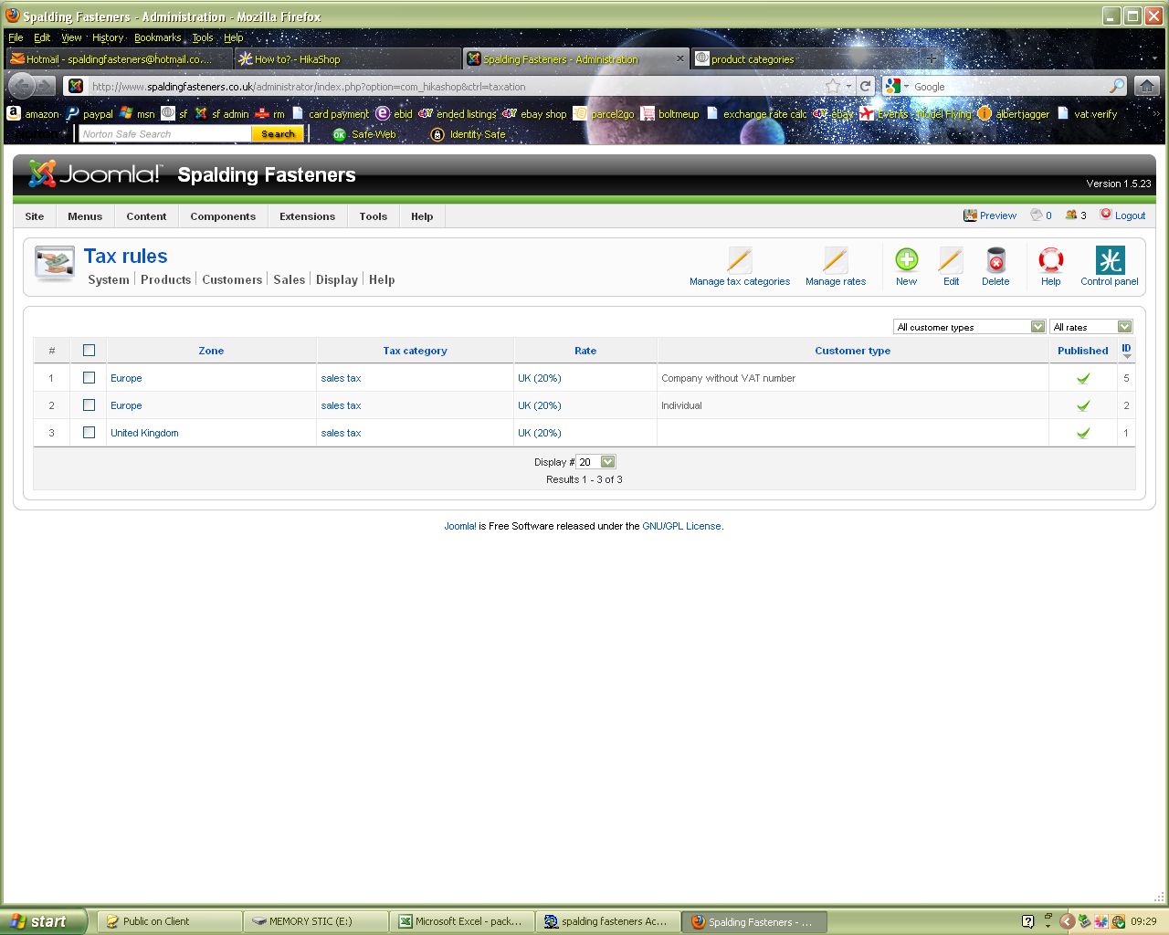

I've attached a pic of tax rules again. still not sure what I'm doing wrong....any more ideas?

I can see that it now works for companies without a VAT number, so you're almost there.
What did you put in the "Default address type" option of the config ? By default, it's "individual" and it should be left like that.

ok I've changed the default customer type back to individual and its working fine now - thanks very much for your help.
