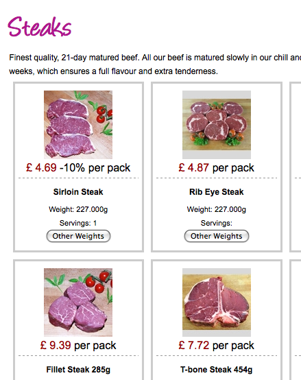

These all worked except point three for removing the decimal point…
I changed the following (which sits around line 85) to the following, but it's still showing 227.000g
</span><br />
<?php if(isset(round($this->element->product_weight,X)) && bccomp(round($this->element->product_weight,X),0,3)){ ?>
<span id="hikashop_product_weight_main" class="hikashop_product_weight_main">
<?php echo JText::_('PRODUCT_WEIGHT').': '.rtrim(round($this->element->product_weight,X),',.0').' '.JText::_(round($this->element->product_weight,X)_unit); ?><br />
</span>
<?php
I changed them in show.php for both my templates - see attached.
Any ideas?
Darren
  • Posts: 86180
14 years 11 months ago #25797
The show file is for the product page, not products listings. Your screenshot is a the products listing.
You need to use round($this->row->product_weight,0) in your listing_img_title file
  • Posts: 88
14 years 11 months ago #25799
Great! Thanks for your help today!
