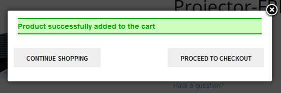

15 years 9 months ago #2584
I would like to modify the look of the "Product successfully added to the cart" popup. The look of it doesn't fit into my template very well and I would really like to get rid of that horizontal scroll that appears at the bottom.
Thanks for any insights :)

You can change the code which generates it in the file administrator/components/com_hikashop/helpers/cart.php in the function getJS
Beware that any modification of that file will be erased when you update HikaShop. As much as possible, you should try to tweak it using CSS modifications.
The size of the popup is defined twice (one for mootools 1.1 and one for mootools 1.2) with that code:
size: {x: 480, y: 120}

If anyone else is reading, I managed to tidy this popup up nicely with just CSS:
These 2 style declarations will fix the horizontal scroll and tidy up the button positioning.
#hikashop_add_to_cart_continue_div{
	float:left;
	margin: 0 20px 0 110px;
#hikashop_add_to_cart_checkout_div{
	float:left;
You can modify the error message color too here:
#hikashop_notice_box_message div.hikashop_success{
	background-color:#427060;
	border-bottom-color: #182E32;
	border-top-color: #182E32;
	color: #FFF;

Thanks for the reply nicolas. The chrome css inspector doesn't seem to show the popup details for me? Can you tell me what the names of the buttons are so I can search for them in the hikashop.css file please.
  • Posts: 86102
  • Thank you received: 14203
10 years 6 months ago #231450
Here is a screenshot with all the HTML of the elements in the add to cart notice popup:
take.ms/Ugz85

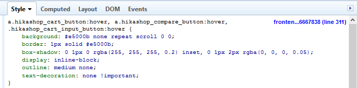

  • Posts: 101
  • Thank you received: 8
10 years 6 months ago #231520
@serbofleconcepts
I think you find it arround line 311 in the frontend.css file

OK, I disabled the pop notice for a while but now I want to add it back, so I'm back on the case with this. I've tried changing a lot of fields in the hikashop.css file (I'd prefer to edit this file via FTP as it allows me to store backups of different versions).
All I'm trying to do it to change the current red background (on hover) on the 2 lower fields to blue (#ccc)
This is the part of the hikashop.css file I've been editing;
I added the background-colour css - is this correct as it's not working for me.
  • Posts: 86102
9 years 10 months ago #252478
The CSS of the buttons usually comes from the Joomla template.
So it might be something to change in the template.
Could you provide a link to that page ?

Just buy any product on leconcepts.com and the popup will appear.
Thank you.
9 years 10 months ago #252652
Note that we won't be able to correctly check your popup code if you don't increase the value of the "Notice popup display time" option via "Hikashop->System->Configuration->Main".
  • Posts: 158
  • Thank you received: 5
9 years 10 months ago #252763
OK, I have extended the poup time to 13s.
Thank you.
  • Posts: 86102
9 years 10 months ago #252770
As expected, the red color on the buttons when you hover on them comes from the file www.leconcepts.com/templates/gk_storefro...s/hikashop_frame.css of your template.
I would suggest to contact your template provider so that they can provide their recommended solution to change that color.
